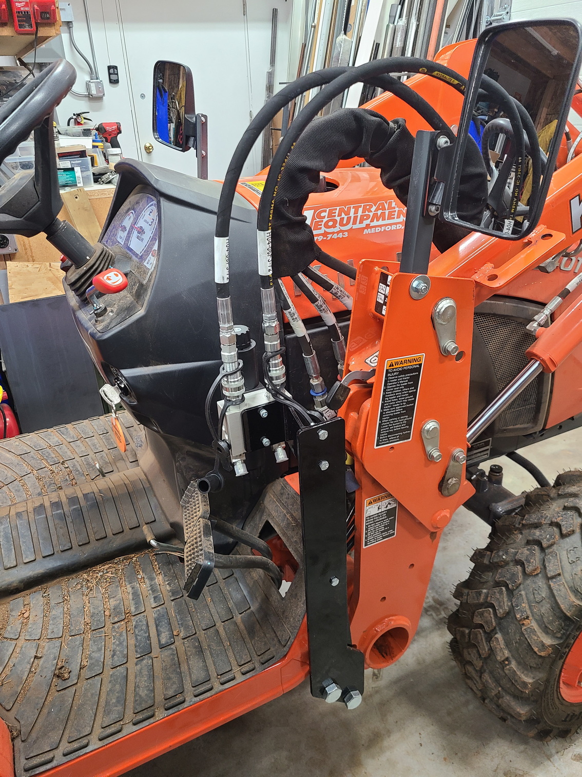

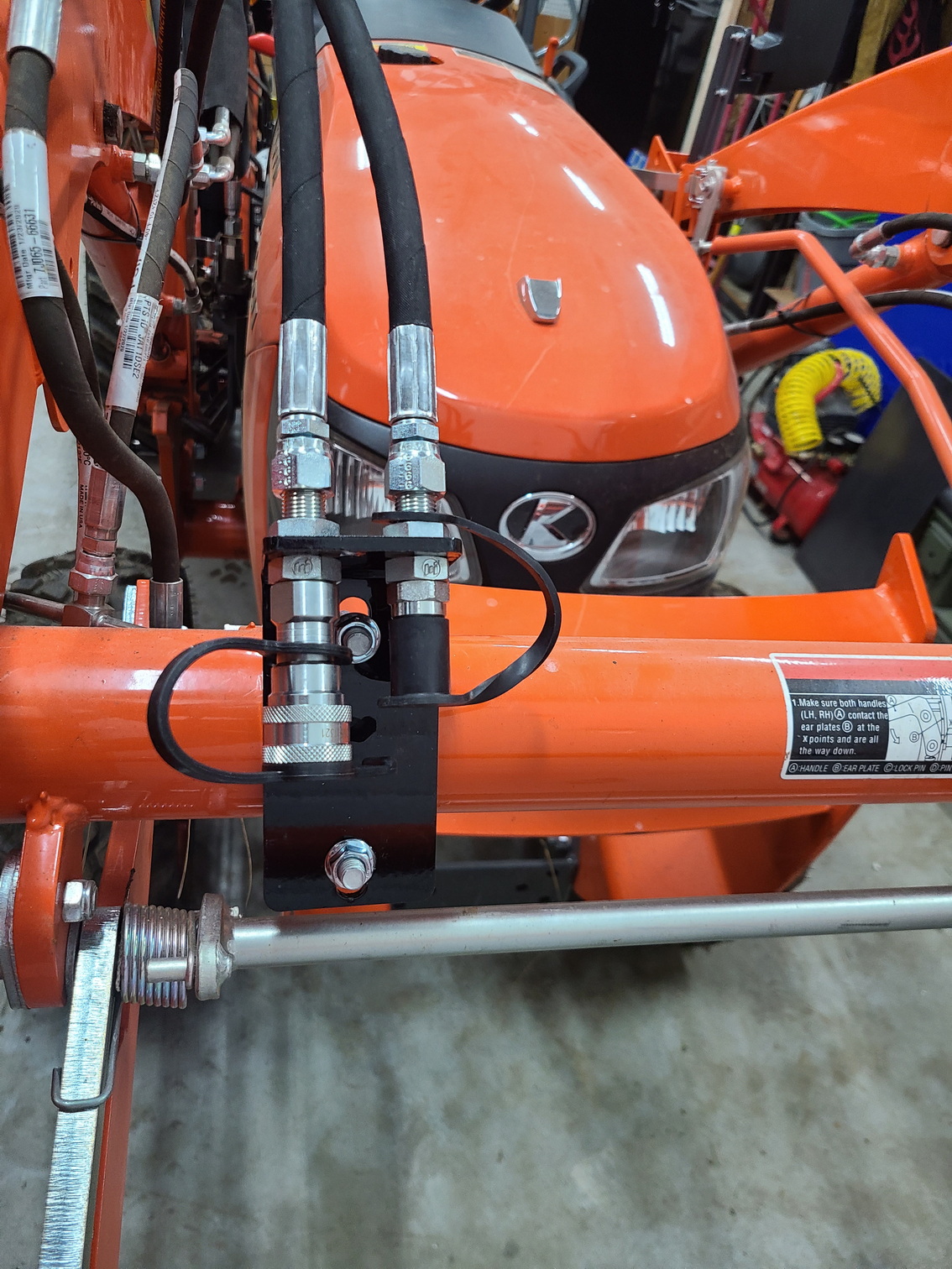

The loader valve is the same between the B2401 & B2601 so the supply line and fitting from the PB port will fit if just plumbing for the third function. The tank port on the case is different. The B2601 tank port is on top of the case whereas it is on the side on the B2401. The banjo bolts also have different part numbers so it is unlikely the fittings supplied will work. I have not removed anything yet to verify but I did order a replacement banjo bolt to measure. I am hoping if the fitting I have don't fit at least the thread on the case is a standard SAE.

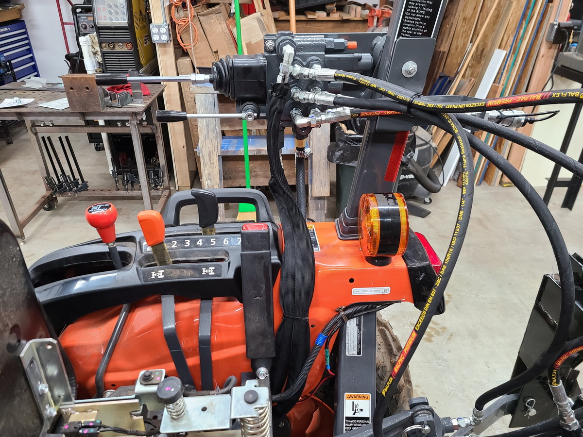

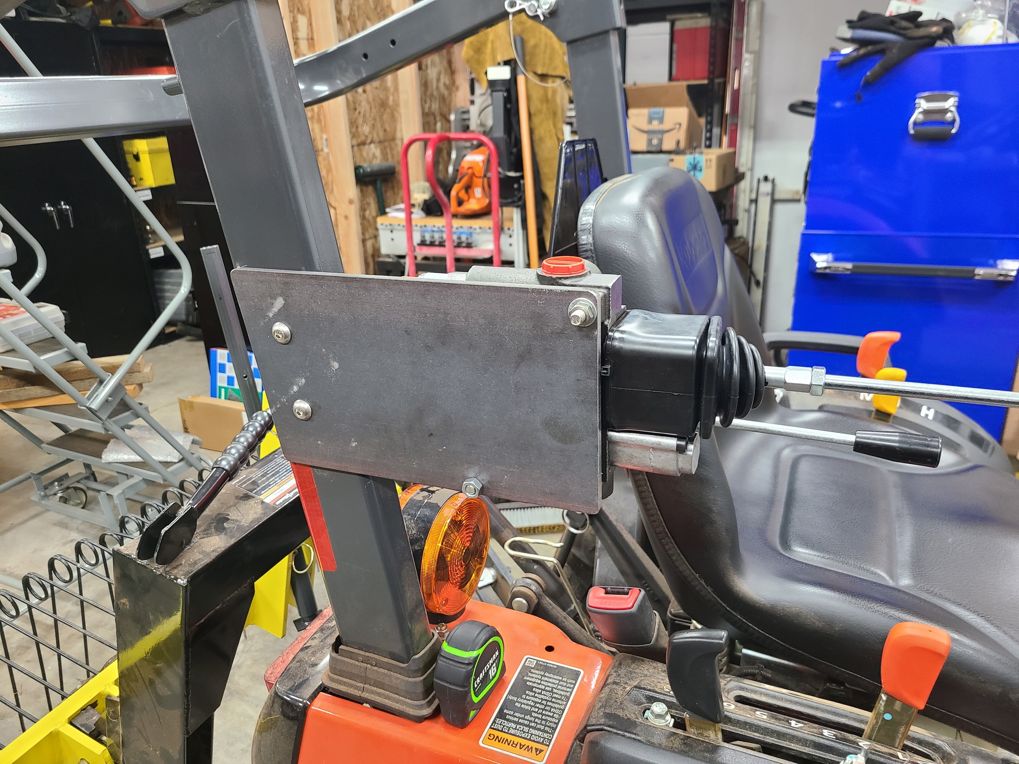

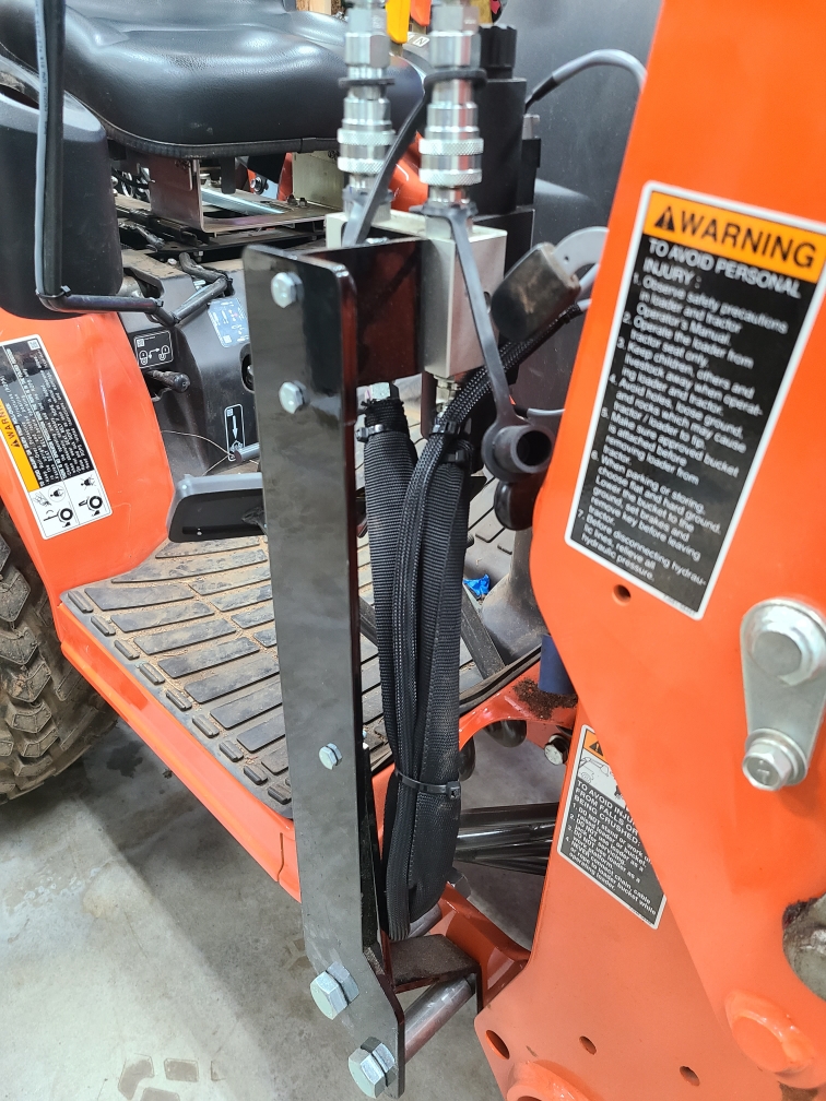

For the top & tilt and rear remote I will be using a 3 spool valve mounted on the ROPS. This is the current mounting position. In this position the lavers are in a comfortable place and do not interfere with the 3-point lift lever.

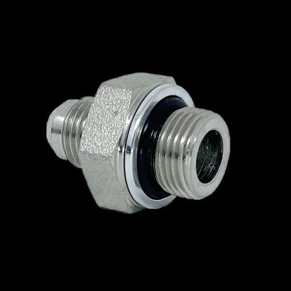

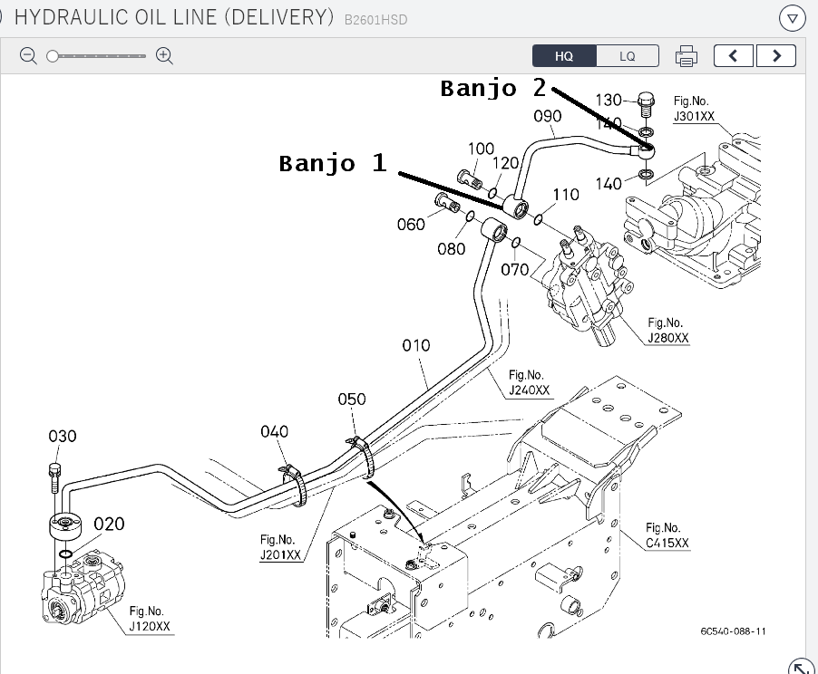

You wont find SAE threads on those banjo bolts. They will be BSPP or (much less likely) metric. Either way they are standard hydraulic fittings you can purchase from a hydraulic supply house.
Making an adaptor for the tank return should be easy. I made a much more complicated one for mounting 3rd party remotes on an L3901.

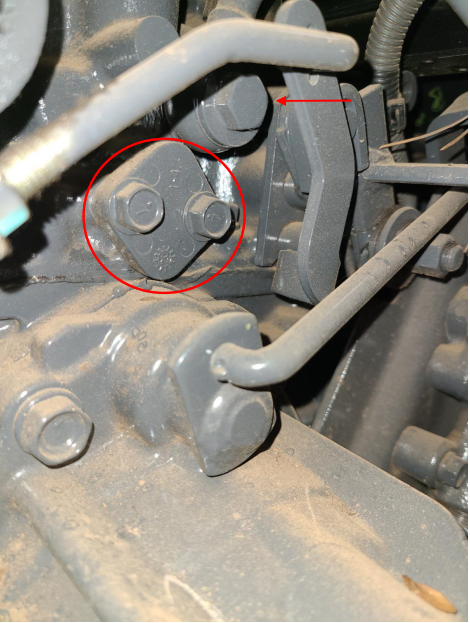

I need to make a correction to my first post. I was calling the inlet to the 3-point hydraulics the tank port. That is not correct. The Power Beyond port from the loader valve goes to the 3-point hydraulics.
The tank inlet is on the side of the transmission.

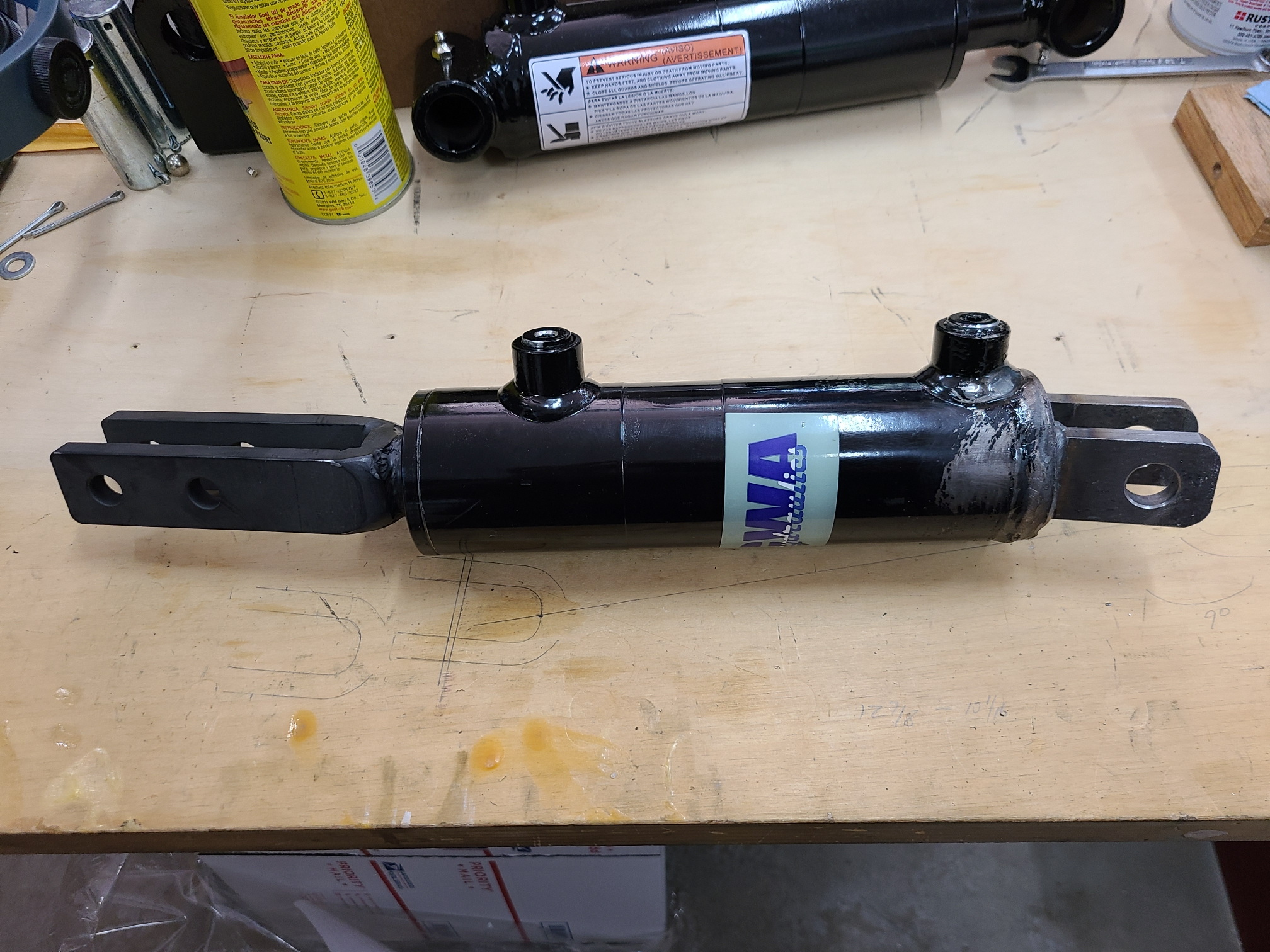

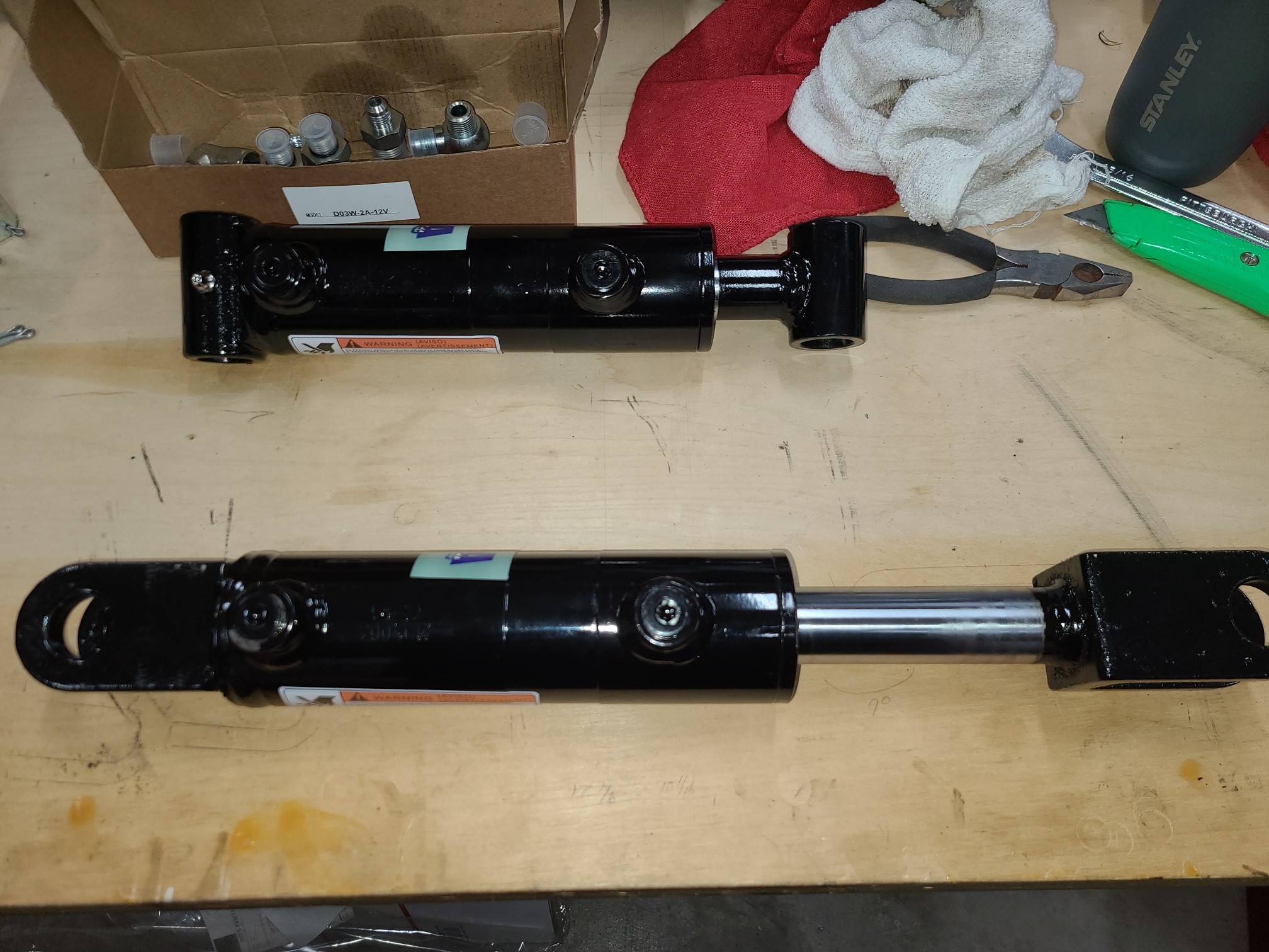

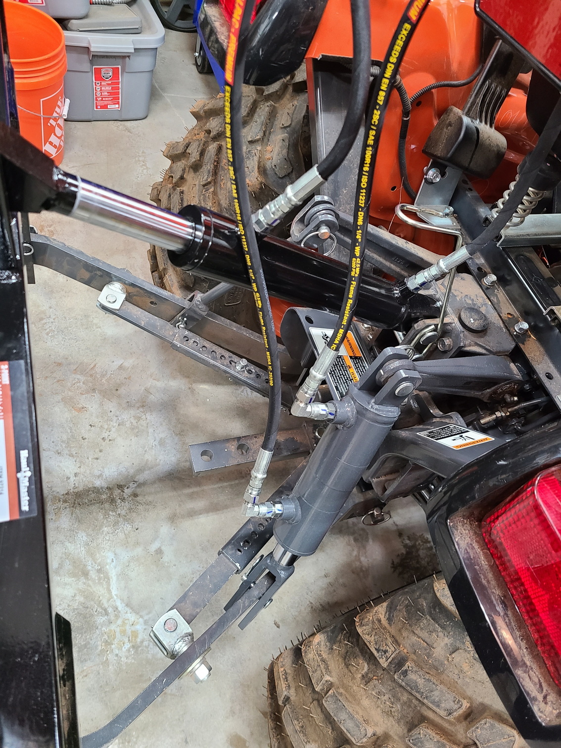

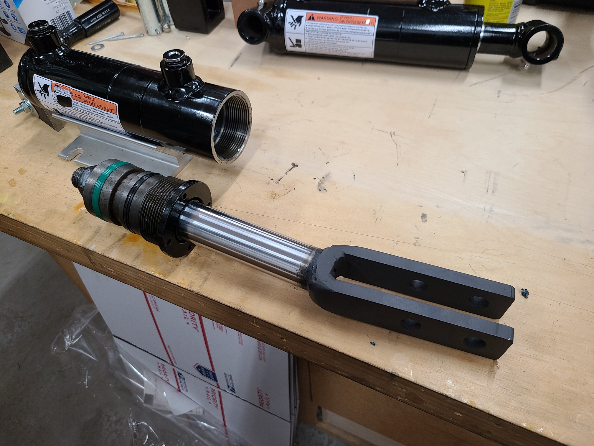

Here is the modified Tilt Cylinder. I used a 2" x 4" stroke welded clevis cylinder.
The side link has about 3-1/2" of adjustment. The modified cylinder is about 3/8" longer than the side link when both are fully retracted.

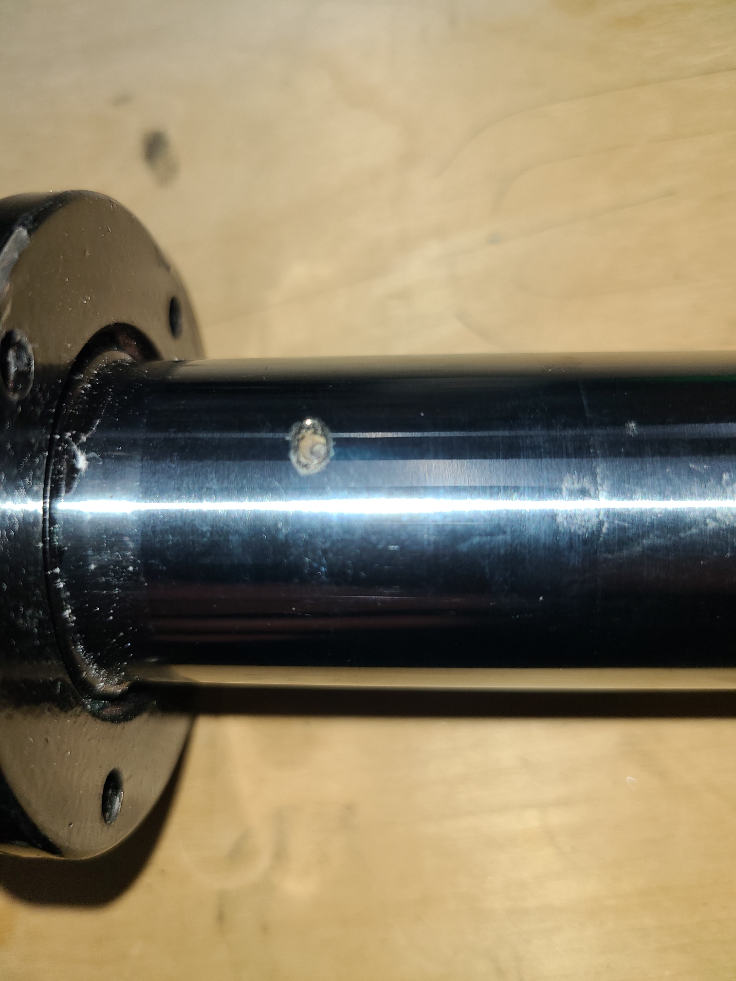

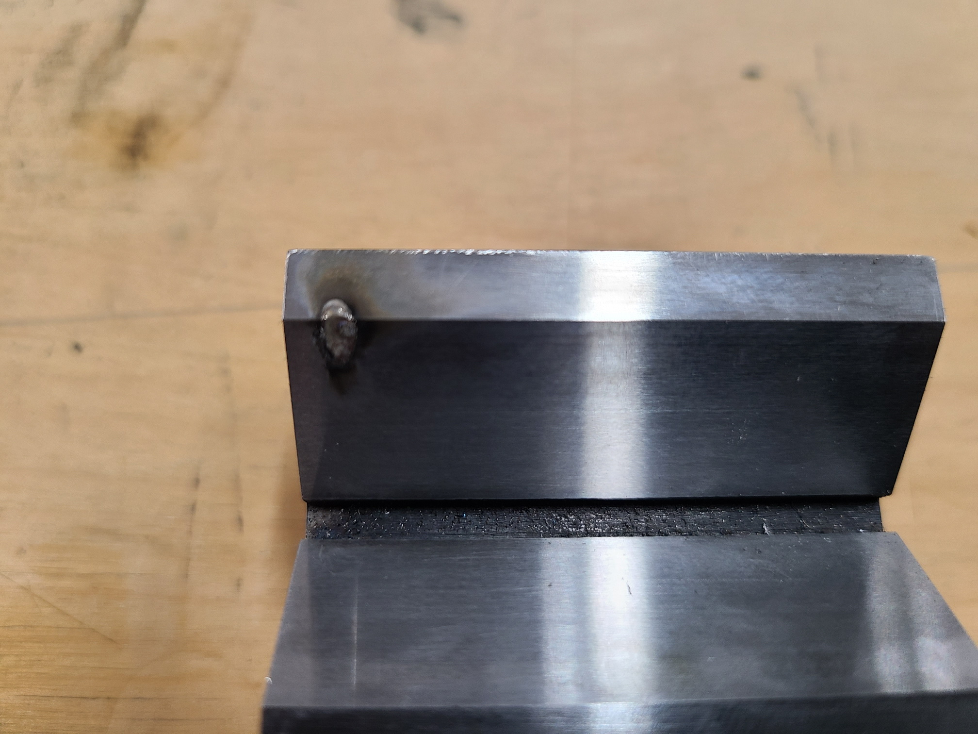

I had a screwup when doing the final weld on the shaft. I was in the middle of the setup when I got a phone call. When I went back to do the weld I had not reattached the welder ground clamp directly to the clevis, it was still clamped to the welding table. I had taped the shaft to protect it from splatter and it was clamped into a v-block. A small gap in the tape allowed an arc from the shaft to the v-block making a pit in the shaft and the v-block. I was not pleased with myself.

For now I used a hard stone to remove any raised areas around the pit and filled it with some Devcon 10210. We will see how that holds up.
Where did you get the replacement clevis ? That would be an interesting DIY bending job......

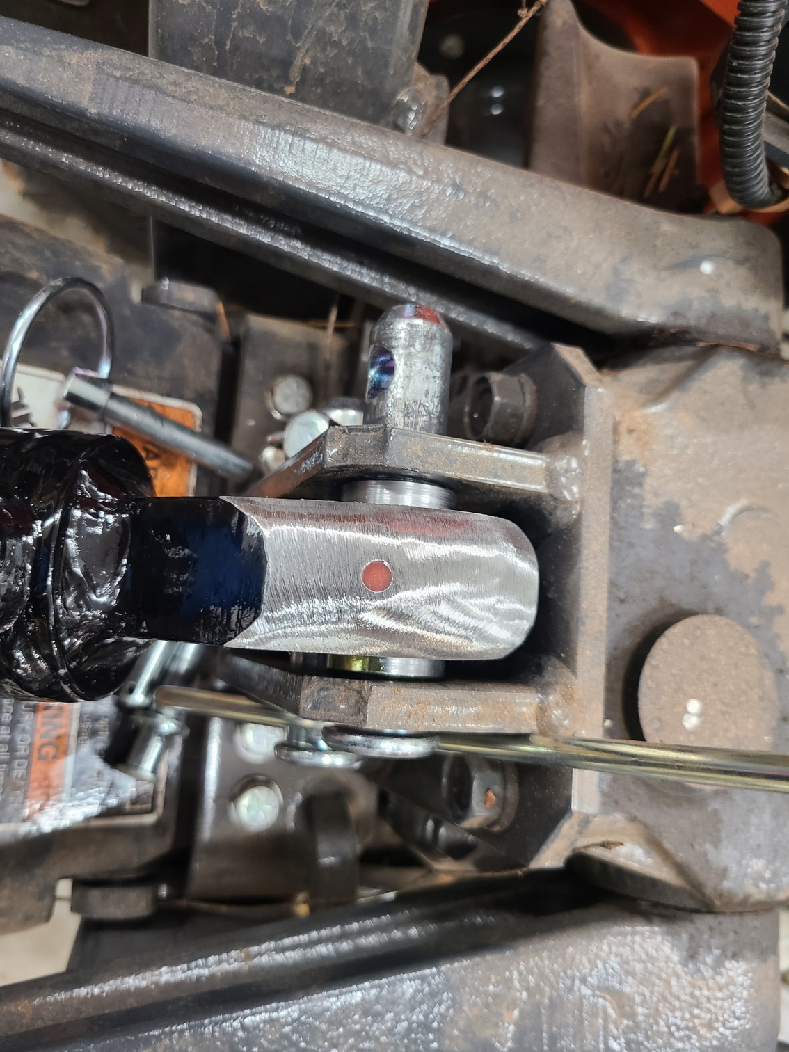

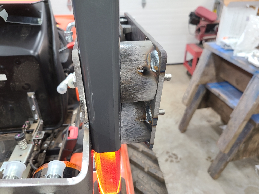

The rod end for the top link was too large to fit where it attaches to the tractor. I had to grind about 3/16" off the outside and round the corners.
I drove the tractor for a while with the valve in place and determined it needed to be a little further away. I used some steel pipe as spacers.
On the inside of the ROPS is a mount for the rear remotes.

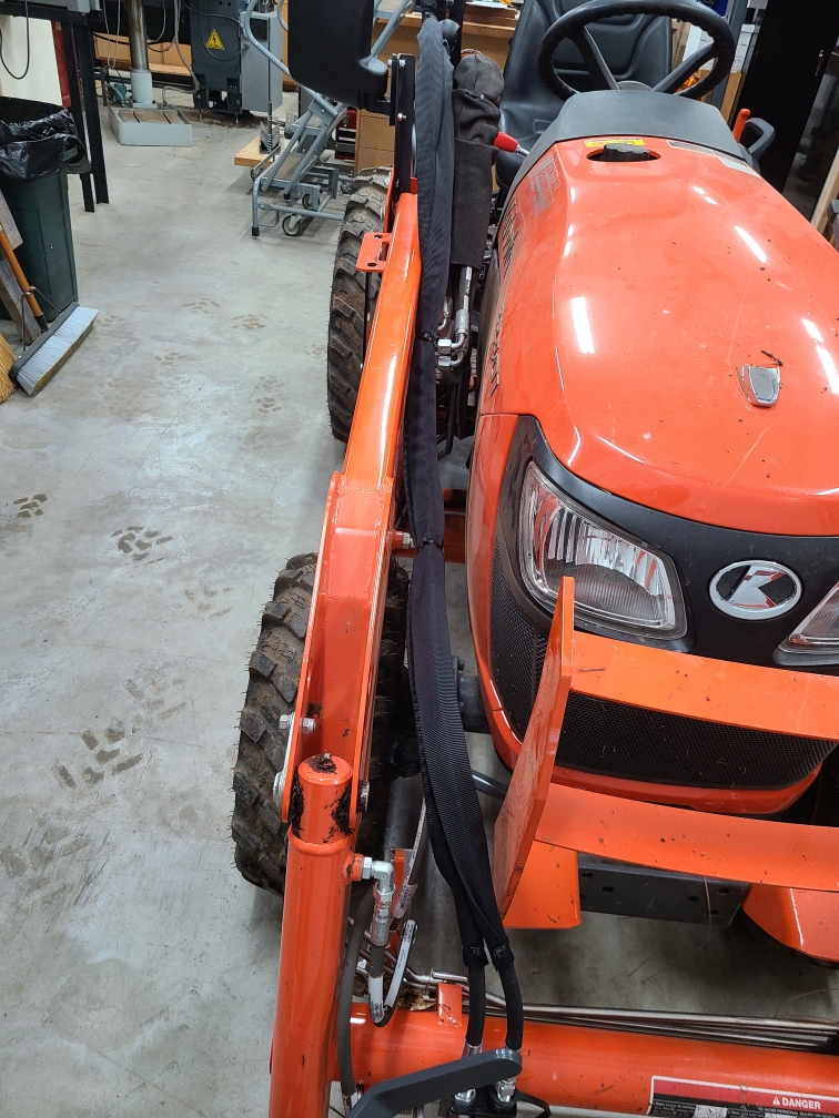

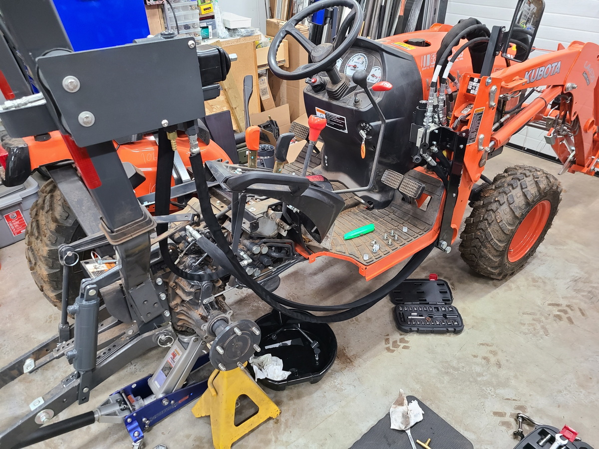

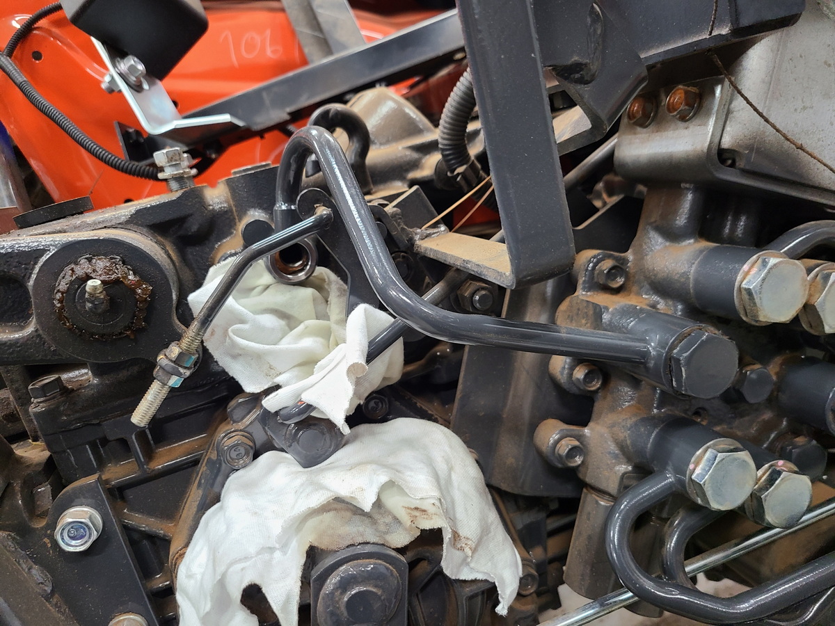

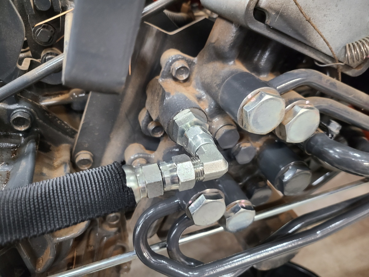

Here is the hydraulic tube from the loader valve PB port to the 3-point hydraulic inlet that is removed.
On the right is the 3-point hydraulic inlet banjo bolt and fitting that came with the Summit kit for the B2601. On the left is the stock banjo bolt for the 3-point hydraulic inlet. It is a BSPP 1/4-19 but flairs to a wider shoulder. The diameter is too large to use with the banjo fitting that came with the Summit kit. In the middle is a BSPP 1/4-19 banjo bolt and fitting I purchased.
Here is the new banjo bolt and fitting installed.
Here is the connection to the PB port on the loader valve. The SAE -8 / 3/8 JIC fitting from the summit kit works here. The loader valve is the same as the B2601. The thread is 3/4-16 or SAE #8. Not a BSPP thread like at the 3-point hydraulic input.

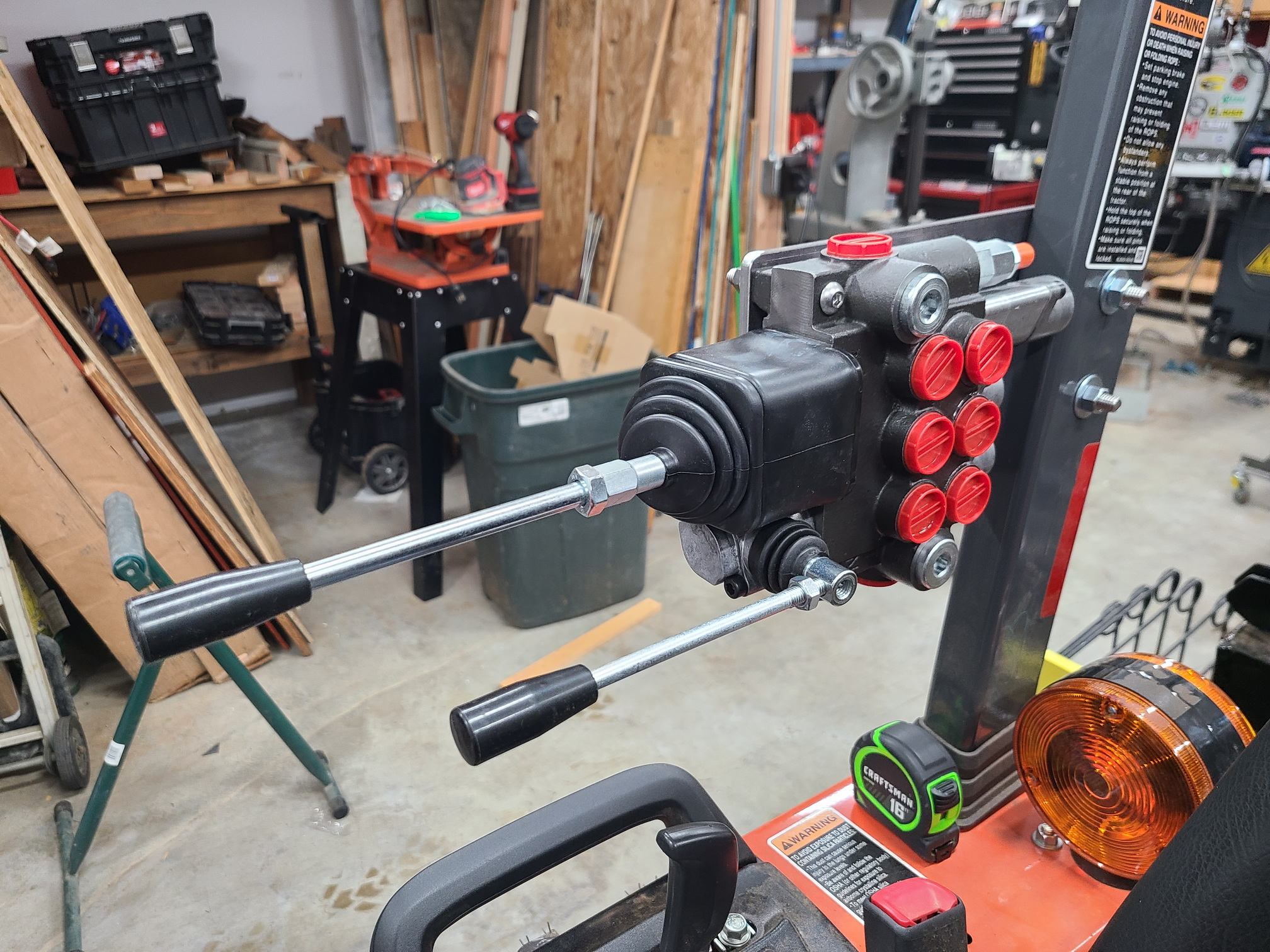

On the ROPS mounted valve the return to tank is 1/2" ID fuel hose. That hose Tee's into the hose on the loader valve to tank. I used a 1/2" pex tee with band clamps.

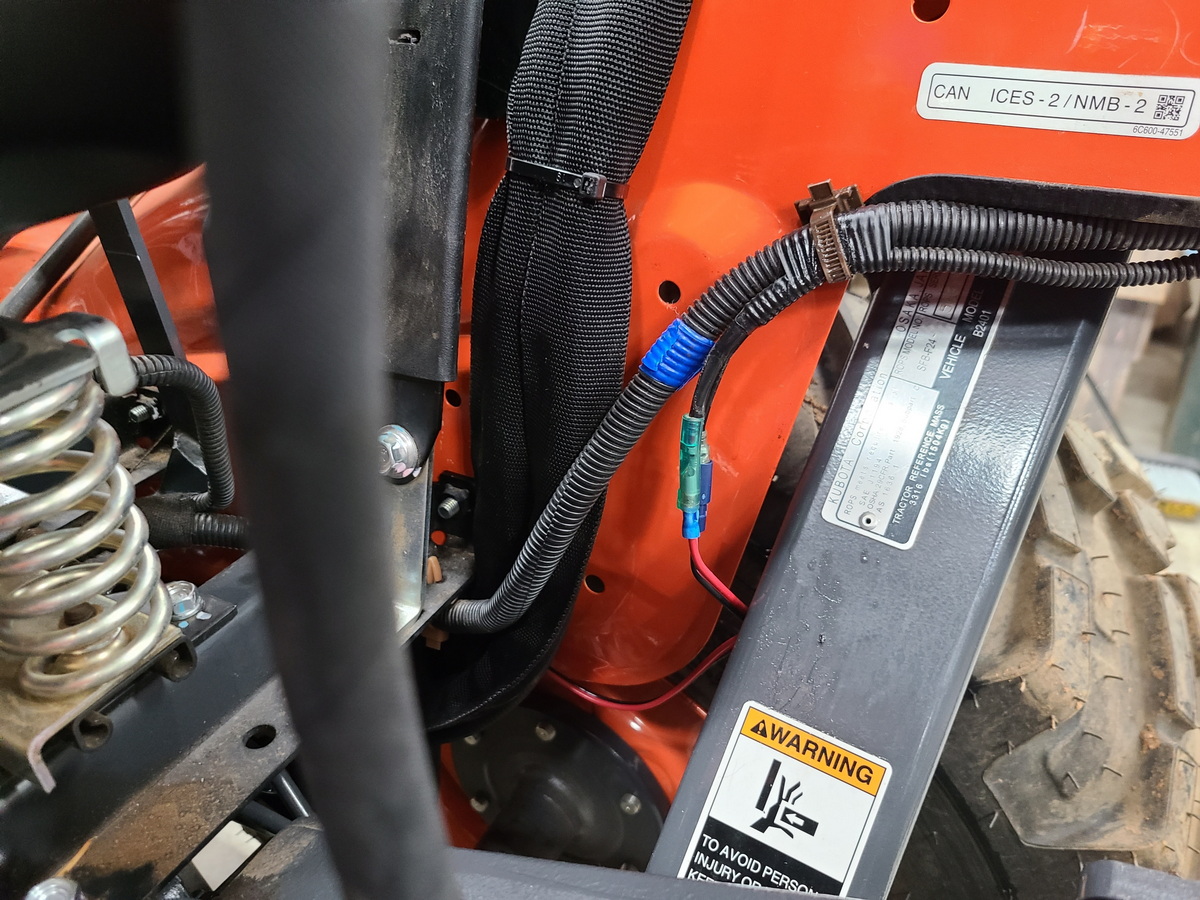

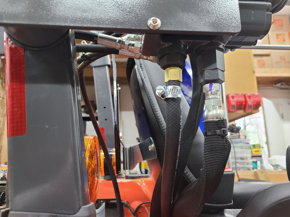

Photos of the third function.
20220321_142830.jpg 20220321_142746.jpg 20220321_142817.jpg 20220321_142710.jpg

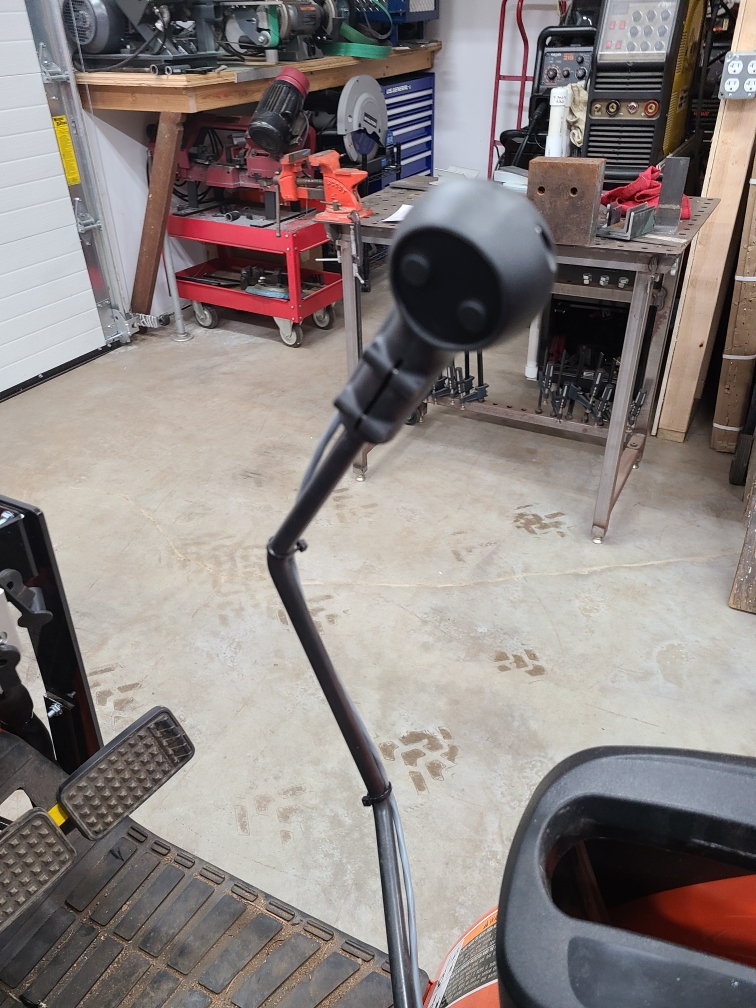

I picked up a keyed 12v source for the third function diverter valve at the rear tail light wiring.

Here is the connection to the PB port on the loader valve. The SAE -8 / 3/8 JIC fitting from the summit kit works here. The loader valve is the same as the B2601. The thread is actually a BSPP 3/8-19. The SAE thread is 18 pitch but is short enough that it is not an issue.
In addition to the difference in thread pitch BSPP uses Whitworth threads and a flat sealing washer. SAE uses Unified threads and a o-ring designed to fit in a recess. I would suggest you replace that SAE to JIC adapter with the correct BSPP to JIC adapter and sealing washer.
Edit: After thinking about this it seems unlikely you could get a 3/4-16 UNF fitting to even start into a 3/8 BSPP port. I am thinking Summit provided the correct BSPP adapter shown below - they look a lot like an ORB port adapter.

Just measured it and the factory banjo bolt at the loader valve is 3/4-16.
Post above has been corrected.

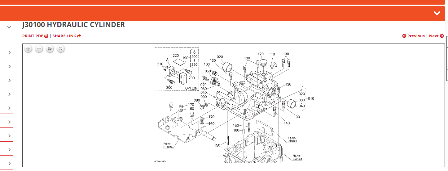

Was recently looking through the part diagrams on Messicks and found this kit, in the dash line box below, Kubota PN 6C040-95100.
It looks like this would allow a person to tap into the hydraulic system just as the factory remotes do.
Does anyone have experience with this kit? I'm assuming it gives a supply and return into the hydraulic system with some type of relatively common standard, BSPP, NPT, SAE oring?

Looks like a hydraulic outlet block. Question would be what sort of ports it offers. Messicks wants $150 - you could make your own for about $20. But plumbing into the loader valve power beyond seems a lot simpler and cleaner.
