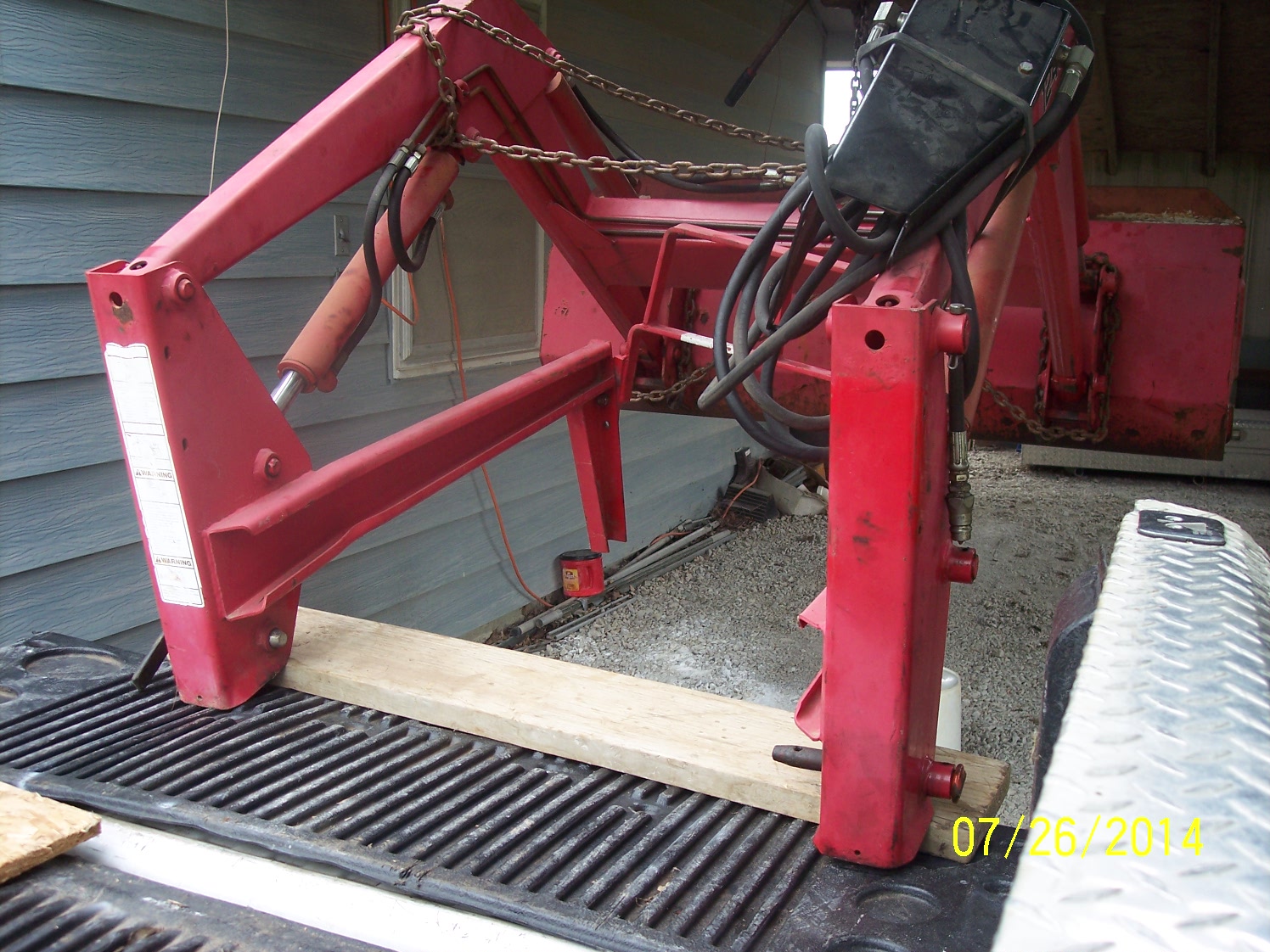

Finding a factory mount to fit your tractor will next to impossible, and if it is found/fabricated cost will likely be prohibitive.
If you have some equipment and fabricating skills you can make the mount to get the loader on your tractor. I bought a Massey 1246 loader and built the mounting brackets to get it on a Kubota L305.
With an off brand loader the critical thing is to be sure the width of the loader fits your tractor. I made sketches of what the loader needed and then the holes in the belly of the tractor to match them up. When you're done make sure you have some bars going from the bottom of the loader towers back to the rear axle. These are critical. They keep the loader from pushing back on all you have fabbed up and busting the housing holding the mounting bolts.
All the bolt threads are metric. I remember picking up the bolts at Fastenal and the total was over $100 and that was nine years ago.
Here's some pictures of the process.
