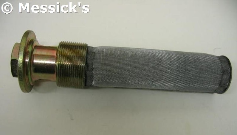

Yes
Screen is part #50

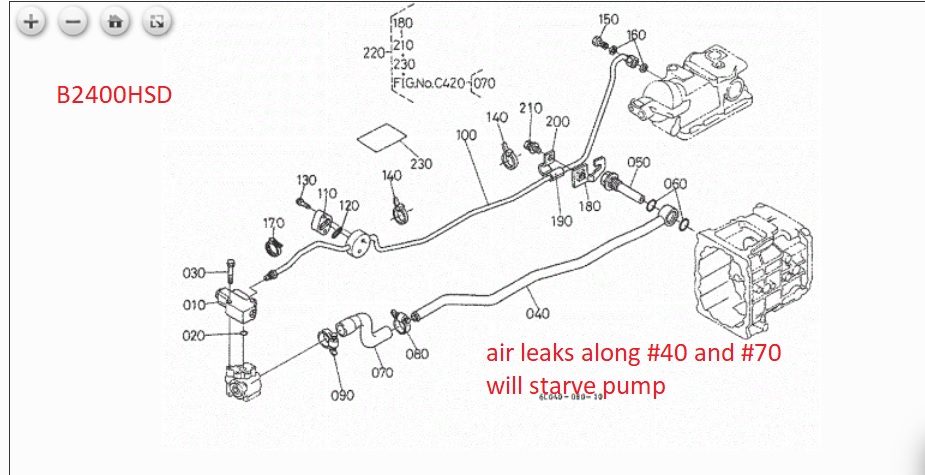

An air being sucked into the suction line will stop pump. Check and rubber part for deterioration and seals should be replaced.
Sometimes the pump will need a little help to get primed. Adding oil to pump is one way. Using a shop vac set to blow and pressurizing the transmission with the engine is running may get pump started.
The hydrostatic transmission is largely self contained but it received a little oil from the PS system

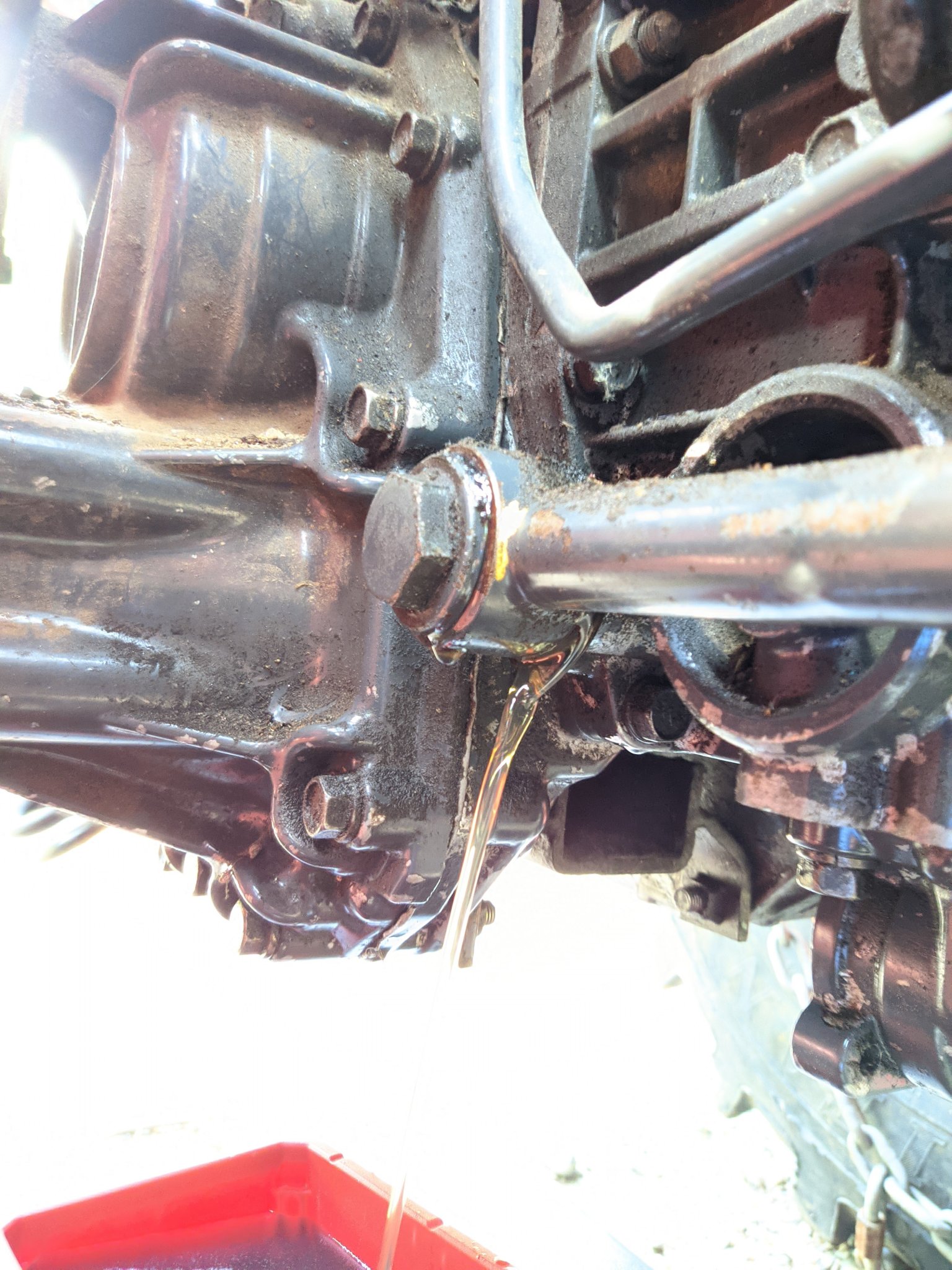

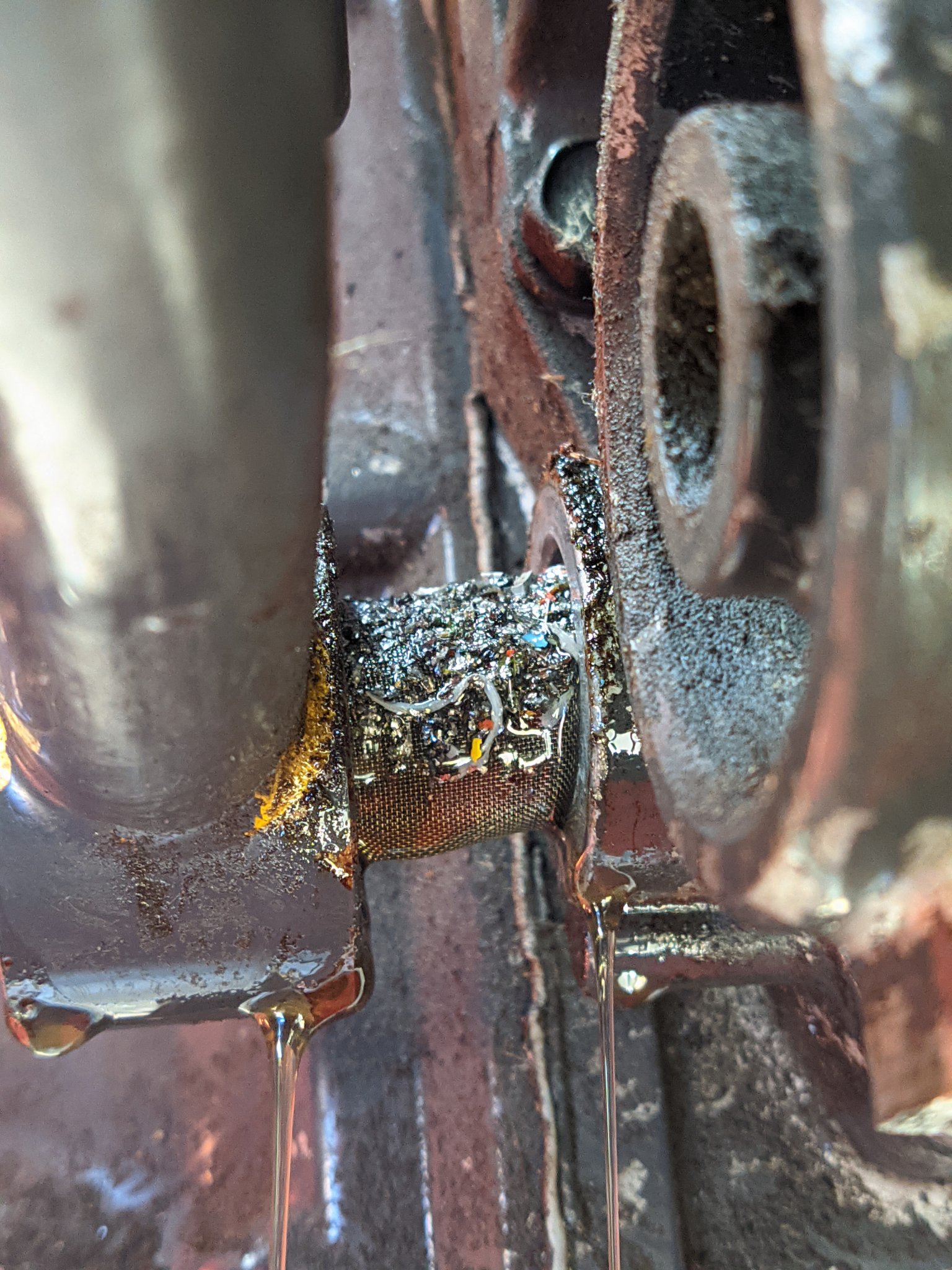

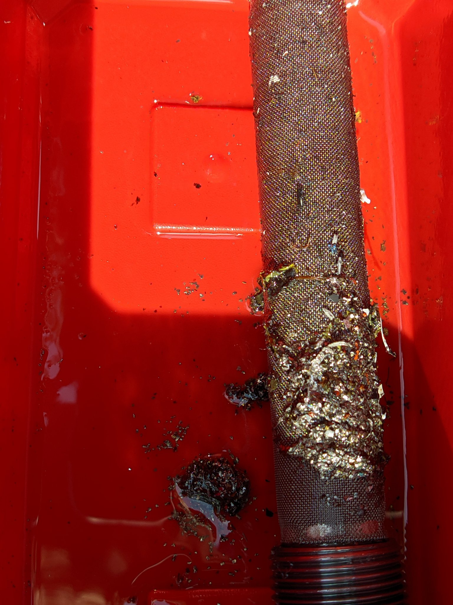

You guys fixed it!!! 👍👏
It was the screen. This should be stickied.
Why wouldn't the dealer clean the screen when they do maintenance?
Also why didn't the hydraulic filter pick up all this crap?
Here are some pics.
6,506
2,127
The flow is sump through screen through pump. I don’t see a filter in that circuit (except for the screen). I don’t think the filters you have is for hydraulic system but only the hydrostatic drive system and one on engine oil and one for fuel.
