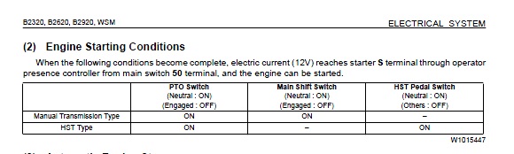

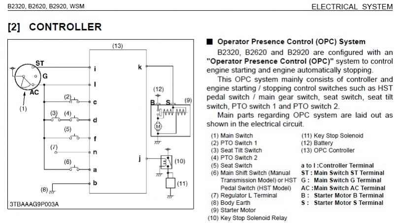

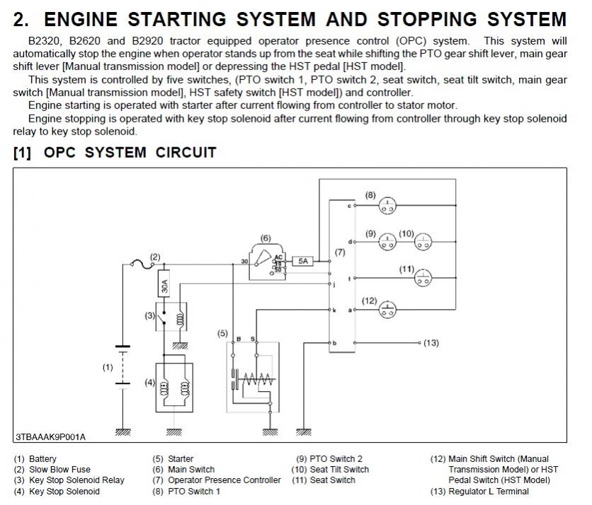

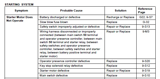

Your tractor with its Operator Presence Controller is more complicated than a typical garden tractor.
I have attached about 6 pages from the WSM.
Note that there are two pto switches.
