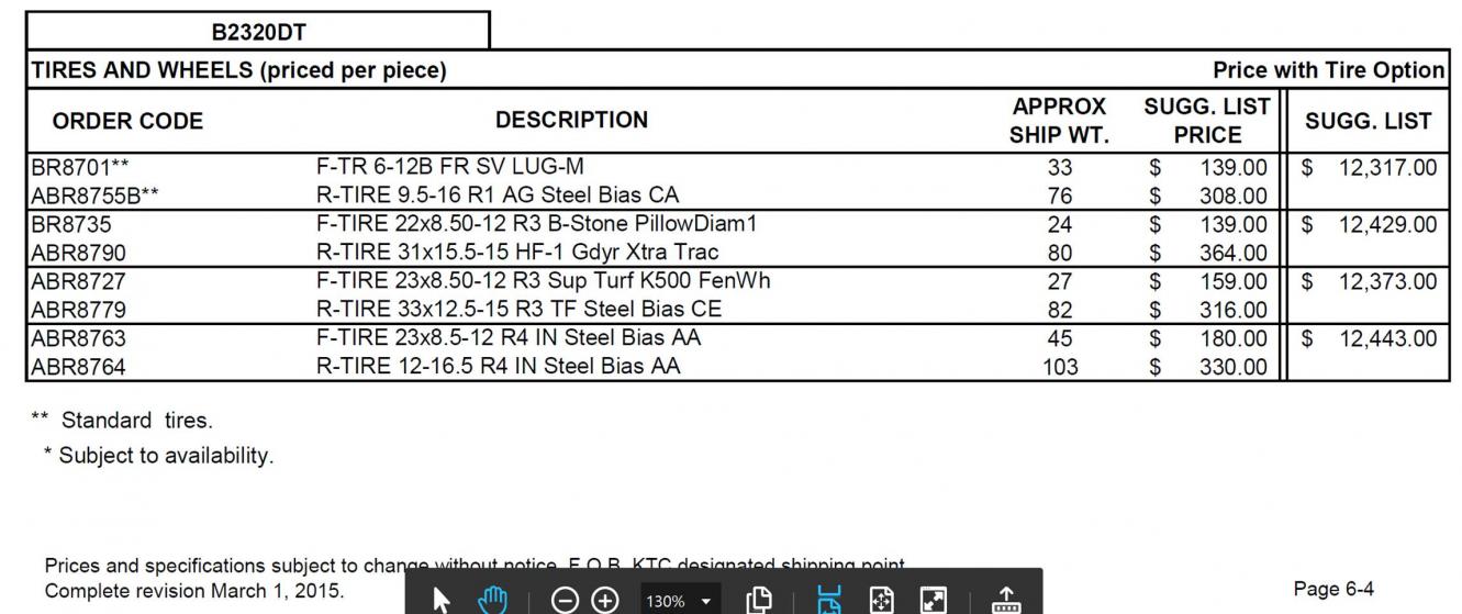

You might want to contact the sales group at your local dealership and ask for Wholegoods pricing on the tires/rims you desire.
Below is an example of wholegoods pricing for R4's and was accurate in 2015.
This is typically one of the more economical options when needing to purchase tires and wheels.
