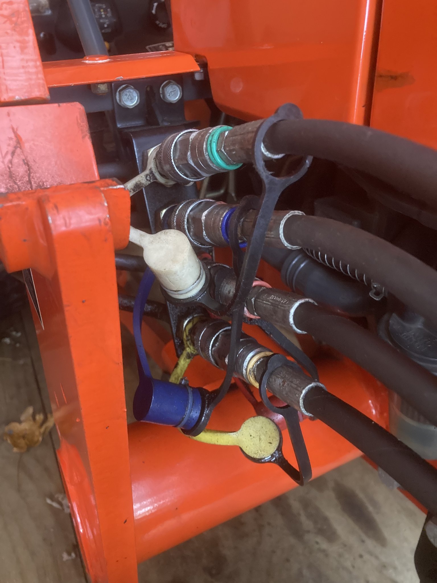

Next step would be to check flow through the lift circuit. If you post a picture of the coupler arrangement I can suggest a starting point.
Here are a couple of pics of the coupler arrangement. Boom is operated through white and yellow couplers.
View attachment 122509 View attachment 122510
OK - that makes things fairly simple.
To test the lift side of the circuit disconnect the coupler on the rod end of the cylinders and unscrew the hose from the coupler. Put the hose in a bucket, start the tractor, and try to raise the loader. You should get a stream of oil from the disconnected hose and the loader should come right up. If not the connected coupler is not working.in the out direction.
If the loader raises lower it. If it wont lower the coupler is not workimg in the return direction.
If the loader raises lower it. If it wont lower the coupler is not working in the return direction.
