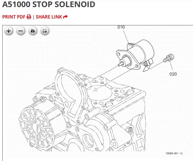

On a gasoline engine you stop it by cutting electricity to the spark plugs.
On a diesel you stop the engine but stopping the supply of fuel into the cylinders.
On old diesels the operator had a manual lever cable arrangement to cut the fuel.
Newer engines with safety switches use an electric solenoid to cut the fuel.
The small diaamter plunger on the right side of the photo below moves in and out.
I will provide a photo from Messicks and a parts illustration page.
This next is a page from the WSM describing in very poor English how this stop solenoid is used.
Ask more questions if needed.
Dave

thanks Dave. that explains it pretty well. I did read where the seat switch has a tilt function. Just more info - while I was picking up small logs using 'clampon' forks, i did need to lean forward a bit to try to see forks (I know this is a bad deal) but looking back - that may have been when my engine cut out|off.
