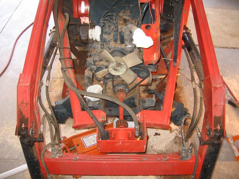

I recently acquired this b7100 with the b219 loader. The loader was all in pieces and I found most of the parts except the front brackets going to the frame and the pump. I can make new brackets, but I can't find any info on the pump. Does anyone know the GPM and system pressure? I'm looking to buy a universal pump and make my own brackets. I've already downloaded the only manual I can find for the loader and it's not helping.

I have another question. Can I use a shaft with a love joy coupler instead of the sprokets and chains to run the pump? Also what would be the easiest way to make a plate for the pump and ensure the shaft is straight?
That was 2 questions, you are now banned.... Sorry couldn't help myself!:p:D:)
Yes you can use a lovejoy.
As you are mounting the pump to the frame, just match the frame, it's square to the motor. ;)

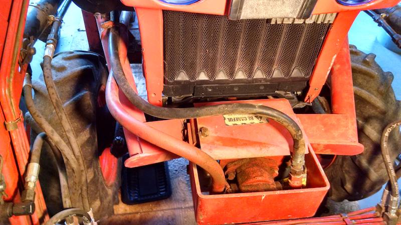

I'm headed out at the moment, but if you have specific questions, I can check my B7100/B219 when I get back.

Lol at first I was like what???? Lol. Can I get by with one love joy or do I need two to match what the original shaft is like?

Is the pump bolted to the frame or to a plate that bolts to the frame? If it's a plate then I need to duplicate it so the pump lines up correctly.

Headed to bed now and I've got my morning booked, but I'll try to get out there and take a look, maybe some pics, by lunch or so tomorrow.

Good deal, much better pics. The top plate and grime on mine makes it somewhat difficult to make out the mount.
