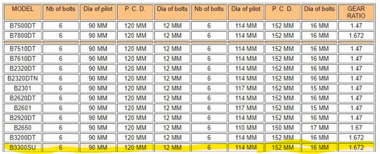

I've searched all over and can't find bolt pattern info. Can I swap tires and wheels from a b3300 onto my b2150?
33,841
9,067
Very unlikely as the ratio is more than likely different.
I will have to pull up the chart on both of these, give me a few min.
33,841
9,067

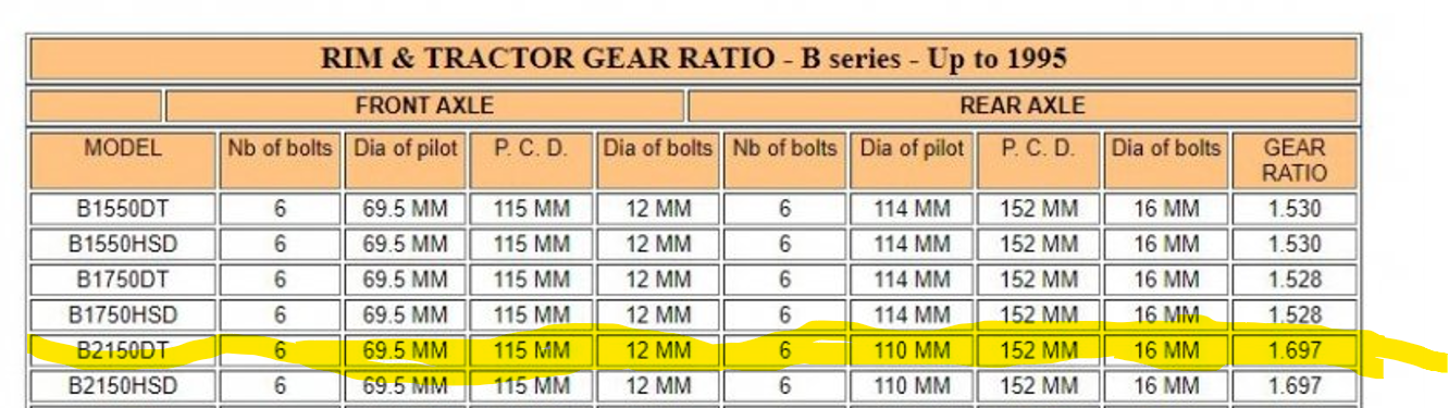

So here are the 2 tractors full specs:
Doesn't look like much matches up.

Clearly the fronts don't match at all. Tire size is different as well so the ratios wouldn't work as you said earlier.
The rears appear to be the same except pilot diameter is larger on the wheels so they would mate up but not hub centric. Would this be a concern in your opinion?

Yes you want the right sizes of tires and rims.

Rear would be fine. Fronts however on the b2150 use the old style 6 bolt rim and 3300 uses new style 6 bolt rim. Bolt pattern is slightly different. And as others have said the fronts are smaller diameter on the 2150 so ratio would not be correct
