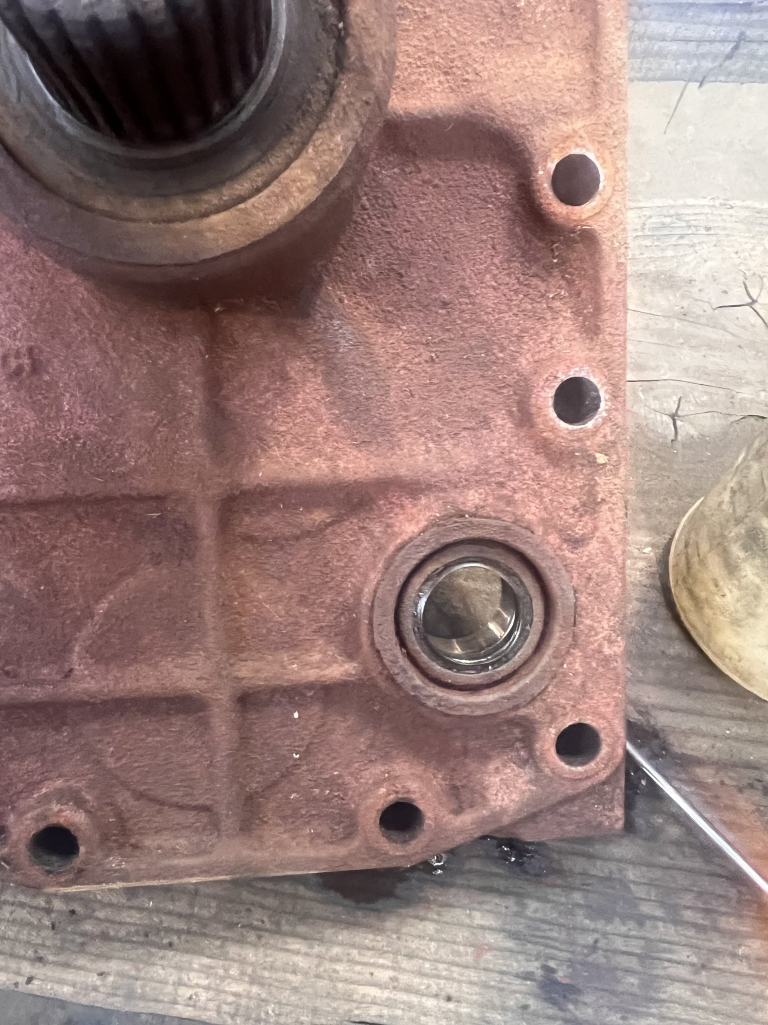

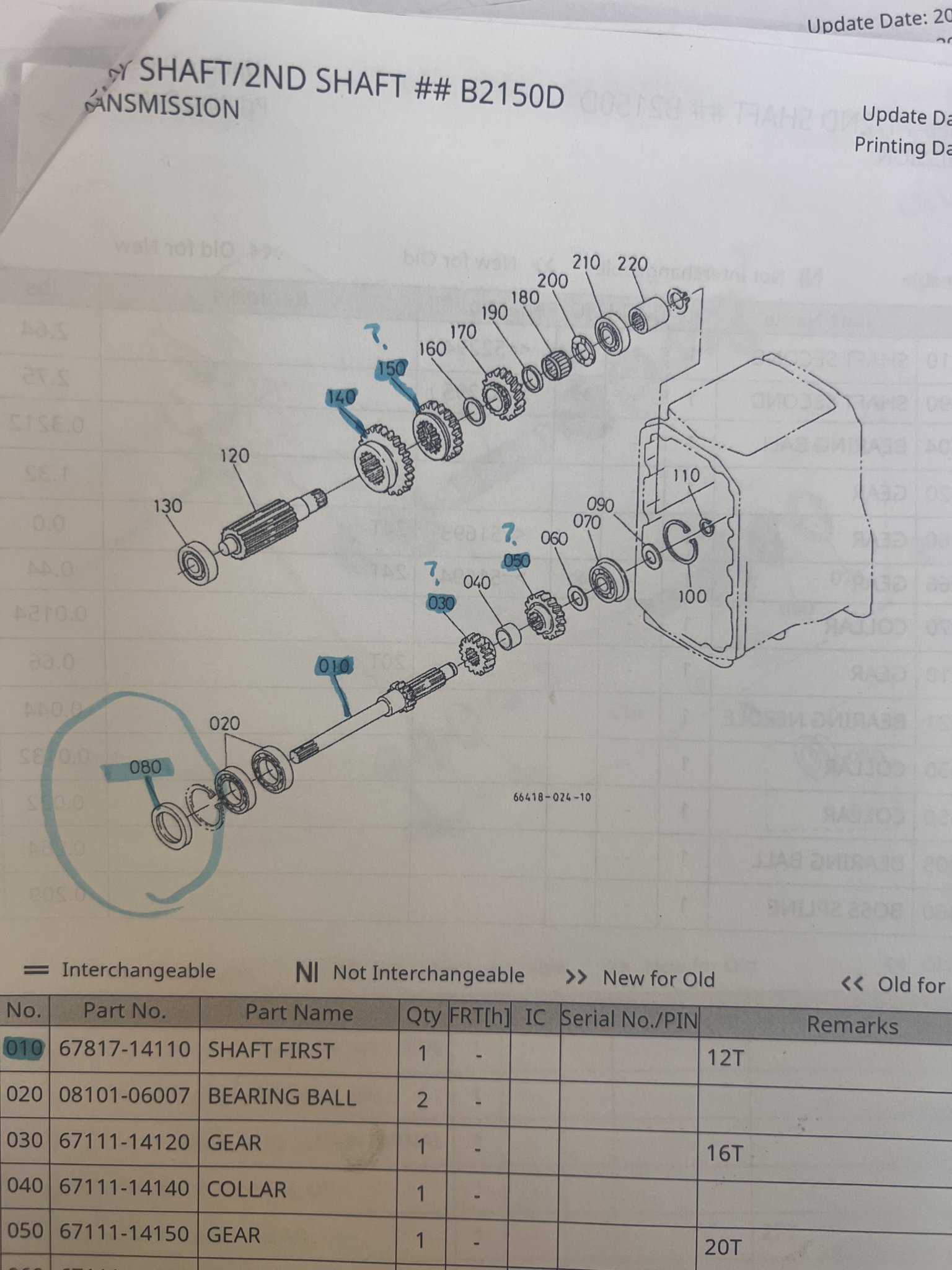

part number ( 67817-14190 )
its the 4x4 shaft seal, ( the smaller one in the picture )
View attachment 139030 View attachment 139031
Some of the metric sized seals will have a series of 3 numbers on them. The first number is the shaft size, the second number is the bore size it fits in and the third number is the width or thickness.
Clean it off carefully with some brake clean maybe, and the will be right on the face.
