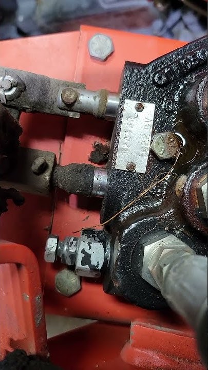

I belive my detent is bad on the control body for the bucket lifting...
Kubota says the detent kit and the entire control valve are discontinued with no part super session...

Wait, is the only thing wrong with that, that it doesn't stay in float? The ball disintegrated?
Honestly, if that were mine id just clean that up, find a new steel ball and a spring (if the spring isn't still there..), and put it back together. It doesn't look that bad to me..

The bucket does not lift.
First the float stopped working. Then the bucket raise got suuuper slow so then nothing at all. I then switched the hydraulic lines to proof out the cylinders and it lifts fine now... The spool does not go all the way down...

Its not worth fighting with. Put a new valve on it.

If those videos were taken before you took the float assembly thing off the end of the valve, the most likely thing is just that chunks made their way behind the detent rod and were keeping it from moving fully to the raise position. Try to lift the loader with that cap thing removed from the valve assembly. If that doesn't change it then yeah, i am ok with TOH's 'not worth the fight' assessment in your situation.

Correct. As I removed the detent cap, the spool/cylinder had full travel within the manifold/block. So my binding is on the cap, and even after I cleaned it.
