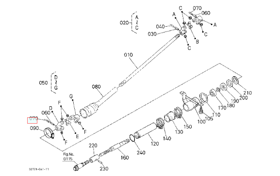

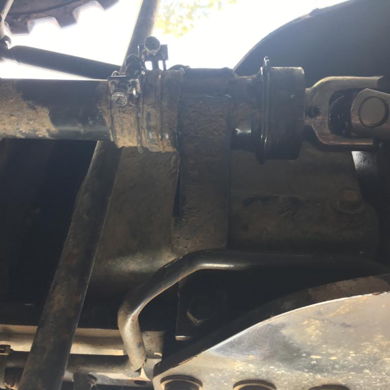

You will find it much easier to work on if you just unbolt the carrier, and drop out the front section, then on a bench you can easily remove the roll pins, and there is a roll pin inside a roll pin on that setup.
