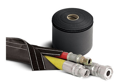

My B21 has one of the 6 hoses that go through the sleeve to the boom leaking. They are less than a year old, the hoses going into the sleeve are dirt, the hoses coming out of the sleeve are dry. I do not know which one is leaking inside the sleeve , abraision? Is the sleeve necessary? Does anyone make a sleeve with a zipper? I would hate to remove all 6. Please help!

Yes abrasion sleeves are absolutely necessary.
But it sounds like something failed with your setup.

Interestingly my old 1985 Woods 650 had no hose sleeves and never had to replace a hose after 35 years of use. Did have to weld up cracks in the dipper though. Will see if my bh77 lasts as well.
8,005
5,185
Kinda pricy stuff!
