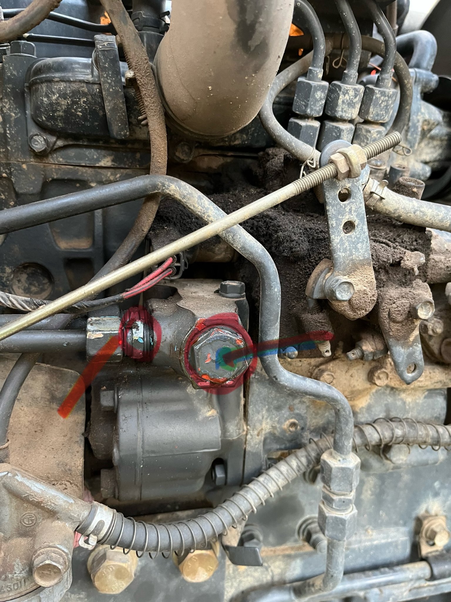

Thank you all for your input! Got back in town from work and had some time to look into the B21 some today. What I was able to do this far: disconnected and reconnected the quick connects- only 2, go to the backhoe, also connected them to themselves bypassing the hoe, nothing changed. Cracked various hardline fittings on the loader, machine running, no hyd fluid came out. Cracked couple of bolts on pump/ valve, machine running, no fluid. Found my service manuals with ancient pictures, in troubleshooting it lists as possible issues: control valve broken/ relief spring damage/ piston O ring or cyli damage/ suction pipe issues and lastly pump itself. Any thoughts out there ? I have another week out of town with my manuals and an iPad . Also if I need a pump I see that Orem is twice the price of other replacements… get what you pay for probs? Attached a pic of nuts that I cracked.

AnUnfortunately theres not much info available online for that tractor and the parts diagrams are not informative. The system is clearly different than the ones used on other models. The picture is the pump but what exactly the line is is not obvious. The other nut looks like it may be part ofxa pressure relief or flow divider. What manuals do you have and can you share? A hydraulic circuit diagram would be a goodcstarting point.

I popped for a $10 download of the WSM. I only had time for a quick glance on this crappy phone but it looks pretty simple. The pump output is split into PS and implement circuits by the flow divider mounted on top of the pump. Check for inlet oil at the loader valve or the loader supply port on the hydraulic outlet block.. I am guessing there is none.

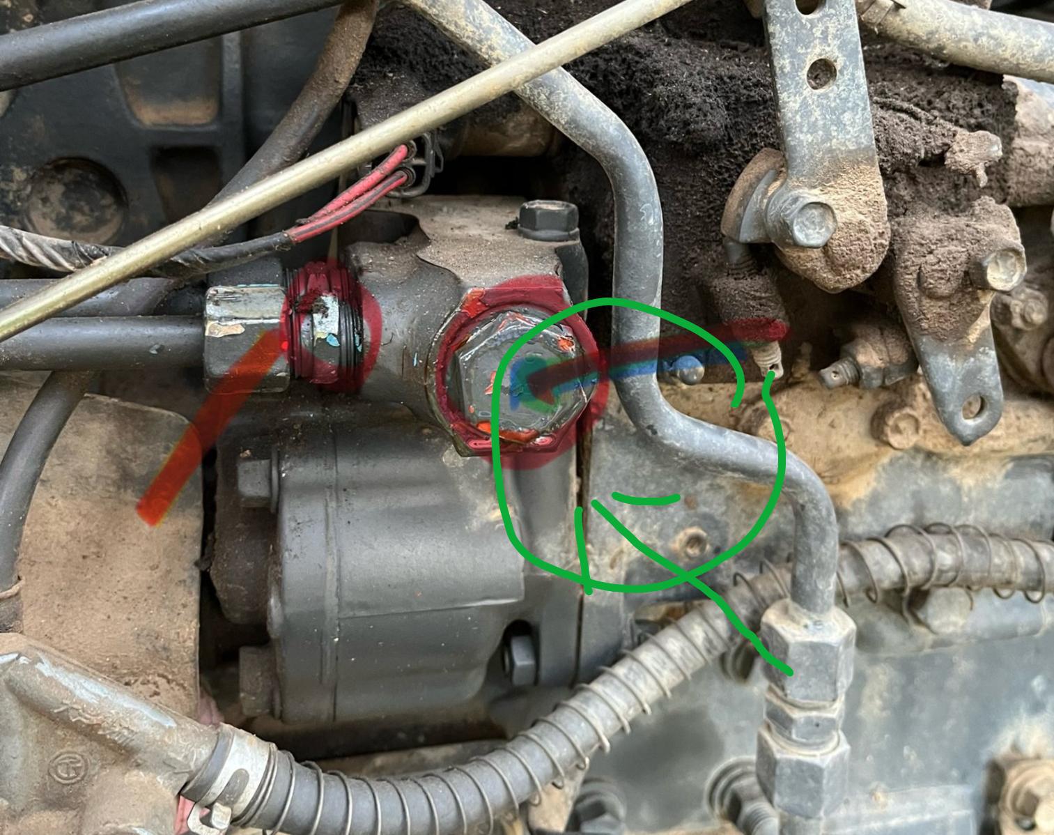

The leftmost fitting circled in red is priority flow going to your PS. Should be oil there with the engine running. A closer look at the pump has me wondering. Is that green area I circled a gap between the pump mounting flange and the engine block? That does not seem right to me.

!!! WOW I see what you mean. It’s hard getting on this with work travel!
Yes - i would expect the full length of that flange to be pulled up tight to the engine block. Looks like the pump may have pulled away and possibly lost engagement with the drive gear. If so that would account for a total loss of hydraulic flow.
