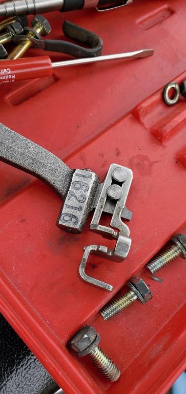

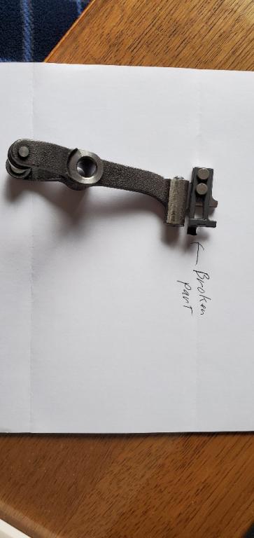

My governor arm broke the fork end that slides the pin that comes out of the side of the injection pump. I ordered a new one from Kubota. it looks like it is upgraded/different from the original. I installed this and the tractor now runs but idles low and does not have much power now. Is there an adjustment for Idle and power?

Sounds like you got the wrong part, or you might have the injection pump rack pin in the wrong slot, if it's the model that I'm thinking of.
