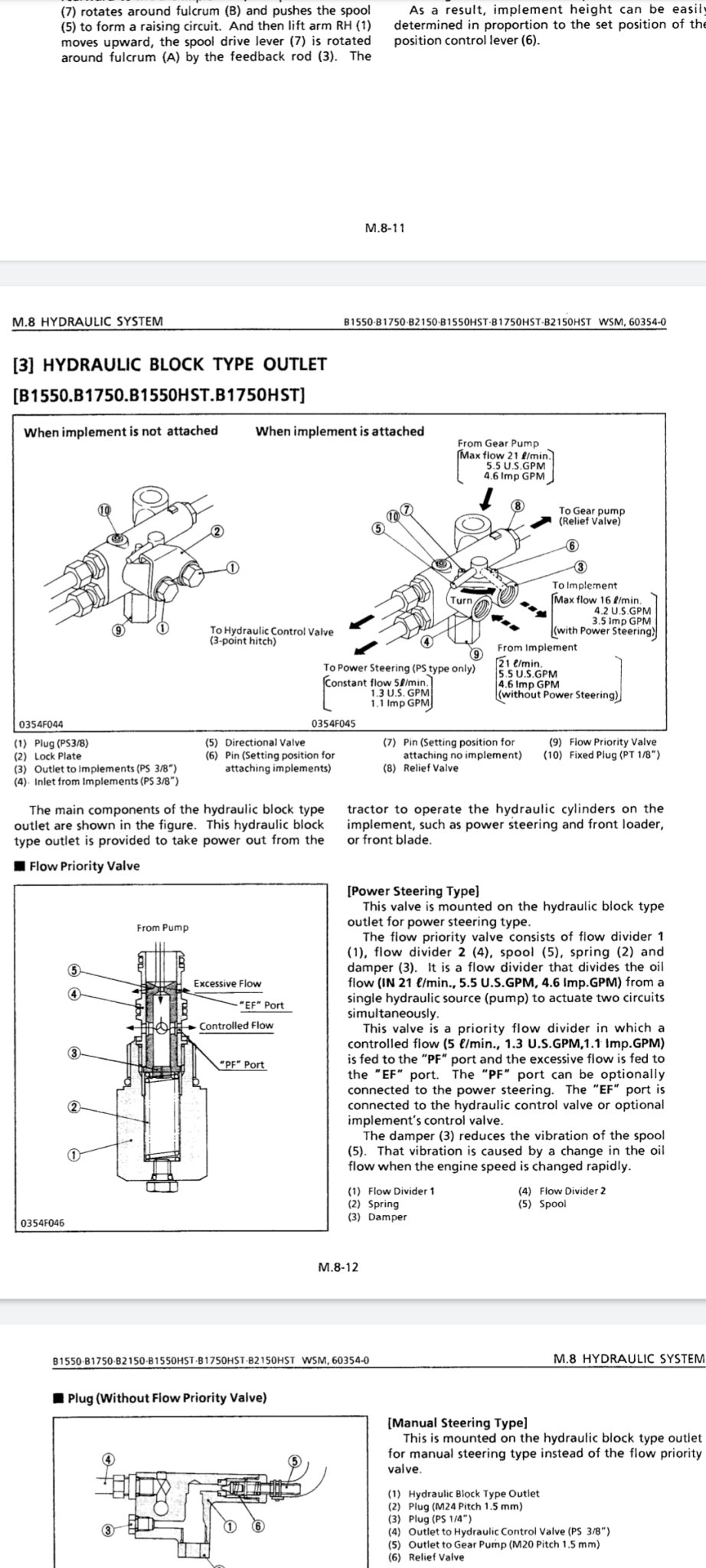

Please see attached screenshot of the WSM. You are correct in that the diverter valve that you marked is for an auxiliary implement such as a loader. I'm not sure if a previous owner had a loader attached but it does look that way by the wear where the rust is. Anyway, by the diagram in the WSM, it's in the correct position to power the 3PL and power steering.
Today I backed off the nut on the high pressure side of this valve that goes to the power steering pump. It was suggested on another forum that hydraulic fluid should be pumped out with force when the tractor is running. No fluid came out other than the tiniest couple of drops under no pressure.
I backed off the inlet bolt to the hydraulic pump and found what looked like the correct level of fluid in there on the intake side of the hydraulic pump.
On further investigation, I found that the hydraulic pump was missing one of the screws (marked "3") in the diagram of the hydraulic pump attached. This to me indicates that the hydraulic pump has been opened before and possibly unprofessionally.
I wonder if it's the pump at fault. I would've thought that a pump at that high pressure would be relying on an absolute seal in the pump.

No need to guess. Spend $20 USD on a 5000 PSI hydraulic pressure gauge and the appropriate adapter fitting and test pump output pressure.
You do that at the outlet block mentioned earlier. With the engine off remove the rightmost plug and using the adapter screw the gauge into the port. Then move the selector lever on the block to the implement position, start the engine, and read the pressure. Do not operate the tractor for more than a minute or two. Shut the engine off, replace the plug, and move the selector lever back to the 3pt position. You should be getting roughly 2000 PSI at rhat test point.

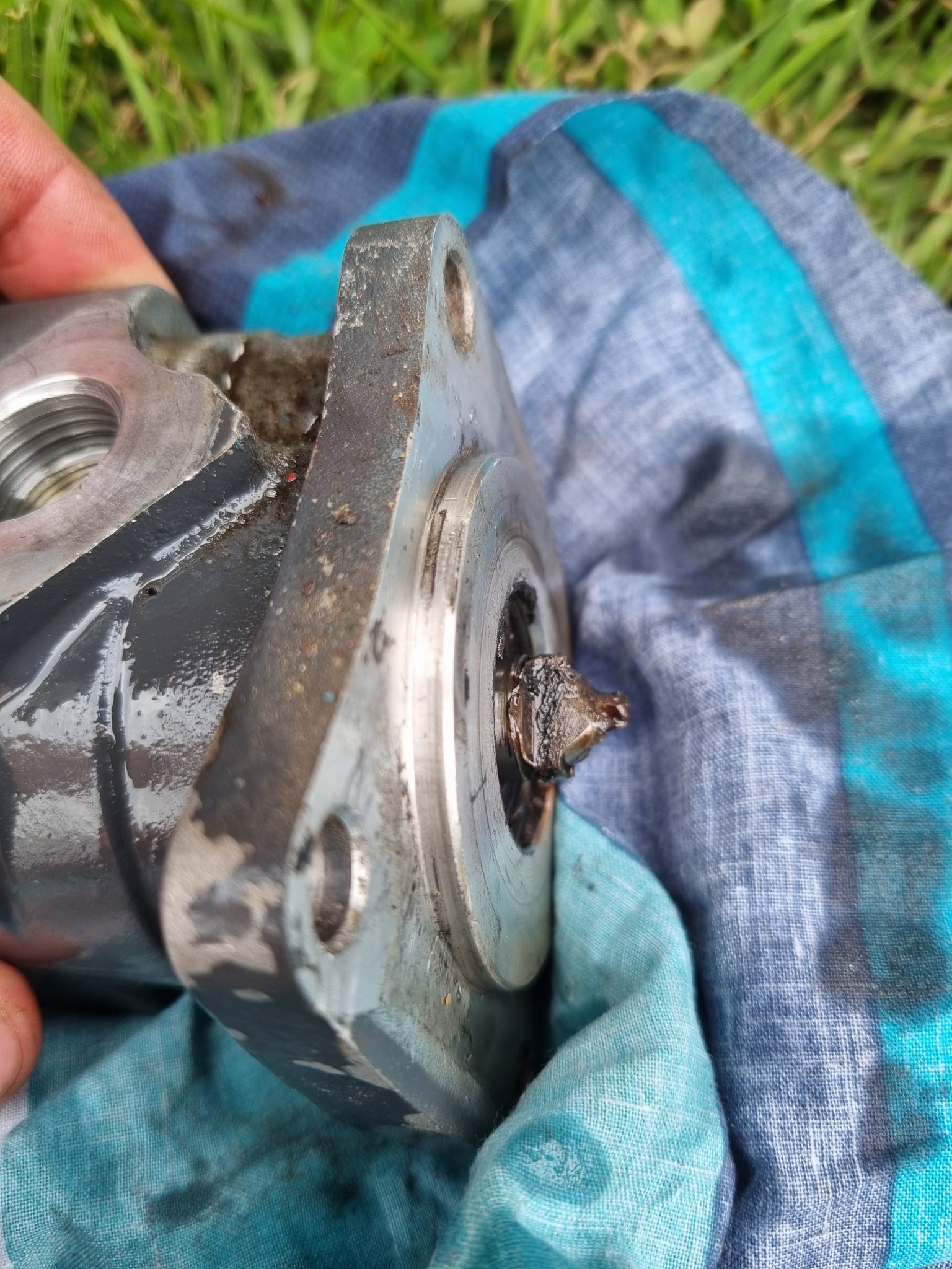

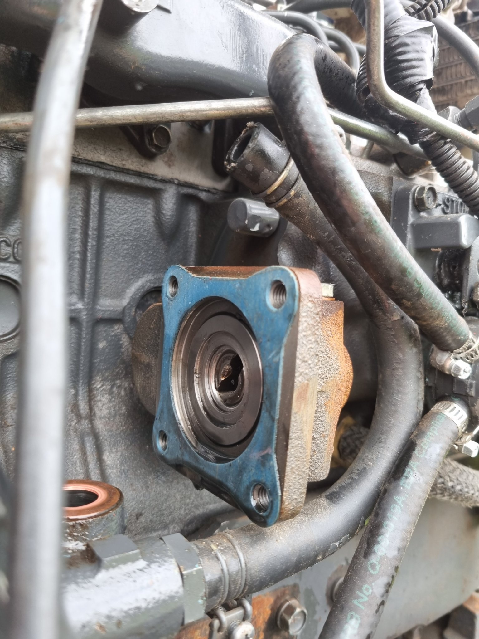

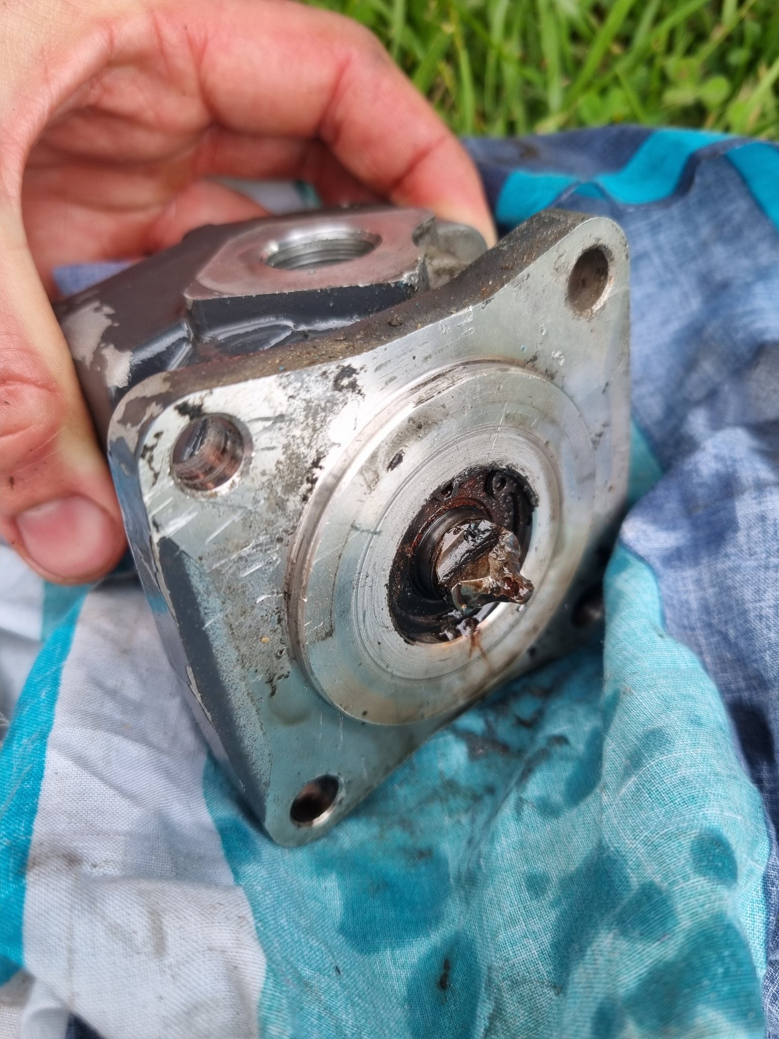

Bit of an update from today's works. I pulled the hydraulic pump off today to find the drive tang on the pump broken. Well done North Idaho Wolfman, hit the nail on the head!
Is there anything in particular that I need to remedy that may have caused the tang to snap before I bolt a new pump on? Or could it just be general wear and tear/fatigue?
