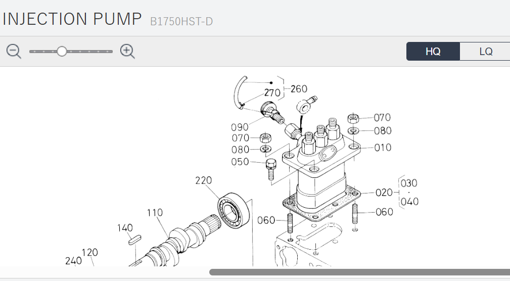

Hello everybody. I am the proud new owner of a B1750. I seem to have a fuel leak that appears to be coming from the top of the injector pump. There is a plate the holds the injector lines and the leak seems to be between that plate and the pump body. Is this a common problem on these machines? Is it going to be as simple as replacing the gasket and bleeding the injector lines?

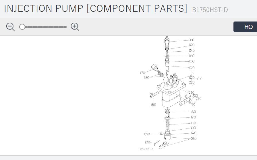

It appeared that the leak was from reference #020 in the first picture. I looked up the parts breakdown (the same pictures that you provided) and I can see that part is a shim (.020" .030 & .030") .
