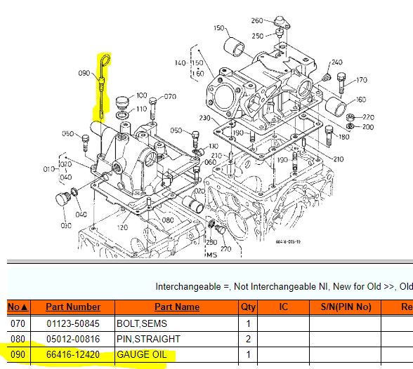

I finally got the 2wd Kubota B1750 delivered. I made a previous post about a broken oil dipstick but It is the hydraulic dipstick. Anybody know the length of the dipstick? I have a couple dipsticks here and just need to know how long to cut one. Also, do you techs think the tractor needs to be taken apart because of this. It does run good as is.

Sorry can't tell you the length, but for $10 you can get a new one that's the right length.
P/N 66416-12420
and I would't worry about the rest of the dipstick, it's either laying at the bottom of the case or it's already pulverized and in the filter. ;)

Thank you again Wolfman, but that says oil gauge. I need the hydraulic oil dipstick which is metal on my 1750.
Bob in WV
That is the right part # for the hydraulic dipstick, they just use odd names. ;)

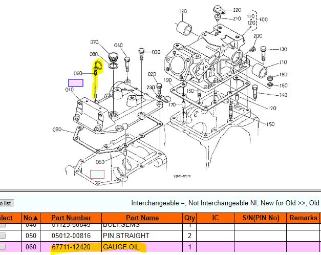

I better specify, it's not an HST is it as that takes a different dipstick.
DT Oil Gauge:
HST Oil gauge:
