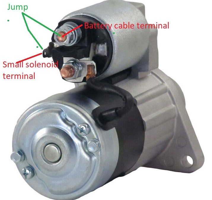

Typically the your results of your jumping the starter ( just spinning) is because you are not doing the jump properly.
Study this image and confirm you are doing it as shown. I think you are jumping the two large terminals on the solenoid which does not pull in the bendix.
A big caution, if you do the starter jump properly, you are bypassing all safety features and can get run over or have a runaway tractor. best to have someone on the seat with the brakes applied.
