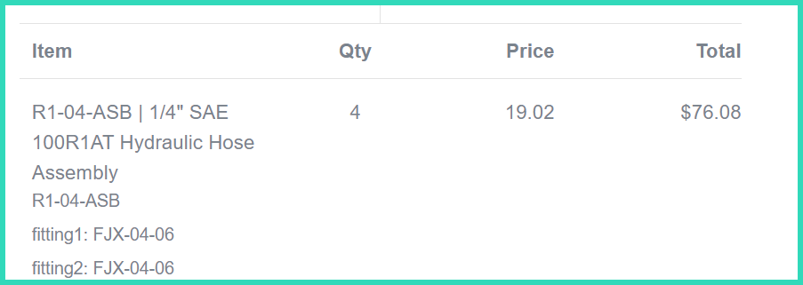

Here's what I bought - no idea if yours are similar.

It ain't rocket science. Time to do a little learning. Check these guys.
They're pretty fast, make decent hoses, and will probably have exactly what you need. They have for my FEL.

Just got the last hose I ordered from DHH. With a little luck, this will finish up my permanent 3rd function plumbing and allow me to hook up my tree puller.

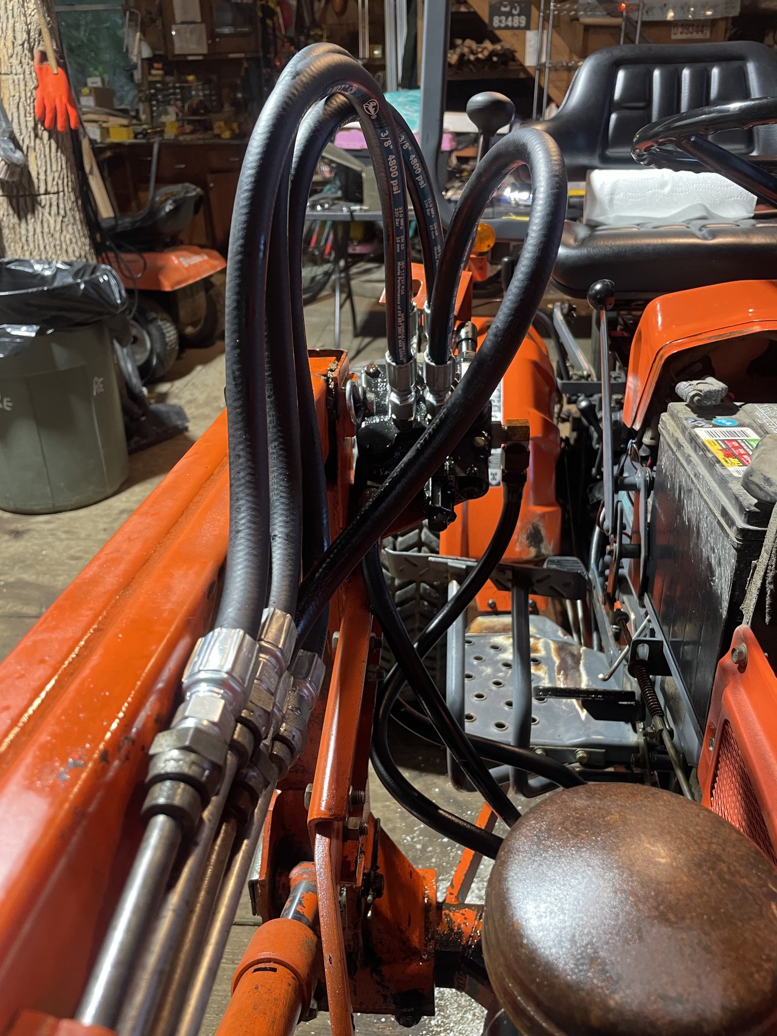

TerryKing
B7100HST-D
Aug 18, 2024
161
109
85
Topsham, Vermont USA
arduinoinfo.mywikis.net
Many THANKS to all you guys!!
Had to replace all 4 of the control-to-loaderFrame hoses..
NOW the engine starts and runs sweet, the loader actions are what I expect, and I got to finally DRIVE the thing around the driveway! And I understand the connectors and the variations.
I THINK I should adjust that one hose at the forward end to have it follow the curve of the others...
Looks good. Now fix your equipment list, D7100? :)
