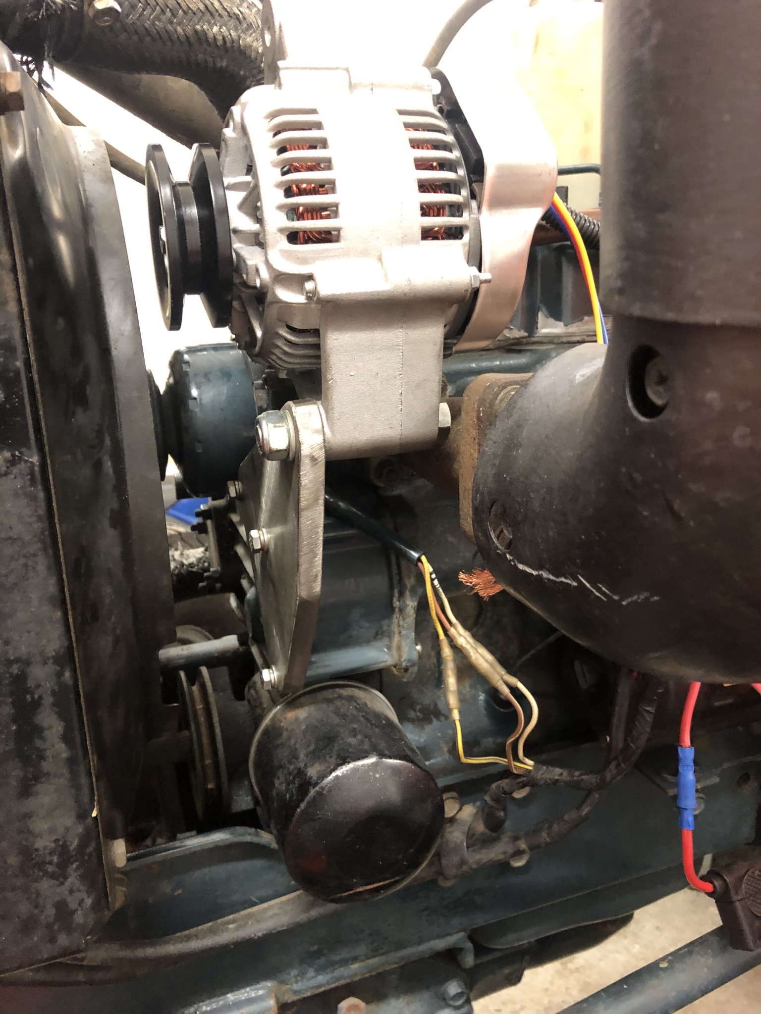

The owner of this B1502 did the best thing and installed a single wire alternator.
Alternator
If you are at all handy you end up with a reliable charging system of much more capacity for about the cost of the regulator/rectifier.
Search on eBay for a DENSO one wire alternator. Voltage regulator is built in. Only one wire to connect.
Dave

kubota B1502-M
Feb 18, 2021
14
norway
i mounted an extra alternator, and wired it up with new cables, all works great and its no issue to use the electric winch in the front:)
