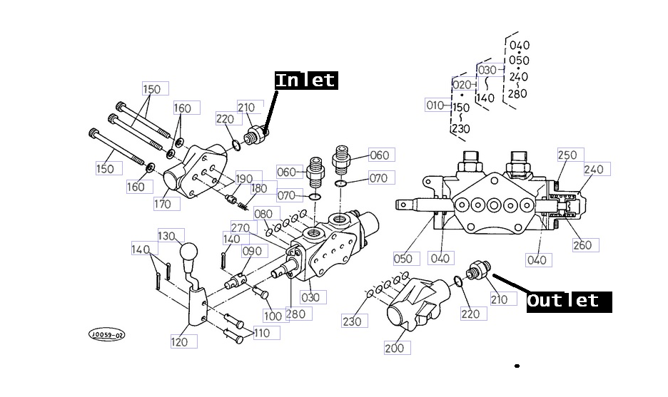

I'm working on a L2950 for a friend and the extra hydraulics appear to be tapped into the pressure for the three point. Without making a huge mess how do I determine the out and in connections.
UPDATE.. Problem solved with no small thanks to this community. The advice on the fitting configuration was spot on. Getting light at the right angle revealed that the block was in fact stamped with the letters R and another one hidden by the fitting but partially visible.

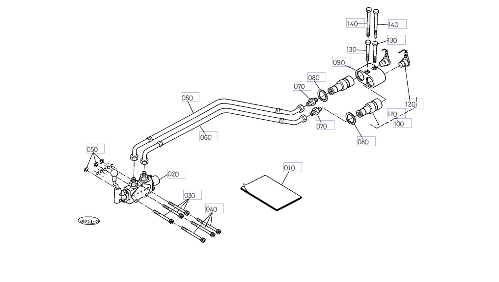

From looking at parts illustrations the L2950 block is not like the B7100 style.
These three illustrations show a spool valve sandwiched between existing hydraulic components.
This stuff is pricey, around $1,300 and worse no longer available.
As Torch said, pictures of existing might help. A description of what you are trying to do would bring more useful comments.

I have not checked the parts book descriptions but the pictures look like the remote is a conventional sectional valve. It is being fed from a diverter block (item 30 ) on the top of the hydraulic cover. No third line for tank return shown in that picture but Kubota sometimes puts that in a separate diagram. DCVs are typically left hand supply so pure WAG is pressure in is the left side pipe on the valve.

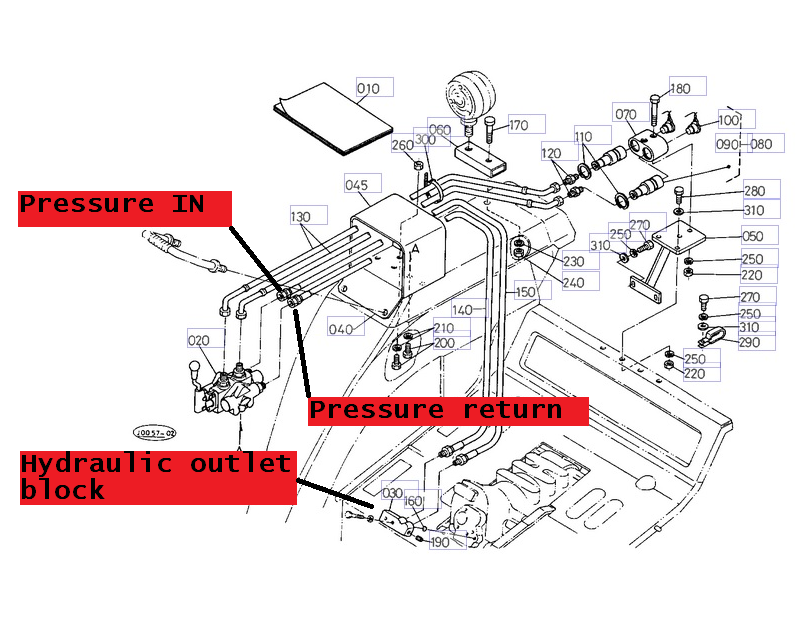

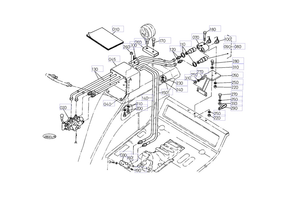

Looks like the main system pressure relief valve to me. Pump pressure in on line 110 and two lines from there to the rear. Number 140 supplies pressure to the 3pt/remotes and number 60 is a over pressure relief to tank. Very similar to the system used on the current L01s.
Edit" After looking a bit closer you are right - it is also a diverter valve. Probably used to supply the loader just like the L01 except it has a selector valve built in.
The remote valve stack (below) is fed by the two lines coming from the outlet block on the top of the 3pt cover. Now where is the tank return line for the remote valves?

This is quite similar to the set up on this tractor. It would appear that pressure is from the left side looking forward. I may be dealing with an aftermarket version of this set up.
12,990
7,355
OEM or aftermarket the pressure is coming from the same port on the hydraulic cover. That is the left one looking forward and also the left side of the valve looking rearward. Just out of curiosity does the valve on that tractor have a separate tank return?
