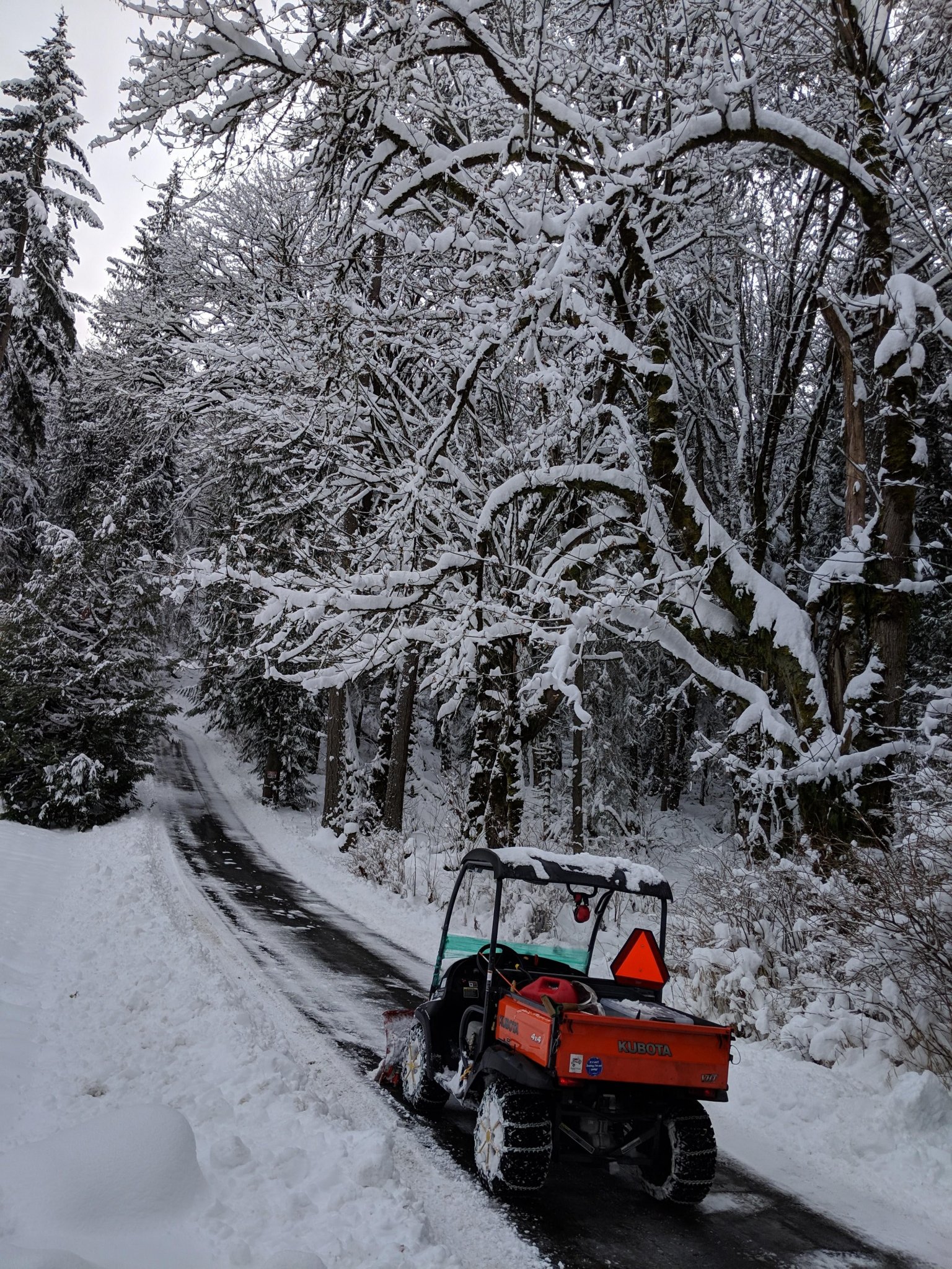

I'm looking for a hitch mounted spreader attachment to load with salt for the back of my RTV 500. The task is I've got over 1/3 mile and 300 foot vertical rise paved blacktop driveway -- we're at over 1,100 feet on a mountain. I've had the machine and the V4308 snowplow for over ten years and it is an amazing winter asset. I especially handles tough ice well when outfitted with the half hitch chains. However, this winter we have a construction project underway so others with 2WD will also need to get up the drive -- thus the need for the salt spreader. I won't be using it for seed or anything else.

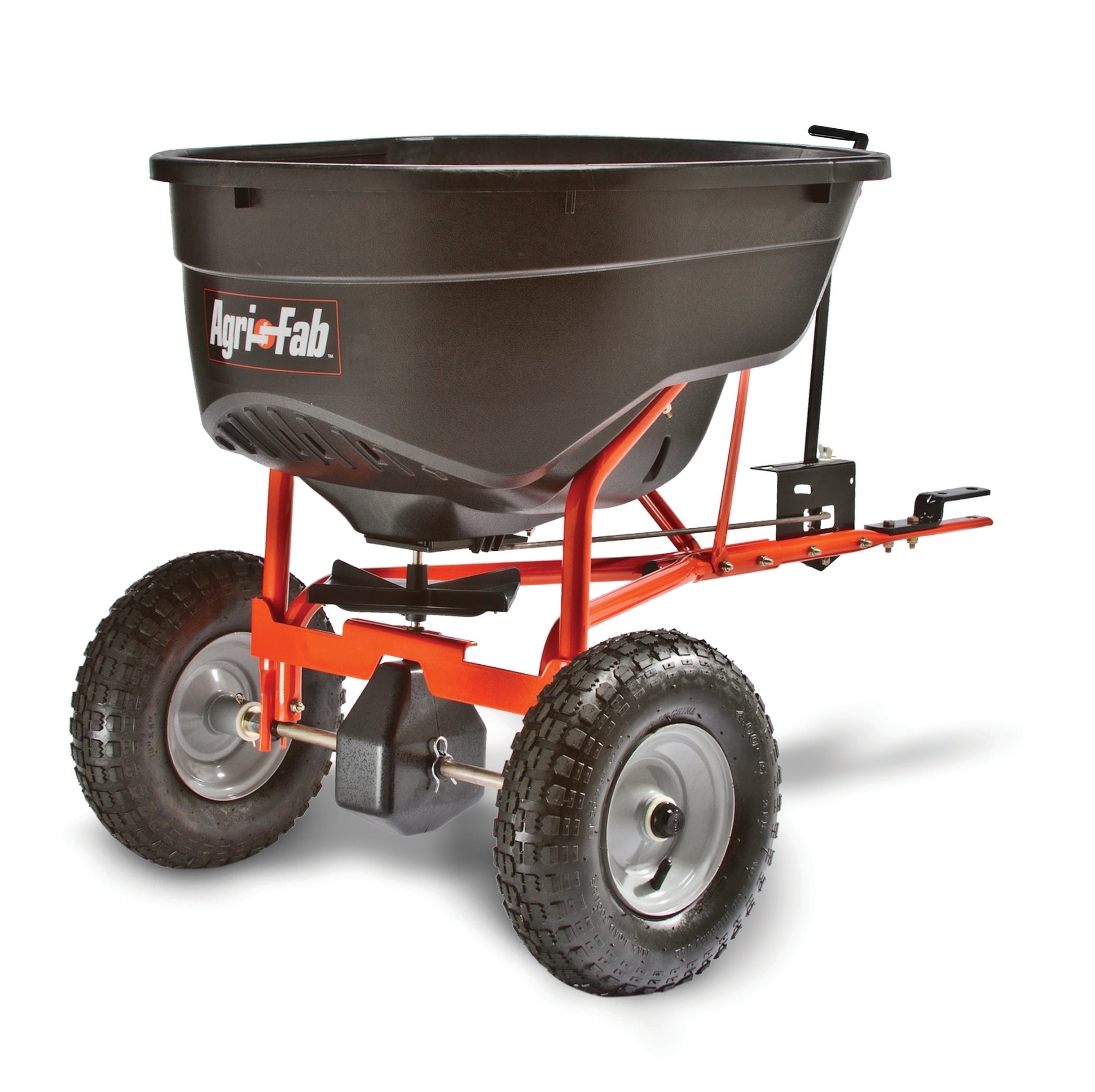

I second Big G. I had one (Agri Fab) pull behind 150 pound capacity spreader and sold it last spring after 10 years and it was still good to go. Poly hopper so no rust and the gearbox is axle driven but sealed in grease (on the high end ones).
Bought a 500 pound capacity 3 point pendular spreader for the tractor, poly hopper again, for fertilizer which is almost as bad as salt for corrosion

Thank you folks for the suggestions and input. I did rig and try one of the very cheap "Scott's" yard spreaders behind the rig last year. It worked to an extent but with the slick conditions, I found that the wheels simply didn't get enough traction to broadcast reliably -- much lighter than the rig you are suggesting. I was looking at the commercial hitch mounted solutions because when this driveway is slick -- it's really slick. Several times the RTV has spun around 360 degrees -- yes, even with the half link chains and very slow with the diff's locked. I've got 30-90 foot vertical drops beside the road, so anything that might detract from gaining control during even the occasional slide is unwelcome. I can rig a screen for the salt. BUT none of the commercial rigs < $400 seem to get very good reviews due to simple stuff (like missing an agitator for the salt, doesn't stop spreading when stopped, etc). The Moultrie with automatic open/shut and adjustable gauge seemed like the best on paper... Again, thank you. Pre-mixing the sand/salt and keeping it dry is a practical and strong recommendation. I'll do that too. Last year I finally resorted to a bucket sitting on the floor of the rig, with a hand spreader (gutter cleaning long tool). It worked, but with the freezing temps, couldn't keep the salt off the rig. Arrrrgh.

I have the following spreader that I have used for about 3 years now. I got it at Lowes. I pull it behind my Honda rancher ATV and it works fine. I've mostly used it for fertilizing pasture grass. It has always emptied and spread well. Ive had no issues with it aside from the tires did go flat once after it had sat for a while. Aired them back up and they have held so not sure what happened. I did make the mistake of not hosing it down good after spreading some ammonium nitrate, and it rusted it up quickly in a few areas. Using salt I would also make sure to to spray it down good when done. I would probably go with the agri fab that others have shared here over my john deere- its cheaper and looks like the identical thing nearly

I cannot speak to throwing salt (here in Alabama) but I have tried all of them for throwing corn--I throw about 600-700lbs a year for wildlife. By all I mean pull behind (4-5 of those), hitch mount and make one from a 5 gallon bucket and a feeder motor. What I can tell you is the pull behind (for me anyway) are junk. On the agri-fab, and most others the "gears" are plastic and in a month, if your lucky, they will be stripped.

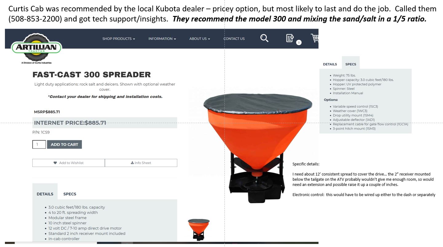

I DID find ONE hitch mounted spreader that looks like it would do the job : The Curtis Cab Fast-Cast 300. It's available through their Trillian Tractor Supply for an Intertnet Price of $885.71 -- which is a simply too much money for what I need to do. IF I were plowing sidewalks in Alaska every day or similar -- this would do the trick.
I'm going with one of the Agri Fab pull behinds and will just make sure I wash it down (as much as possible) during the winter after each use.
