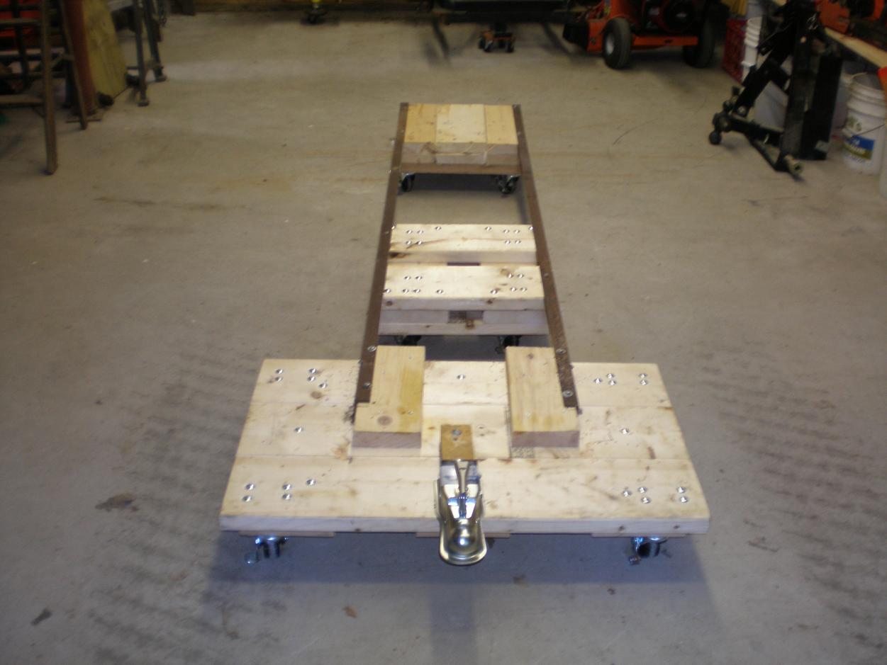

I plagiarized this idea and it works great for storing/moving/mounting my PHD:
https://www.youtube.com/watch?v=ecpHhyUAbc8
I used 3” square tubing to make the entire thing, including 3 uprights instead of the auger-surround, but otherwise identical (well...I refuse to paint it green!)
Works really well.
