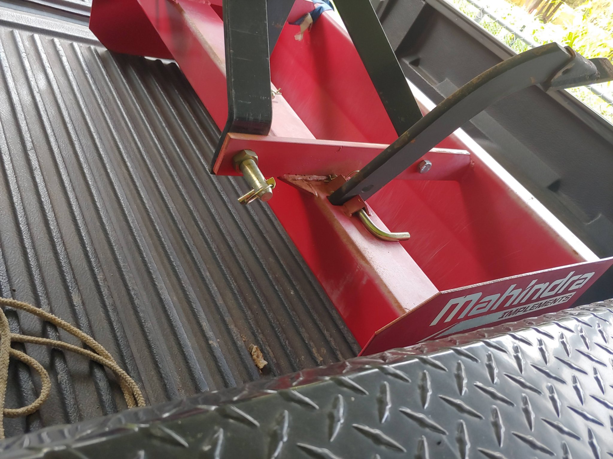

Well I have been looking for a box blade and they were all way expensive even for a used one
but today I may have hit the jackpot I found one for about 75% less than all the others I have
found. And it looks to be in great shape here is a photo it is a 4ft model hopefully the deal happens
tomorrow. Here is a picture

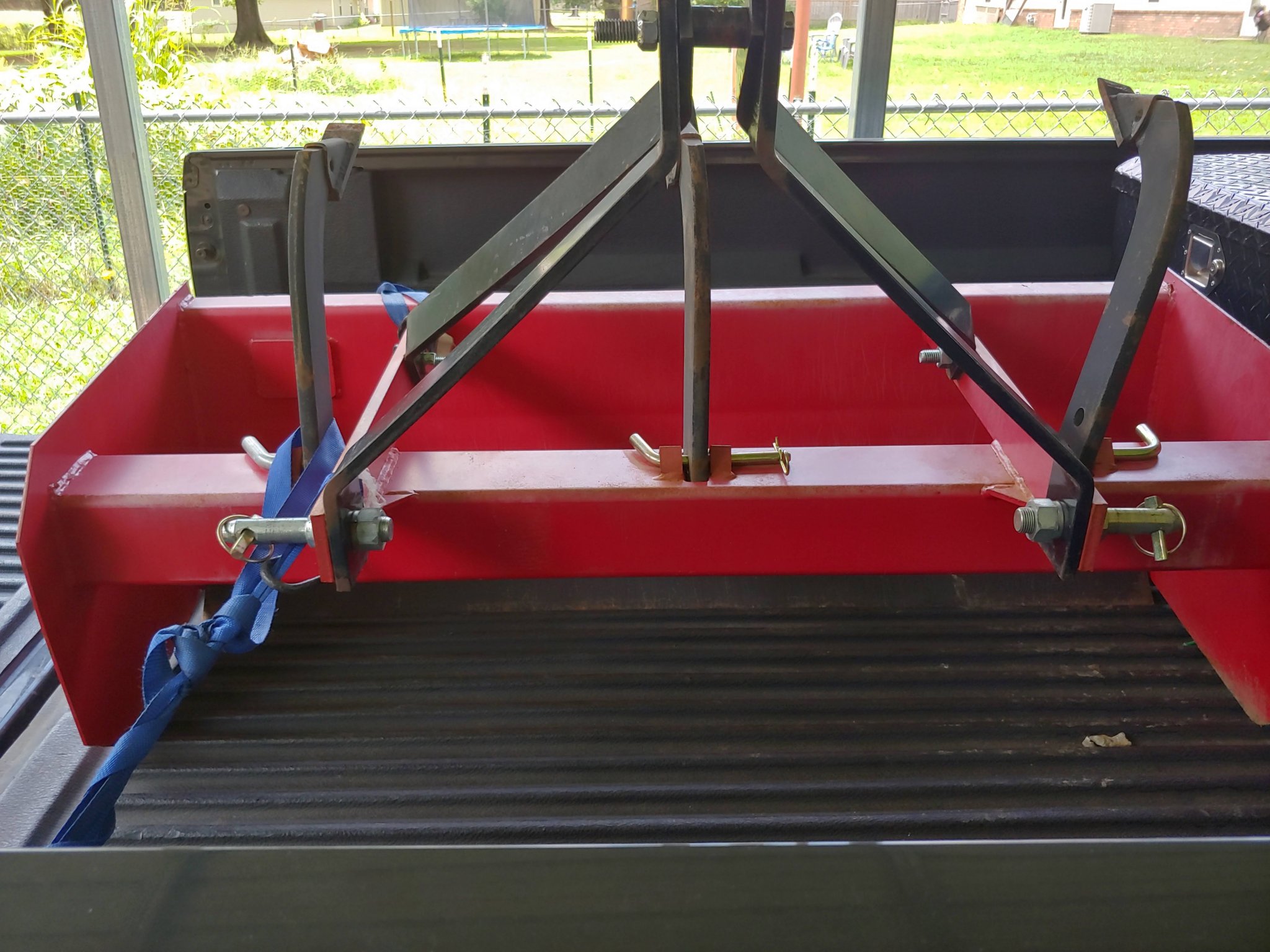

Well I went shopping today and brought the box blade home it was too good to pass up.
It looks to have been used once at most. Here are some more pics

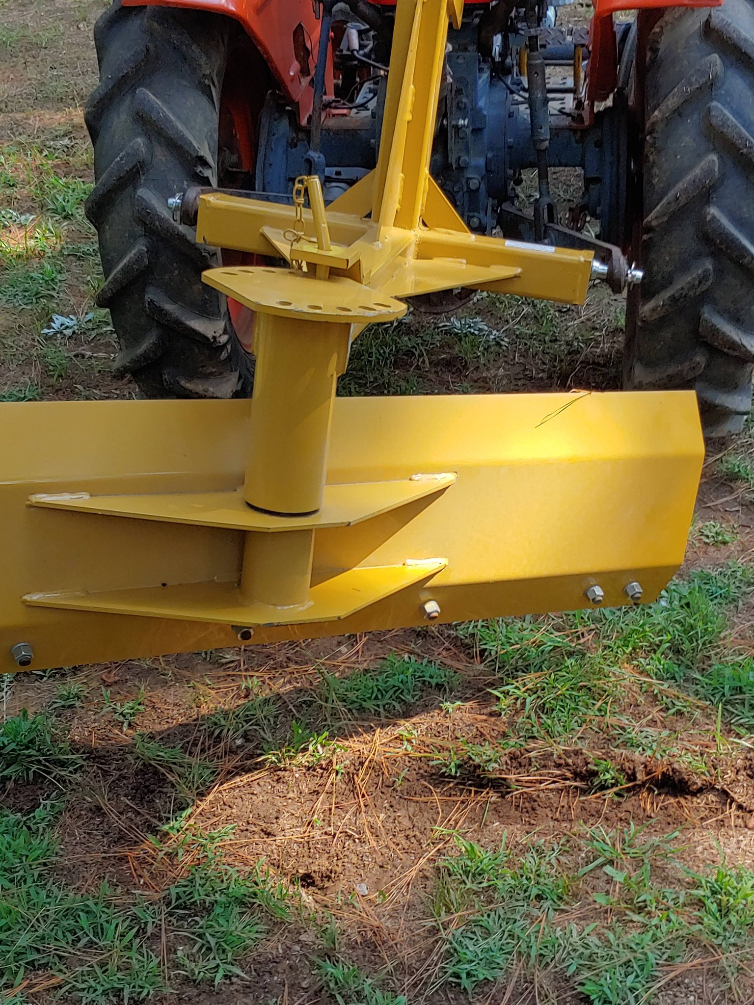

I finally picked up a blade today, ended up buying a new one made by Behrens. Tried it out for
2 and a half hours today worked great.

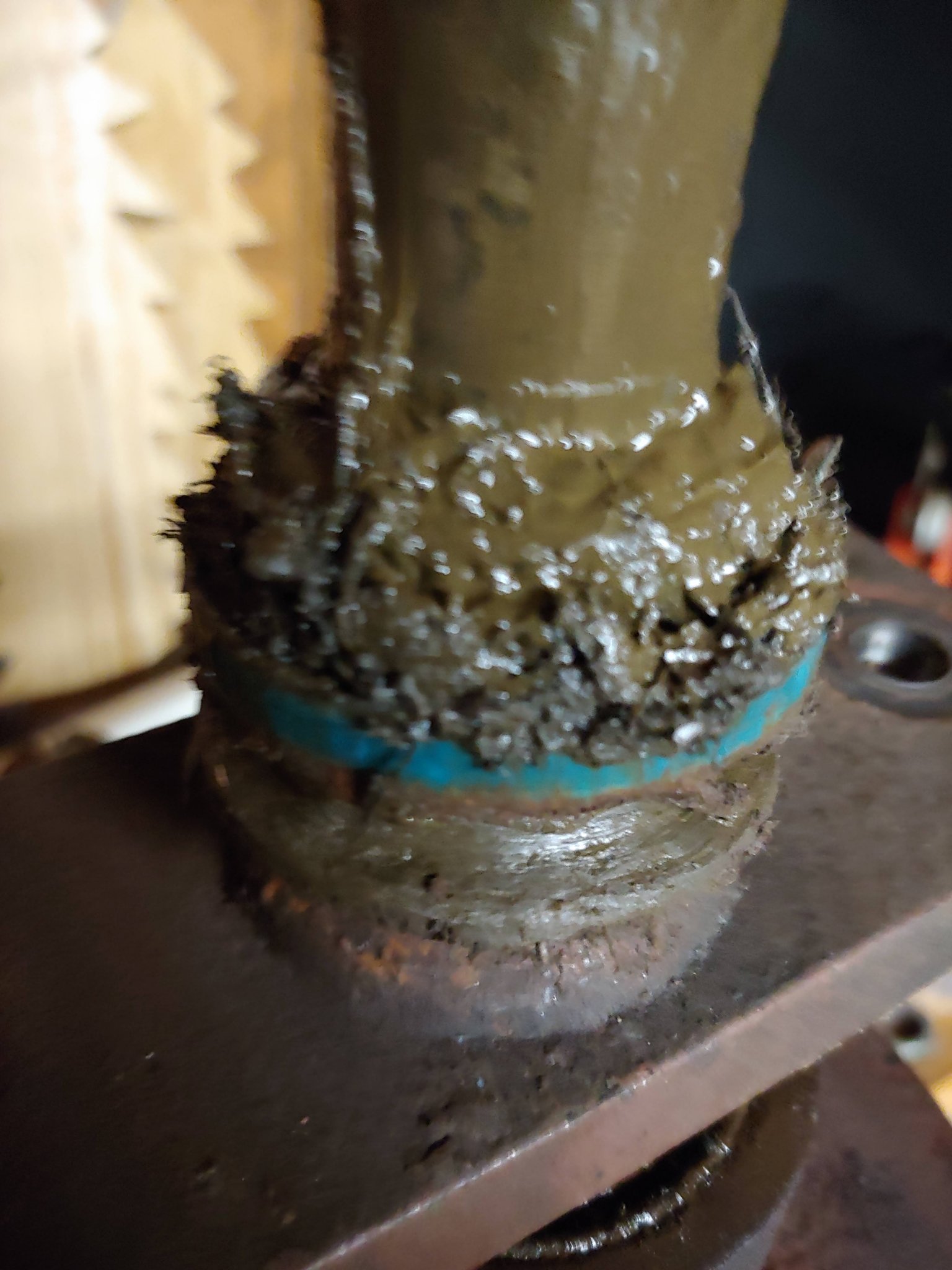

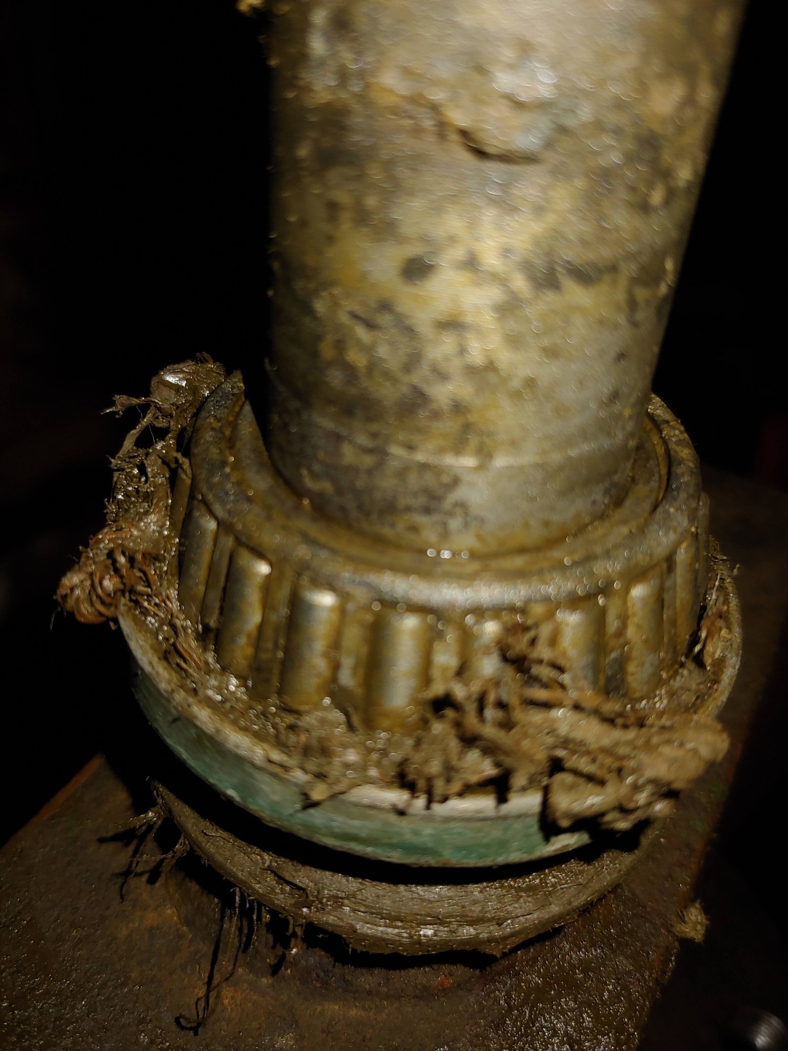

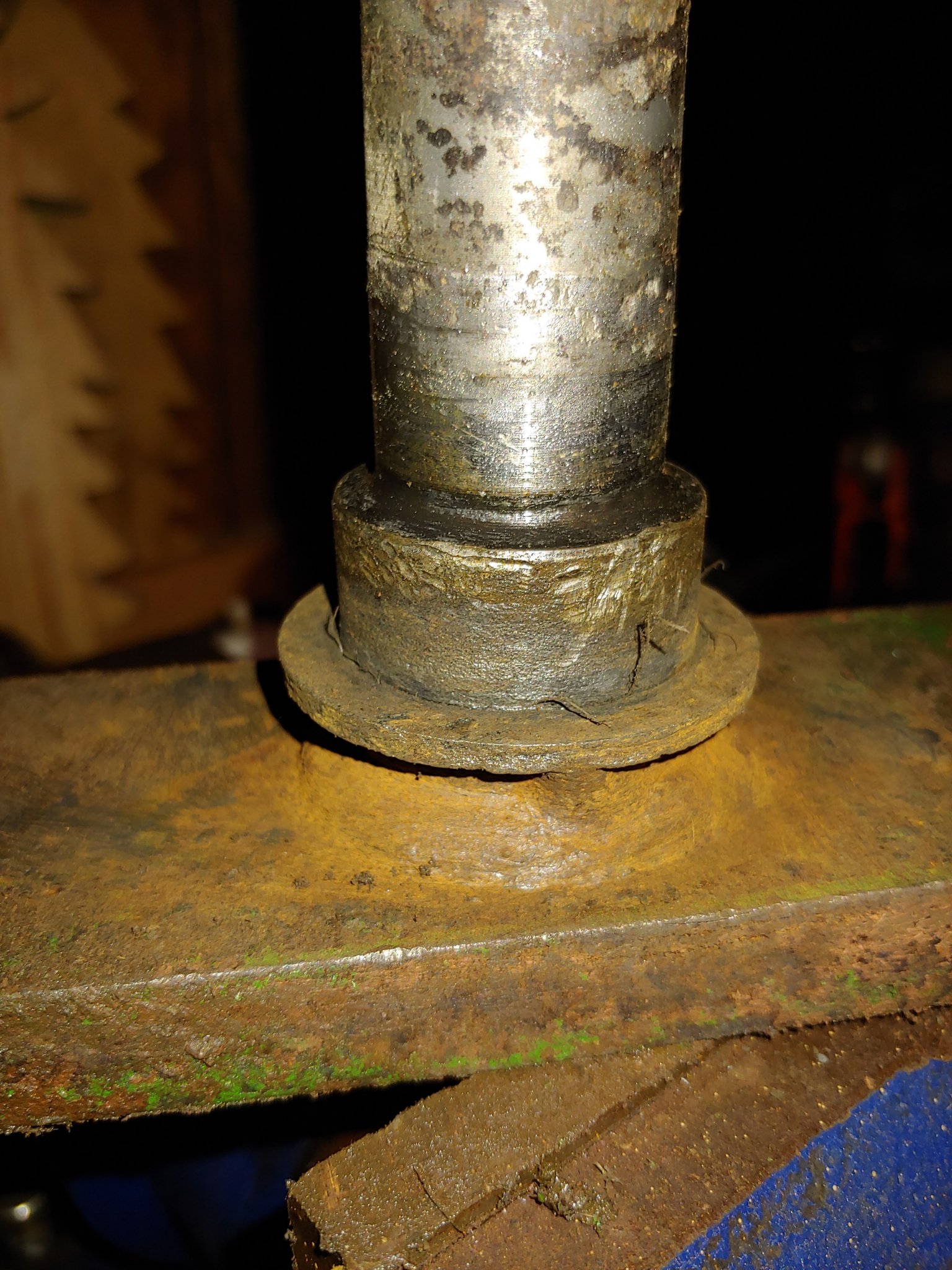

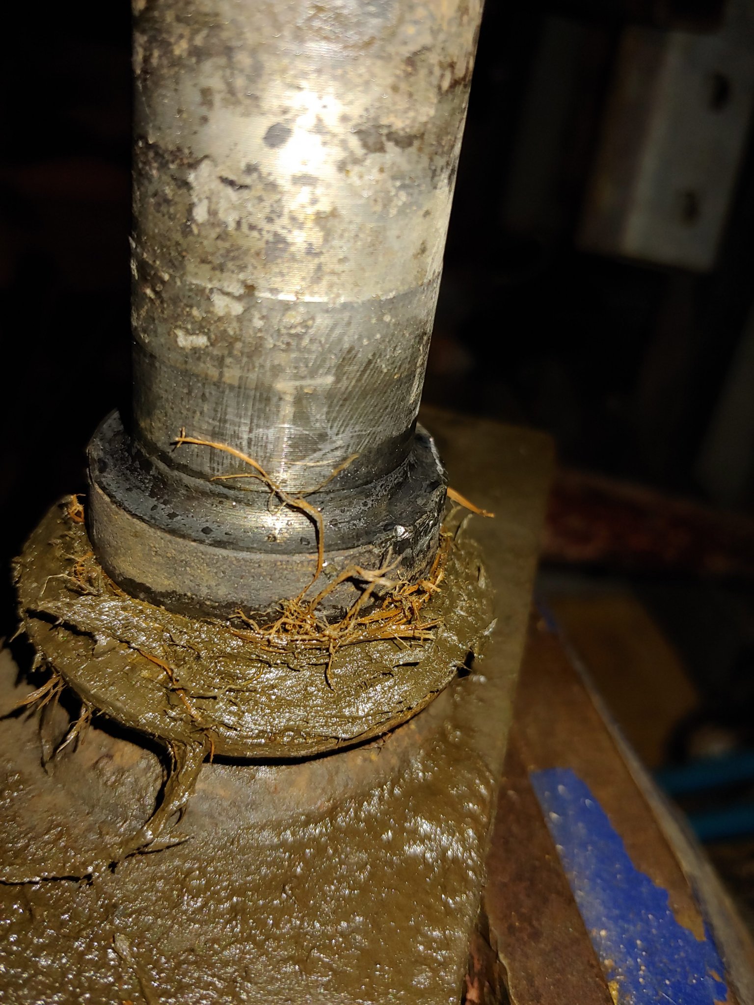

Well I determined the center spindle bearings were bad and had the spindle pressed out
and the bearings were full of poly twine and in really bad shape. I went today and picked
up a 20 ton press so I could get this thing back to work I tried to take it back by where
they pressed it out for me but couldn't get a chance to get off work to go by there, so
I just figured I needed a press anyway so I picked one up. I got it assembled this afternoon
ready for tomorrow. Here are some pictures of how badly the previous owner had neglected it
and the condition it was in. Hopefully I can get it back in shape.

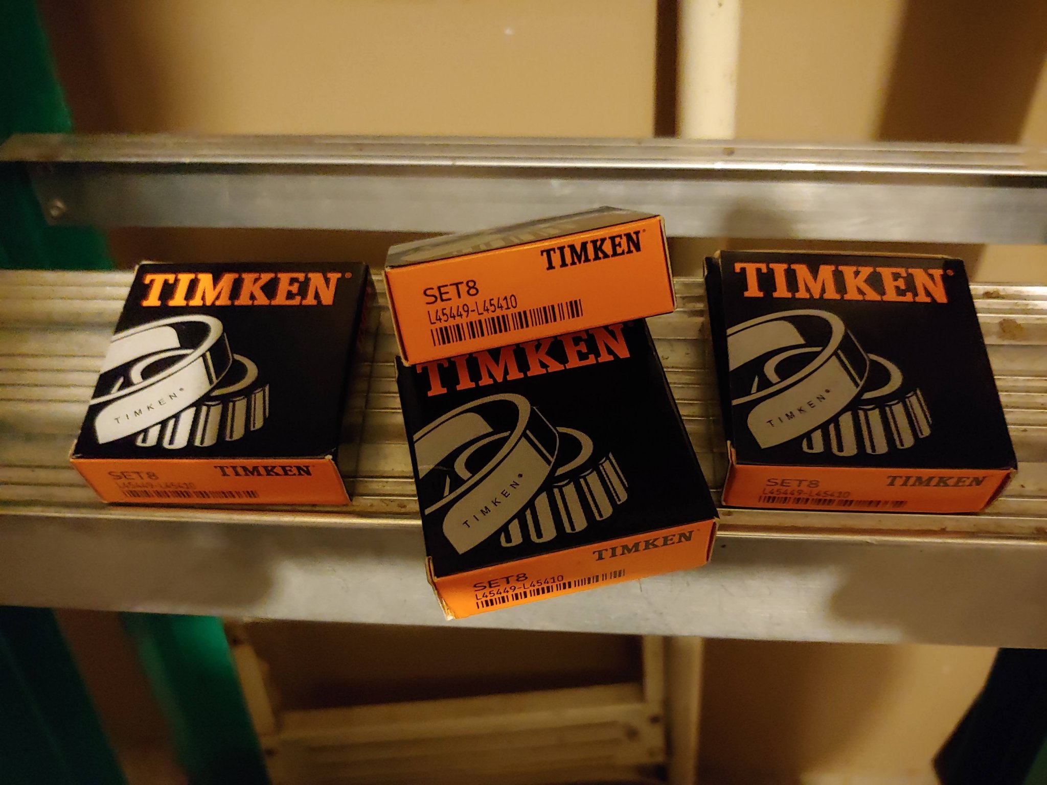

I got in the other bearings and seals for the mower the last few days so hopefully I
can get started on it and have it ready for spring.
Dave
these should fit most JD Friontier GM1060R and the 72 inch and maybe others also the woods PRD6000, PRD7200 not sure about the PRD8400 the seal number for these is SKF 14875 Shaft Seal, 1-1/2 X 2-1/8 X 5/16", Crw1, Nbr
