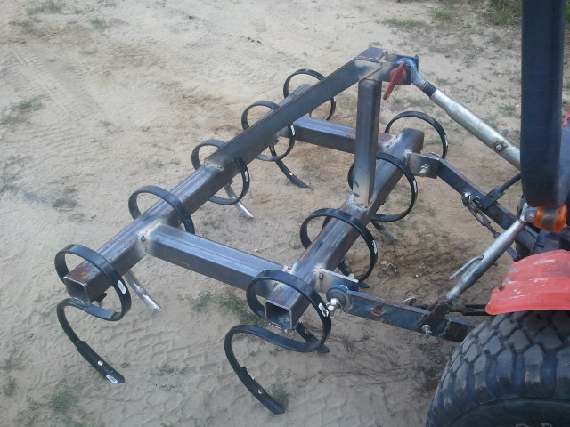

I had my B7001 Kubota stolen in January 2016 Chassi number 45582. They left the cultivator behind. Looking to attach cultivator to a Zen-Noh ZL 1801 DT. Does anyone know if a conversion kit is available. Appreciate any help.

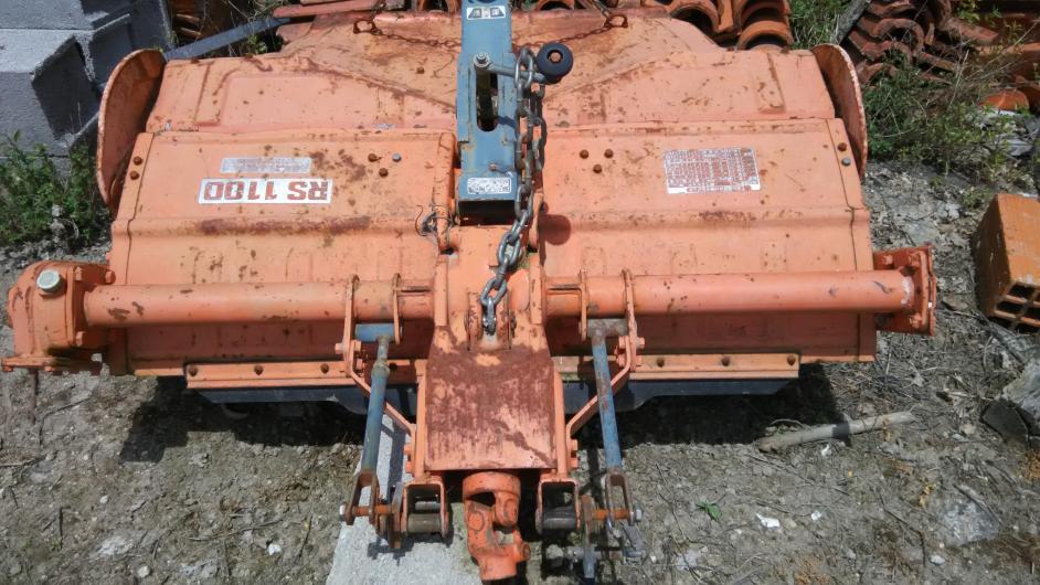

Post a picture of the cultivator if you would, that will help us all, if there is anything to be found out there for you. ;)
33,886
9,106
Yes that make things much clearer!
We call that a Rototiller.
We call this a Cultivator
Now onto your issue,
Sorry no they never made an adapter to my knowledge that would convert that model to a standard three point.
I would say you have 2 choices, sell that model and get a three point model, or cut off the mounts on that model and add a standard three point style hook up ( lots of work doing that)!
