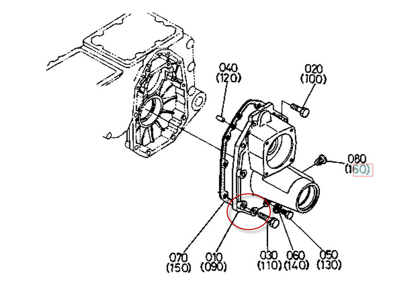

I have a B6200D with a few slow leaks near the rear end.
I have attached two example pictures, although there are a total of 4 leaks.
In each leak instance the leak seems to be specific to one or two bolts (see circled areas in red).

If it's just leaking around the bolt pull the bolt out, spray some brake part cleaner in the hole and on the bolt, put some Ultra blue RTV on the shank just after the threads and reinsert the bolt and tighten.
If it's leaking on a seam of the cases pull and install new gaskets or RTV sealer on the case flanges. ;)
