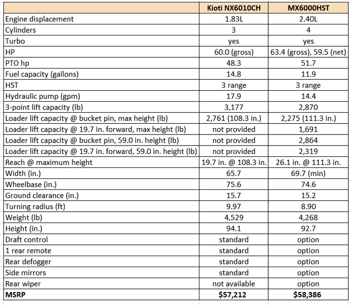

I tend to hear and read this a lot, that Kioti tractors have more and better features for significantly less money compared to Kubota tractors. I'm not that familiar with all Kioti models, but since I have an MX6000HSTC I figured I'd compare it to the equivalent Kioti model which appears to be an NX6010CH.
This is just one example, but the table below tries to make a fair comparison between the two models. If I add in the standard features that come with the Kioti to the Kubota build, and even include a rear wiper not available from Kioti, the price difference is only $1,174. Bare in mind that the Kubota has a 2.4L 4-cylinder engine putting out 63.4hp gross compared to the Kioti with a 1.8L 3-cylinder engine putting out 60.0hp gross. Which one should last longer and have more torque? Also, Kioti implies that only two rear remotes can be added compared to three rear remotes available for the Kubota.
It's hard to compare the FEL capacities, but notice that the Kioti L6010 has less height and less reach compared to the 1065A on the Kubota, so the capacity at max height isn't an apples to apples comparison.
I would still choose an MX6000HSTC over a Kioti NX6010CH, particularly given the insignificant 2% premium of the Kubota that gets you a bigger engine among other things.

Check with both dealers for actual pricing. For my Kioti I got a discount off the MSRP and then the loader price was deducted also with the current deal and free Rim Guard because they are a 5 paws dealer. . Was a really big savings over the smaller Kubota LX ( no other small cab models available) with sales tax included. Kubota just had a small rebate and no incentive for a cash deal. So far I am very happy with the Kioti and I would never go back to a rocker pedal. Some great Kioti incentives going on now for 2024 leftovers. You can get a Kioti RX7340 for 56k now.
I've never understood the issue with the Kubota pedal and have close to 350 hours with it and like it just fine. I only use my heel for reverse if I want to go fast. Mostly I simply use the top of my toes under the pedal for reverse with my heel on the floor. The L60 tractors do have a nicer pedal for sure and perhaps it would make a good upgrade.
As for the RX7340 which appears to be a good tractor, that $56k which includes a rebate excludes 0% financing so it's $60,500 for most folks. There's almost 10% sales tax in Tennessee which puts the price close to $66,550 at that particular dealership.
Obviously everyone should make their own comparisons and decisions, but I wouldn't buy an NX6010CH over and MX6000, even if I was making that decision today.

By the way, Kioti shows an MSRP of $67,778 for the RX7340 and Kubota's M7060 with features like creep range, 540E PTO, air ride seat and rear defogger added on to make it equivalent to the Kioti has an MSRP of $65,082. The Kioti is a new build and the M7060 has been out for quite a few years so arguably the Kioti is the "nicer" tractor, but I gaurantee there isn't a thing that the Kioti could do that the Kubota couldn't.

As far as lift range on the FEL the Kioti looks like the pins are closer to the machine. Seems like Kubota is about the only one that pushes them out farther maybe giving you better stability at high heights?
Depends on the loader you choose on mine. I went with the 4030 loader that gives over an extra foot of reach at dump height with a slightly reduced capacity. The 4030C loader option had less reach but higher capacity. Talk to your dealer about options, capacities, and breakout forces.

This thread is in reaction to YouTube videos from Good Works Tractor Co. and others, as well as some comments on this forum that seem to imply that Kioti tractors are a lot cheaper and have more desirable features at a lower price point. It would take time to compare every model in the Kioti and Kubota lineup, but I'm seeing prices being much closer than implied, even when adding in optional features on a Kubota that might be standard on a Kioti.
A shed by the side of the road isn't a proper dealer in my opinion! Kioti might claim to have 50% of the dealers that Kubota has, but every Kubota dealer I've seen is a proper building with proper maintenance and repair facilities, and a showroom. More smoke and mirrors.
As far as I can tell, a rear wiper isn't available on the Kioti NX6010CH, even as an option, and that would be a big problem for me when using the snow blower. I often need to use the rear wiper on the MX when blowing snow. I'm planning on upgrading the rear glass on the M6060 to the version with the defroster, and getting the rear wiper option too. There are times when I could have used a rear wiper this summer when pulling the folding cutter around.
Does your tractor have a rear wiper, and if not, is one available as an option?
Yes they come standard and are not an option on mine. Also has the defrosting grid plus adjustable heat vents. Only the front windshield wiper has the squirter for cleaning though. I found turning on the ac compressor with the heat removes any interior fogging quickly. Very comfortable cab
I also have replaceable dust filters on the fresh air intake that make it safe for dusty conditions but they are not rated for pesticides or other toxins. Lots of standard features that are not shown in their advertising. The only thing that stinks are the cheap little stereo speakers that sound tinny. I'm looking for replacements now.
Thanks for the clarification. My MX has windshield washer fluid nozzles front and back along with rear defrost, and the M6060 upgrade is the same. I would hate to be running the rear wiper in dusty conditions without fluid.
