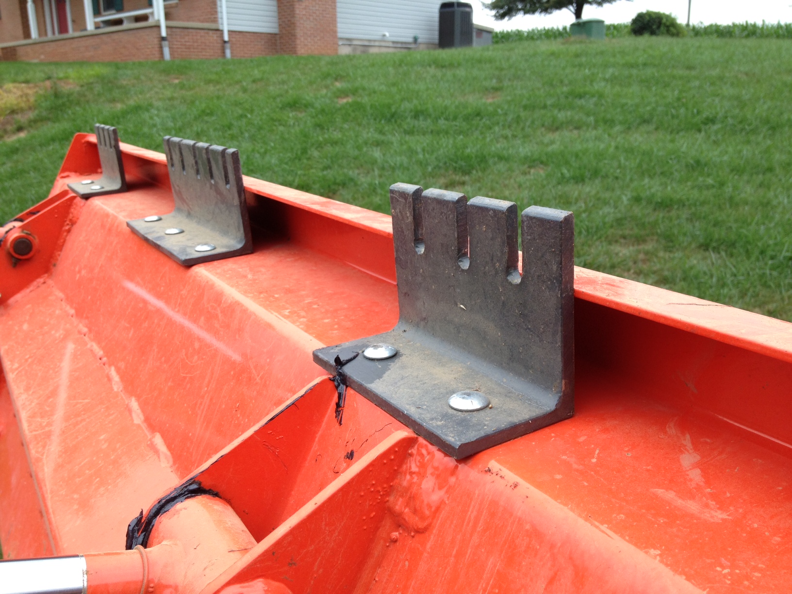

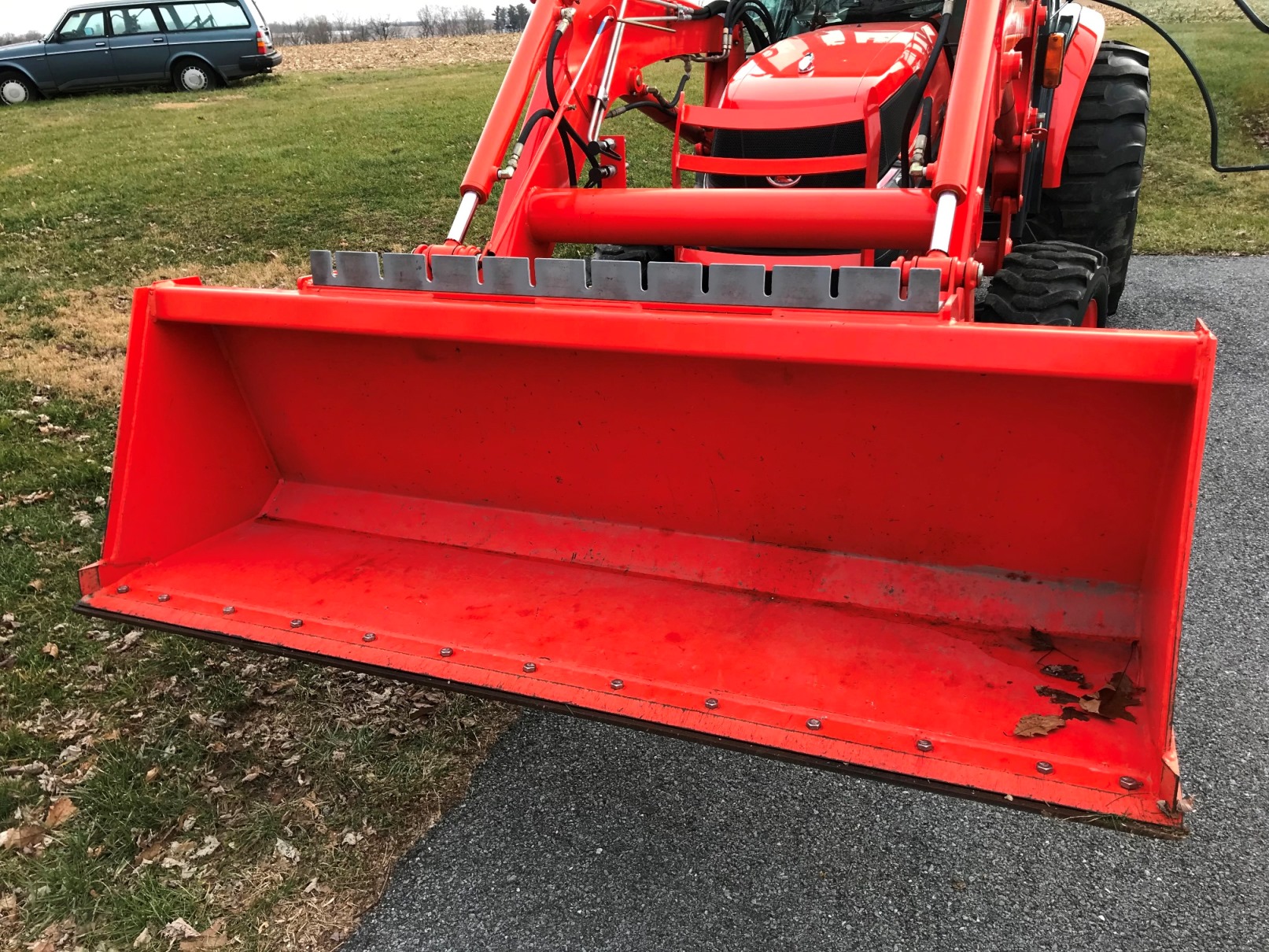

I've been going a different route since getting the first Kubota back in '02. With minimal tools (a drill and a hack saw would do it) the buckets have been equipped with angle iron with slots cut into it. One benefit is being able to run chain in front or behind the bucket, and to drape unused chain out of the way by dropping it into the extra slots.
In recent years I've been using 1/4" G70 chain more frequently than 3/8". It's nicer to work with and still has 1.5X the WLL than the FEL can lift. Another useful thing has been the couple of chains that I replaced the grab hook on one end with a logger's chain hook (like a slip hook but it stays in place).

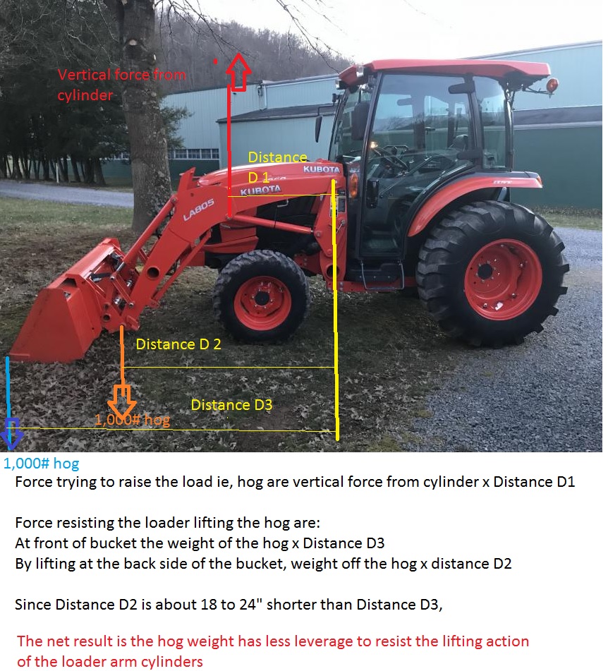

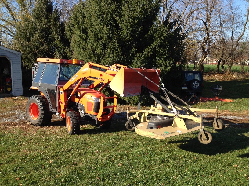

Putting aside brand of hooks, I have mounted two hooks in the center of the bucket with one reversed compared to normal one.
If I am trying to lift something that is on or over the limit using a chain running over the cutting edge of my bucket, I run the chain down the backside of the bucket. This moves the lifting point IN and increases the load I can lift by a substantial amount.
