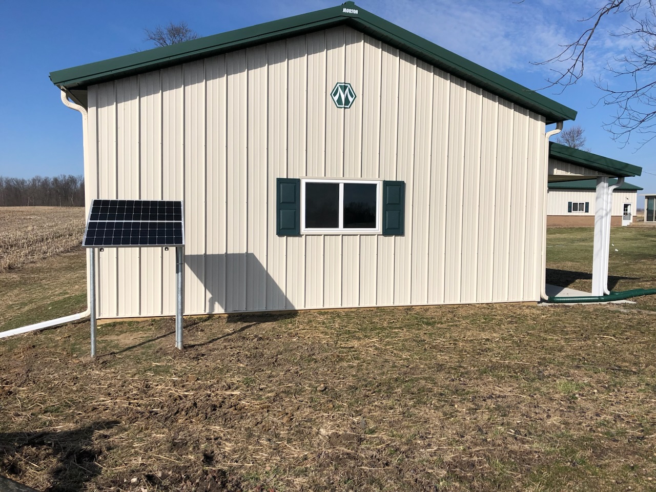

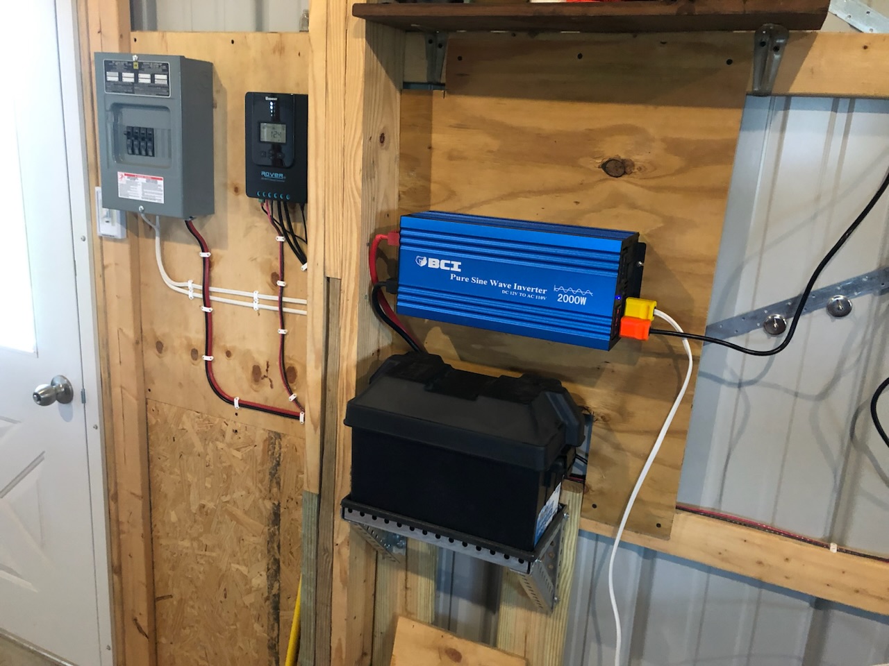

I have a solar setup in my 24’ x 24’ barn. The system consists of: 2- 100W mono crystalline panels, 30W MPPT charge controller, group 27 deep cycle marine battery, 4,000W peak/ 2,000W running pure sine wave inverter, Square D QO series box and breakers (QO breakers are actually rated for DC voltage) wired 12V from the battery, 14-3 romex wire, porcelain bulb bases, and 12V LED standard base bulbs. The way I have it wired, if I ever run power from the house, all I would need to do is change out the bulbs and add some outlets.
