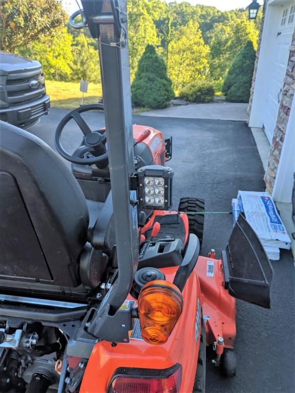

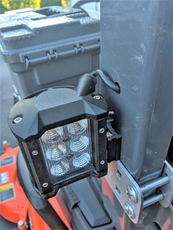

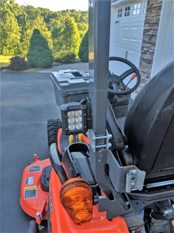

I found that seat level lights work well for my reverse lighting. Since my ROPS has holes in it from the factory I mounted the lights where you see them here. I bought two sets of these lights on Amazon. One set is a flood pattern, the other set is a spot pattern. I mounted one of each type on the ROPS and the combination really provides a nice balance of lighting around the whole rear. The only downside is I have to remove the slow vehicle emblem because it partially blocks one of the lights.

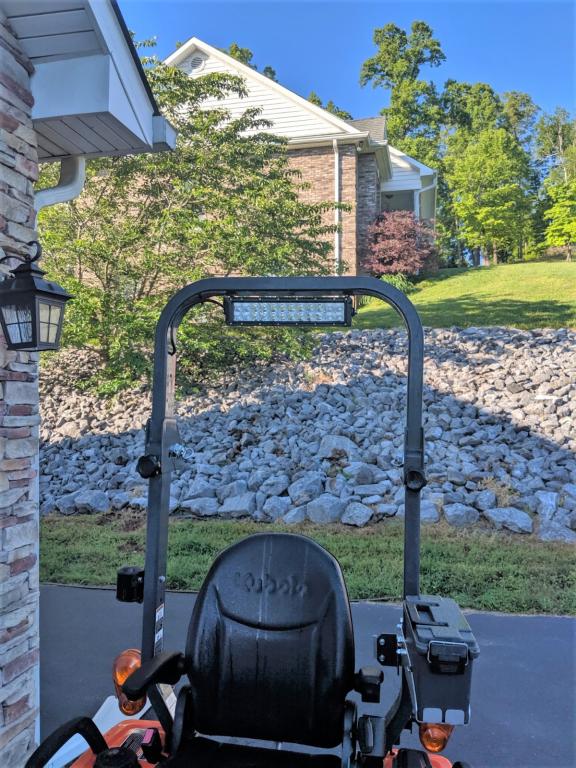

For forward lighting I used a more aggressive approach - it's a 12" LED lightbar. I drilled and tapped the ROPS for two 1/4"-28 bolts to mount it, used some blue Loctite and it has stayed in place perfectly.
Because I use my BX in the woods for preparing deer plots I was concerned about exposed wiring. I routed my power wiring within the ROPS as much as possible, wrapping it in corrugated loom, wrapped in TESA tape at the flex joint in the ROPS. So far it has proven durable.

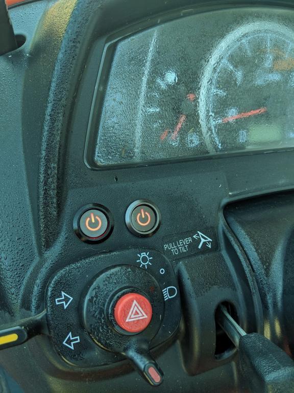

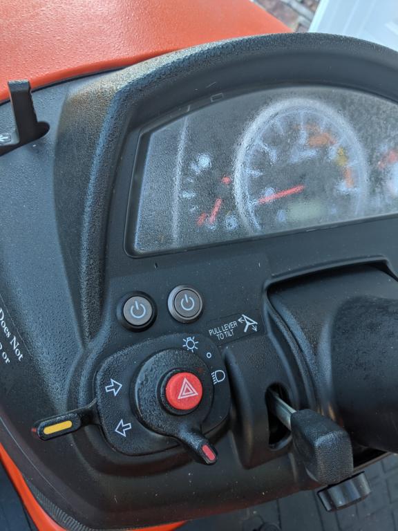

I found these power switches at Advance Auto Parts. They are wired so they are blue when the tractor is running and they turn orange when the lights are on.

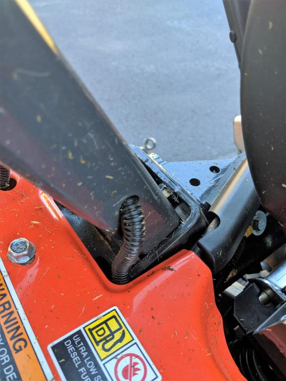

Loudon, TN
Here's where I routed the power into the ROPS, using a factory hole.
Here's what the light switches look like when the lights are energized.
Sorry about the dirty / wet tractor. I finished bush hogging the back property last night and am going to wash it later today, after it warms up a bit. 35 F here this morning.
