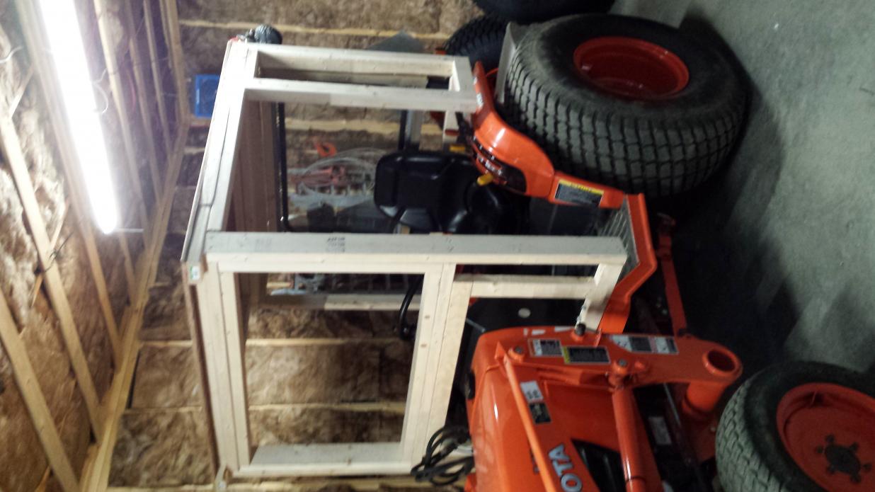

Here's a few pics of my homemade cab on my B7800, purely for function and not looks lol but it keeps me warm and dry and cost around $800 Canadian for everything.
For some reason these pictures rotate when uploaded, they are in the proper orientation prior to uploading. Not sure why this is happening.
For some reason these pictures rotate when ploaded, they are in the proper orientation prior to uploading. Not sure why this is happening....
actually what you see here is EXACTLY how they exist where they are stored (phone? Tablet?) BUT they are also stored with EXIF data.. which tells what end is up. Tablets and phones can read EXIF..... forums can not. See https://www.howtogeek.com/254830/why-your-photos-dont-always-appear-correctly-rotated/ for more details.
one solution is use http://onlineexifremover.com/ to remove EXIF data. Save this new file. open it with a picture viewer that has a tool to rotate left or right. Do so and resave. Use that image to post in forums.
While your at it please consider a build thread on your cab. Looks great.

Yes mopar I put in a heater. I hope to get the pictures rotated correctly tonight and I'll post some pics of the heater, it's actually on the site.
If I can help in any way I'd be more than happy to help but I'm only an amature....lol
