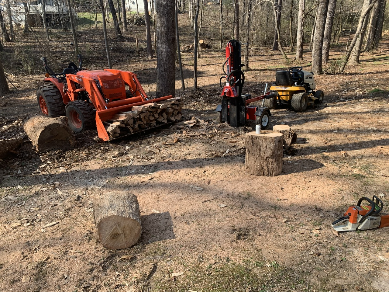

I have to feed a stove in the house, greenhouse, workshop and the maple evaporator. A good amount.
Thanks for all the input. I'm probably going to go with a standalone. If money were not an issue I would go with a nice 3 point setup
I think you will be happy with that decision.
If you ever wear out the engine you could replace it with a single cylinder diesel:
