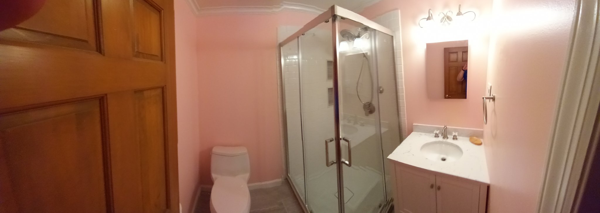

Finished ! Shower is subway tile, niches have floor tile backs and marble sides. Shower base has 1X6 white marble added for more 3d look. Shower doors slide like barn doors. New plumbing from basement up. New wiring/switch for vanity light. This guy was great. More important... wife is happy. 13K-15K

Resurrected my old thread.
This is the upstairs bathroom almost done. Needs a door on the shower.
The downstairs bathroom and laundry room will follow in a few weeks if the Mrs. doesn’t do me in before then….

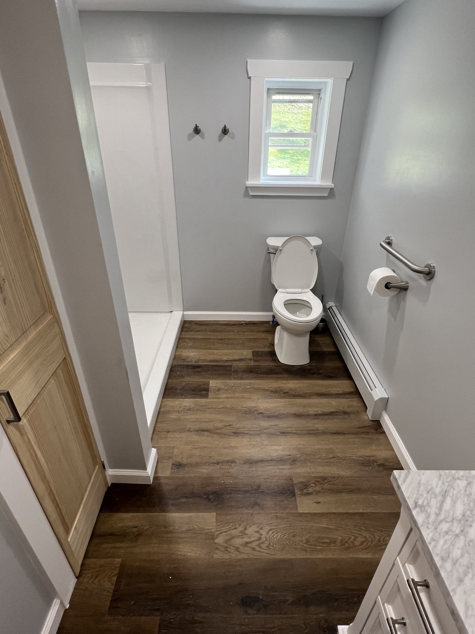

We're getting close to the downstairs bathroom being done.
While not ADA compliant, we tried to get it MUCH more accessible than before. Clearance between vanity and wall is 36”, but entry door is only 32. That’s the best we could do.
This bathroom was done 25 years ago with a tub/shower and very tight confines. I think entry door was 30", and clearance was less than 20" in one spot.
We’ve had several knee, foot and neurosurgerical procedures over the years that caused real challenges for family members to access the bathroom. Was our only full bath for 33 years.
This should make things easier, and the Mrs. and I are not getting any younger…

Have you considered a split folding door for the bathroom entrance? It might be too late to make the change, but it is a suggestion for others who might read this thread in the future.
Speed25
L2501(sold) - BX25D
Apr 23, 2024
353
538
NC
Keep in mind ADA only requires a 32" opening for bathrooms. A 36" hinged door is usually used as the 32" requirement factors in the door jutting out into the opening when opened 90-degrees. A 32" pocket door or barn door will meet the requirements as there's no door impeding the clear opening.
