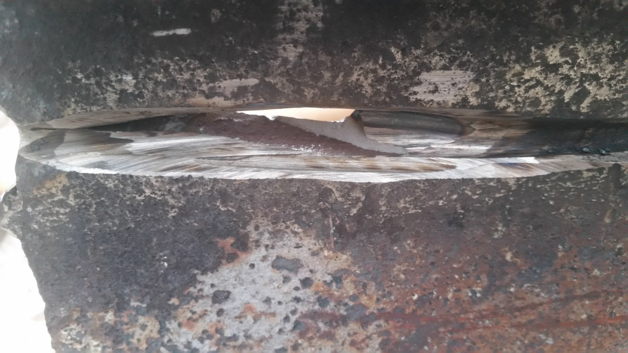

I tried to quench my other anvil and it cracked. Turns out quinching didn't crack it, the crack was was already there. Quenching made it bigger.
Then I got to grinding and found a chunk with rust inclusions. The crack had been there for years. Before quinching it was maybe 2 inches long and went through the spine.
Quinching made it bigger.
Had I been looking I could have found it and fixed it while it was small. But I didn't.
Nothing my little 9 inch 240v grinder couldn't take care of.
