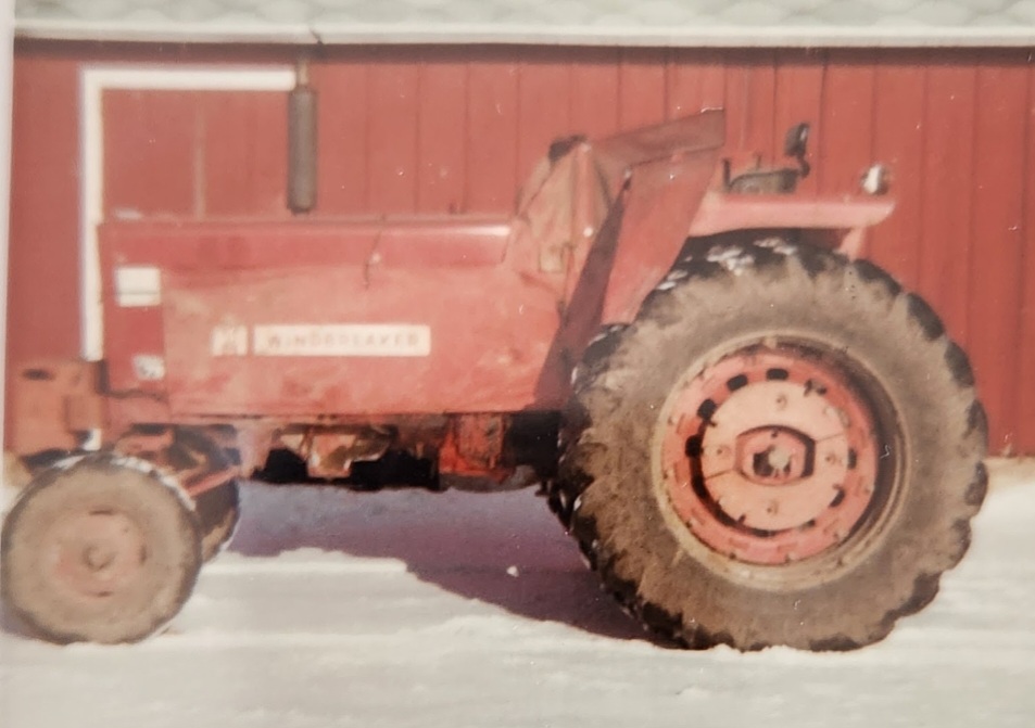

Growing up we had a heat houser on some tractors. It covered the block keeping it warm and also directing some of the heat towards the operator.
