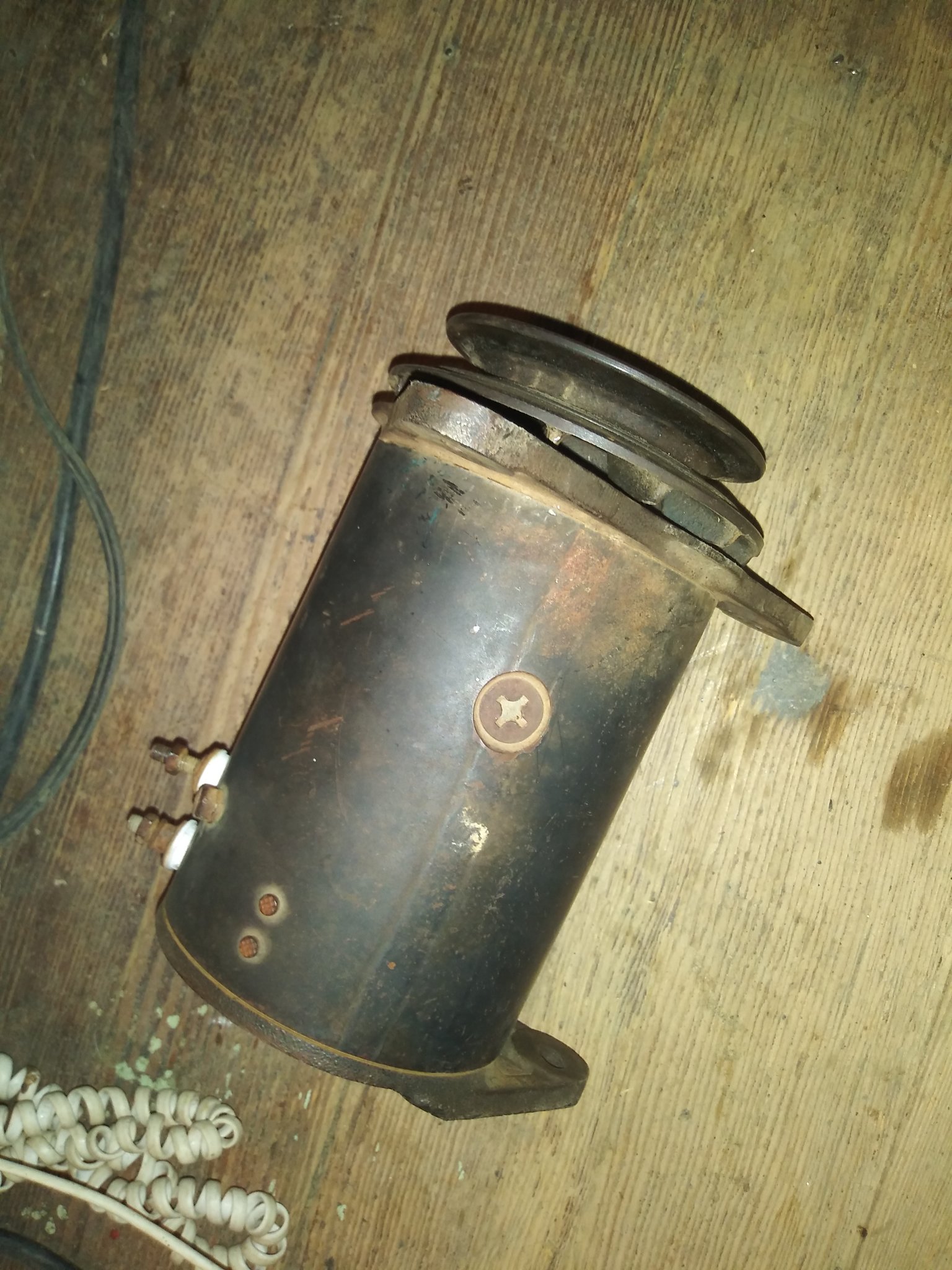

I recently got an old Kubota L200 from 67 or 68 gray market tractor given to me . I did the research to find its serial # and production year and the whole gray market thing . Anyway , it was sitting for years , but i got it started and home . I used it to load all the tools ie mower rototiller both pto driven . The double plow , and grader . The disk is on the rear 3 point and it has a front loader . I changed the engine oil the trans oil the hydraulic oil and diesel and replaced it . Replaced the battery too . Battery doesnt seem to charge . While messing with the generator i dropped it like i do everything due to carpal tunnel and broke one of the electrical hookup posts . I have seen many that have an alternator upgrade . Where does one get the kit ? Id like to put a lightbar and maybe some speakers on it so id want a higher output alternator than 14.5 volts ? Any help would be apreciated , im stuck .
The voltage will be the same regardless what capacity alternator you decide on. If you have an auto electric shop in your area, they might be able to repair what you have. If you replace all the lamps with LEDs, you might not need higher capacity, it is simple math to add up the total load. If you want extreme output from the speakers, that might be the biggest load, first I wouldn't do it and second, stay away from my house.

I just need something these original generators are impossible to find . Thats why i want an alternator for real . I dont have to put anything extra as far as power drag accessories but i do need it to charge battery , the old one has a noisy bearing on the pulley as well . Id like a new one but from my research an alternator may be better and easier

If anyone can find the NIPPONDENSO generator ill take it . Otherwise im in need of an alternator conversion kit that has a mountvplate that fits my tractor the alternator and the tensoin botl bar . it would have to be wired for an alternator plug as opposed to generator posts as well . I believe it has a different belt too .

most of the one-wire alternators don't charge at low speeds. So typically on vehicles that are using them (since I'm more familiar with one-wire kits on vehicles than tractors), you get in hit the key, let the motor start. Then, after you look at the volt gage, you see that it is still not charging, so you have to "blip" the throttle, which increases rpm, then it starts genning. Normally on the GM style 1-wire, it's about 1500 rpm give or take. There are also some Ford 3G style one-wire stuff that really isn't a dedicated one-wire, however it does only require one wire to work. Unfortunately you also have the issue of it constantly charging at high amperage rather than using the voltage sensing circuit which varies the output amperage.
For those reasons, the Denso style alterrator is your best bet if you must convert to an alternator. The original style generator works fine for 99% of users, and it's dirt simple, and very very easy to repair should the need arise. This doesn't account for broken lugs, etc of course--just the bearings because most of the time that's all that ever goes wrong.
With that said, when converting to Denso style, you will have to do some wiring changes and all the wiring you need will be at the voltage regulator EXCEPT the actual charge wire from the large lug on the back of the alternator. The charge wire needs to be upgraded according to the amperage output of the alternator; many are up around 40 to 50 amps, and we should assume that it will charge at 50A, so that's roughly going to be a 8ga wire. That wire goes directly to the battery or to the starter, and make sure to put a 75A fuse in that wire close to either the starter or battery so it doesn't short out and burn your tractor down.

I have the original NIPPONDENSO . I dropped it and broke a post that the electric goes to . These are impossible to find . The part i am most worried about is the mounting plate/bracket that fits the bolts and holes to attach to the tracror but fits an alternator that is half the size lengthwise . That being said you cant just put an alternator on . I have seen pictures of the old L200 with alternators and have also seen conversion kits and videos but not for my specific tractor . Sites like ebay and Amazon throw alternators when you enter the tractor or nippondenso # 027000-138 but lets remember the whole gray market thing and that NIPPONDENSO is Made In Japan .

Just stick a gm 12si on there like I did with my L185.
If the L200 alternator setup is like the L185 then you have an external regular setup. Once you rip out the alt and the regulator wiring you are left with 3 wires, a slightly thicker like 14 or 16 gauge battery charge wire, a 12v on signal and an alternator idiot light wire.
Take the L200 battery charge wire and trash it, it's too thin. Go with a 10 gauge wire if you use a 10si and 6 gauge if you use a 12si. The 10 and 12si use 2 other small signal wires. A red voltage regulator wire, simply connect it to the + side of the battery, as close to the battery post as possible. The other wire is the alternator light wire. Rewire your alt light wire by connecting the light to "key on 12v power" and connecting the "ground side of the light" to the 10 or 12si white wire.
Done.

A car electrical repair shop, one that rebuilds starters and alternators CAN fix the genny. Sounds like you broke the plastic insulator, and that's easy to replace, as are the bearings. do this and it'll outlive you, me and the cat. It's the simplest way ,NO rewiring solution,maybe $100 . Bodging ANY alternator will probably cost you more it parts and rewiring and downtime.

I agree with others who suggest FIXING the dynamo instead of converting to Alternator. A dynamo is pretty much bullettproof and RARELY break (unless it is dropped :))
This is based on your requirements:
As you replace the incandescent bulbs with LED's.... your power requirements will go DOWN because LED's do not need as much current. This provides enough current for your speakers. (although headphones would be better when running tractor)
