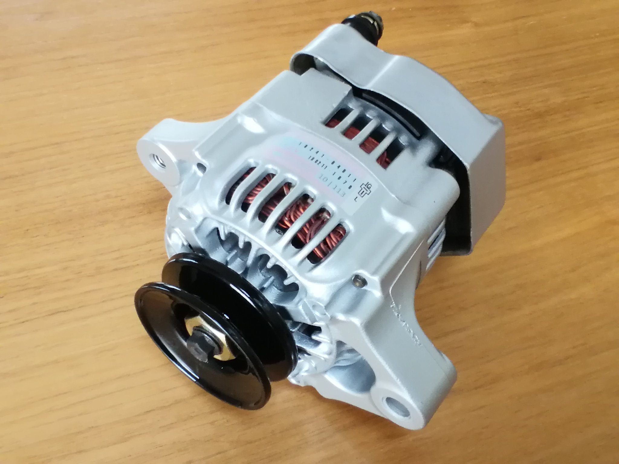

Hello Jake,
when I type kubota "bx25d" alternator as search words on google or other search engines lots of realistically priced alternatives show.
Also brushes, slip rings, bearings, voltage regulators are available as spares on alternator spare parts web sites. I refurbished mine, which I believe is similar to yours, for very little money.
Link Generator disassembly
Link Generator testing
Link Generator assembly
I did not replace slip rings and brushes because they were still good but I bought the parts for future repairs.

I can accept that your shop said he cannot rebuild it. But I do not accept that this is due to parts not being available, as somebody earlier suggested. Those generators were built by the millions and aftermarket spare parts are available, you just have to search for them.
Also complete aftermarket generators are available between $65 and $180. The Kubota price is way off in my humble opinion.
