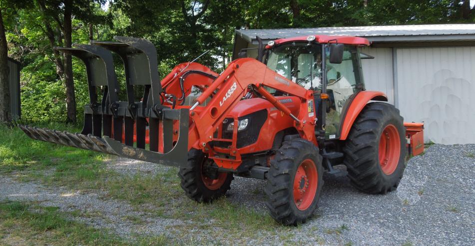

I truly love my L5740 and really like the MX5100, but feel the M Series is the ideal companion tractor to an L, GL or even MX. Once you spend a full day mowing with an M, you will be hooked.
The hydraulic shuttle-shift is great for loader work as well as everything else. My sons and I often use the tractors together and they can keep up with the HST doing anything.

I'm with ya man, the mass & weight of the M is also pretty impressive. Also notice how huge the front axle is on the M. :eek:

Yep, hard to beat the M Series when you absolutely, positively have to...
