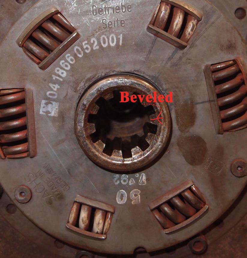

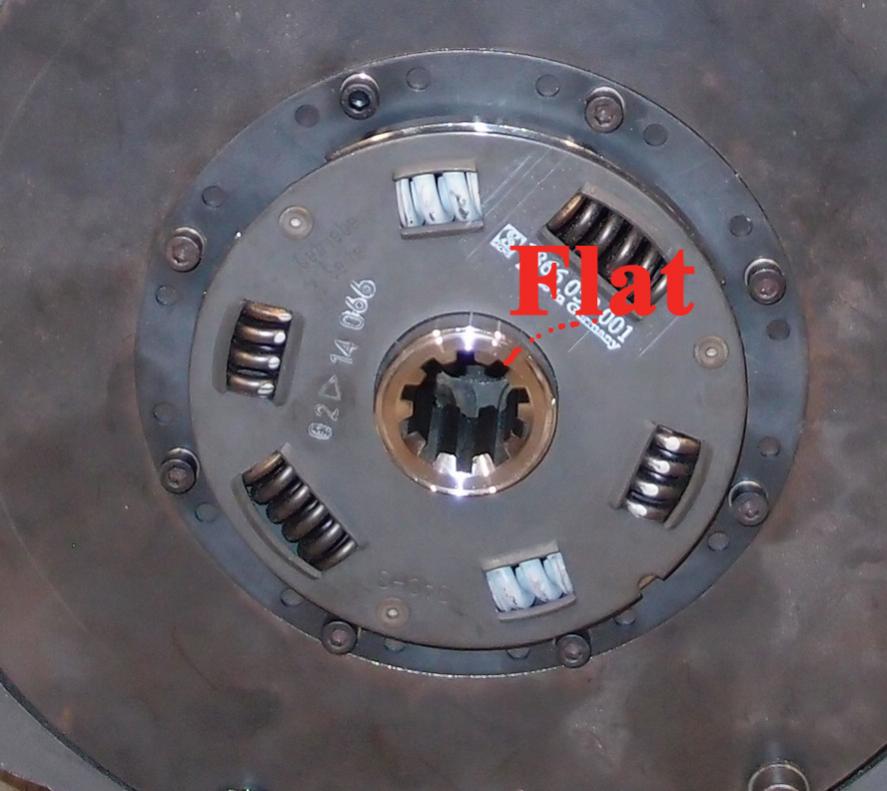

Thank you for your input. This evening, I removed the bell housing and the noise went away. I narrowed it down to the new damper plate. I put the old damper plate on and there is no noise. The new damper plate seems to fit, but I noticed that, with the new damper plate, I cannot put the bell housing on all the way and have to use the bolts to close the last 3/16" gap between mating surfaces.
With the old damper plate, I can push the mating surfaces of the bell housing and the engine up tight without needing bolts to close the gap.
I'm not sure what the deal is with the new damper plate, but there is something different.
Is there a break-in period for damper plates?
I added pictures of the damper plate:
http://www.bodylens.com/engine
Thanks again.
33,073
8,489
Ok, then yes that was forcing the crank into the trust bearing.
Can you give me a picture of the new damper plate bolted on it at the same angle as your second "old damper photo"?
Also if you have them both off slide them on the output shaft and make sure they go all the way on.
The other things would be to check direction of the plate and triple check dimensions and offsets.

I removed the housing and compared the distance that they travel and the new one bottoms out about thick 1/16" before the old one.
In other words, the new one travels down the spline ~0.48" and the old one travels down ~0.53". That's a approximate difference, errors exist in cheap calipers and the fact that I gently slid each plate down the shaft until I felt slight resistance. If I pushed to hard, the metal would bind and make it very difficult to remove.
I then compared the part of the damper plate that bottoms out on the gearbox end and saw that the old one appears to have been modified slightly. The face of the damper plate spline ( the collar that has the grooves in it that mate with the gearbox input shaft) is flat on the new plate, but the old one is concave. Looks like someone took a large countesink and machined out a slightly concave shape, allowing that old plate to travel farther down the gearbox input shaft.
Not sure if this concave shape is part of that design of that old plate or a modification. Either way, I'm going to have a machine shop countersink the new one a bit so it will travel all the way down as far as the old one.

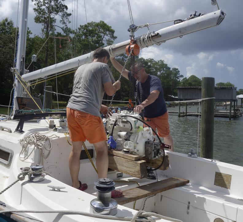

Well, it's been more than a few weeks, but the engine is finally in.
Thank ya'll very much for answering my questions during this engine rebuild. I knew nothing about engines when I started this last winter, except that diesel's have no spark plugs.
The engine is in the boat, aligned with the v-drive, v-drive aligned with the propeller shaft flange and it runs!
Damper Plate issue: I checked 10 damper plates for warp ad they all had 1mm - 2mm warp; none of them was perfectly flat.
I worked around this problem by drilling/tapping a hole in the bell housing for a 3/8" NTP plug (9/16" dia hole). I then loosely fastened the damper plate to the flywheel and bolted the bell housing to the engine. No binding.
Now, I used a long allen wrench, stuck through the 9/16" hole and tightened the bolts, rotating until the next bolt was in view through the hole.
Engine started within 30 seconds on first try; I was really surprised.
Anyway, here two pictures, as well as a link to more, for those who are interested.
Thanks again for all your help.
http://bodylens.com/Gallery
