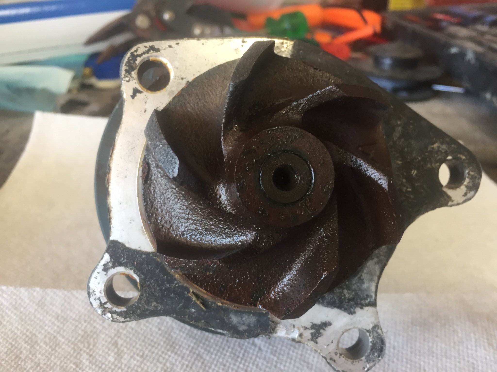

The Coleman Equipment price on their website is $191 so $170 cheaper than my local dealer.
Kinda stupid for them because I would support them (local dealer) if I could but that price is not even close. I got new top and bottom hoses as well as a new fan belt for $100 cheaper; even after paying $20 for shipping.
WIN WIN for me and Coleman, hard to support a local business who could order from Coleman and make a killin on resell...
OEM: the pump I took off had tapered (rounded) impeller blades the new one has square impeller blades. When dry fit it does turn freely in the engine block so no issues I can see just a different design. The pump I took off the main bearing was toast!!
FYI, The gasket is not included (additional $6)

I will add a few pictures so you can see what I have both for install and removed. For all I know the pump removed is not OEM... I can say Coleman has a new customer as they were excellent in all regards.

Here are the pictures from the water pump replacement I completed today. The top picturte is the old pump bottom is the new Coleman pump. They are 100% different impellers but both turn freely in the water pump housing so all good for now...
^^removed water pump
^^replacement water pump
