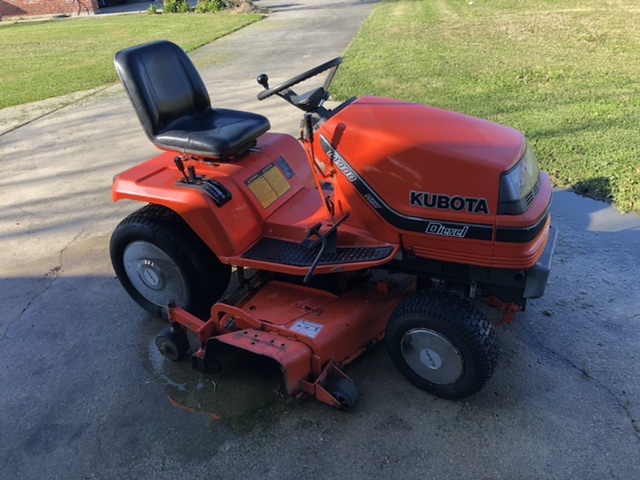

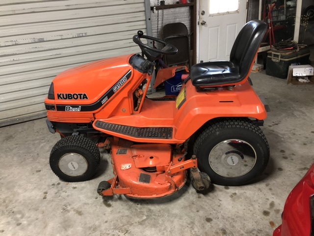

Here’s an update, but first, Thank you all for the Welcome. I appreciate that as well as the keen insight.
I bought the unit! I got it for $1300. Turns out, not only did he keep records, but he maintained too. See photos. And everything you might want replaced was. The PTO shaft, starter, fluids and filters, including HST were replaced as well as the gearbox spindles and belt on mower deck. I could barely see the fluid for the HST it was so clean.
The unit is surprisingly powerful and fast! The HST does whine some and reverse requires that a really step on it. Is there an adjustment? or maybe im not used to the pedal.
BUT it doesn’t start with regularity. Seems to be safety switch or maybe a fuel shut off solenoid, im guessing. Suddenly just doesn’t start, then it does. Ideas??
It also is bogging down after a short period. The air filter was very dirty. I cleaned with compressed air, which helped, but didn’t fix. a new one is on the way. I welcome input. Thanks in advance!
And i saw above to use a Kubota filter — is that a Kubota OIL filter or HST or both? Ive see this filter on Amazon for $15. is this lesser quality or the real deal? Apparently i cant post link, but the this is part #:Kubota OEM Oil Filter HH150-32430
Really appreciate the assistance!
