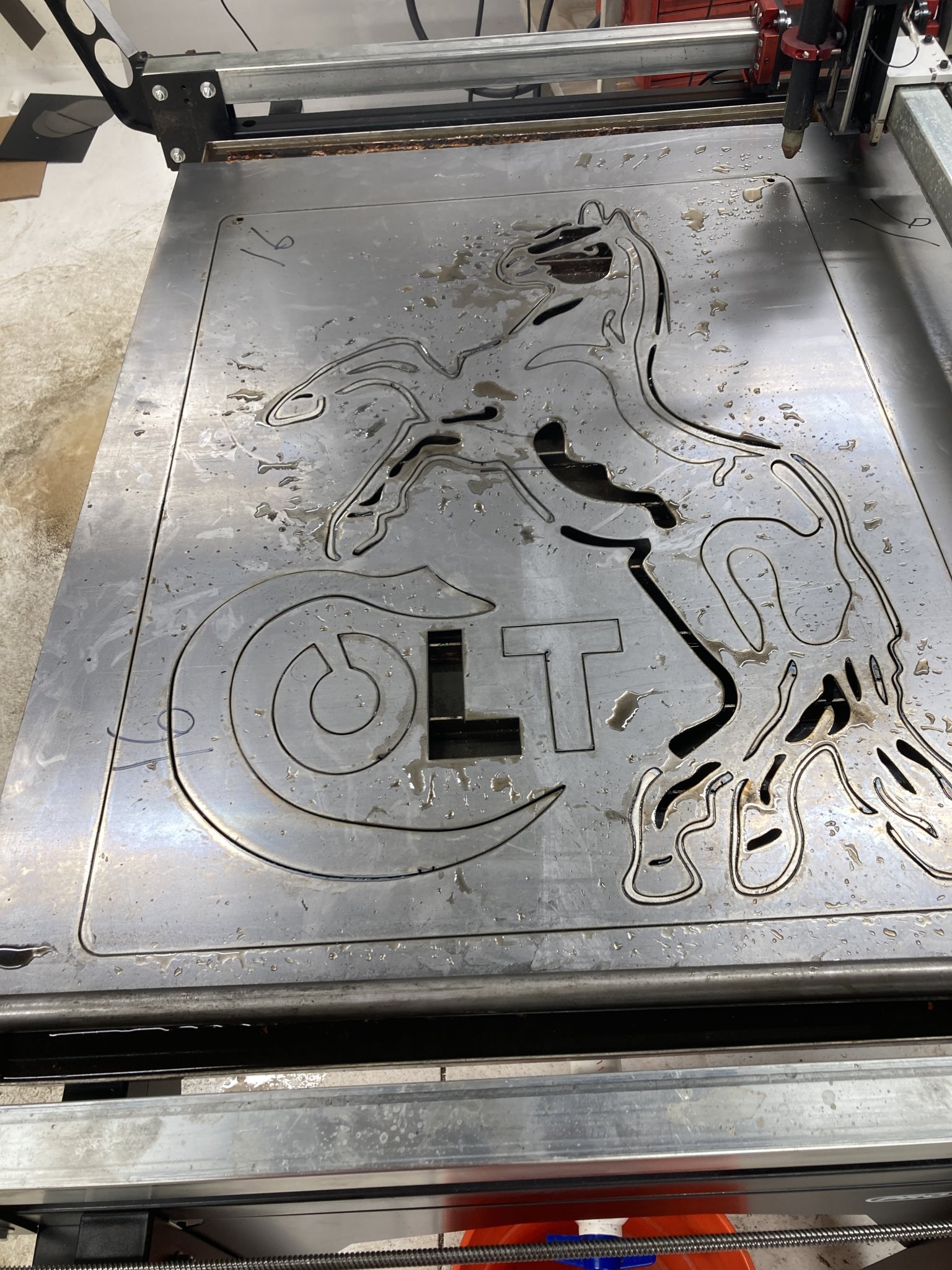

Well my "metal sign" skills are getting better, (not great, just "better") and I am at the point where I would like to start painting them.
I "transformed" my old "gaming room" into a makeshift spray booth with a homemade "spray rack".
I was using rattle cans, but the results are not very good, so I decided to buy an "El Cheapo" HVLP spray gun to try and "up my game"
Anyone have some advice on what types/brands of paint to use/begin with?

RWS You did an awesome job on that Colt sign. I've never attempted anything like that but it sure looks great. As far as paint goes Rustoleum is all I use on anything ferrous.
Thanks for the kind words.
It was/is the most challenging sign that I have attempted so far.
It took quite a while to draw it on the computer, but I am happy with the result.
