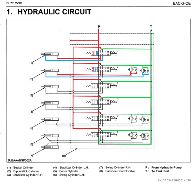

Please take a look at the hyd. diagram for the BH77 control valve and report back. Hint it is a parallel circuit.
I have drawn up how oil would flow using stick and bucket in at the same time.
9,225
4,813
I have drawn up how oil would flow using stick and bucket in at the same time. View attachment 63009
Thank you for the schematic. All spools are parallel with port reliefs on boom, dipperstick and swing cylinders. There is no inlet relief or separate high pressure carry over (PB) circuit. Downstream valves if any are fed by tank core which you have highlighted in green. Agreed?
