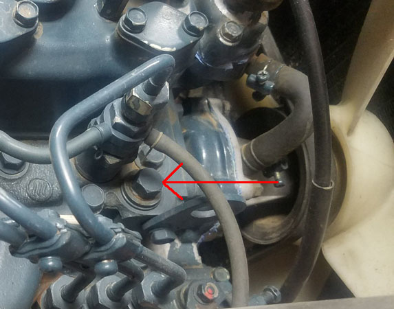

There is indeed a bolt on the top of the head that is a cooling passage plug. I forget the size, but that's what I used on my 7200. Kinda hard to see in the pic. My runs consistently at 160 deg F.

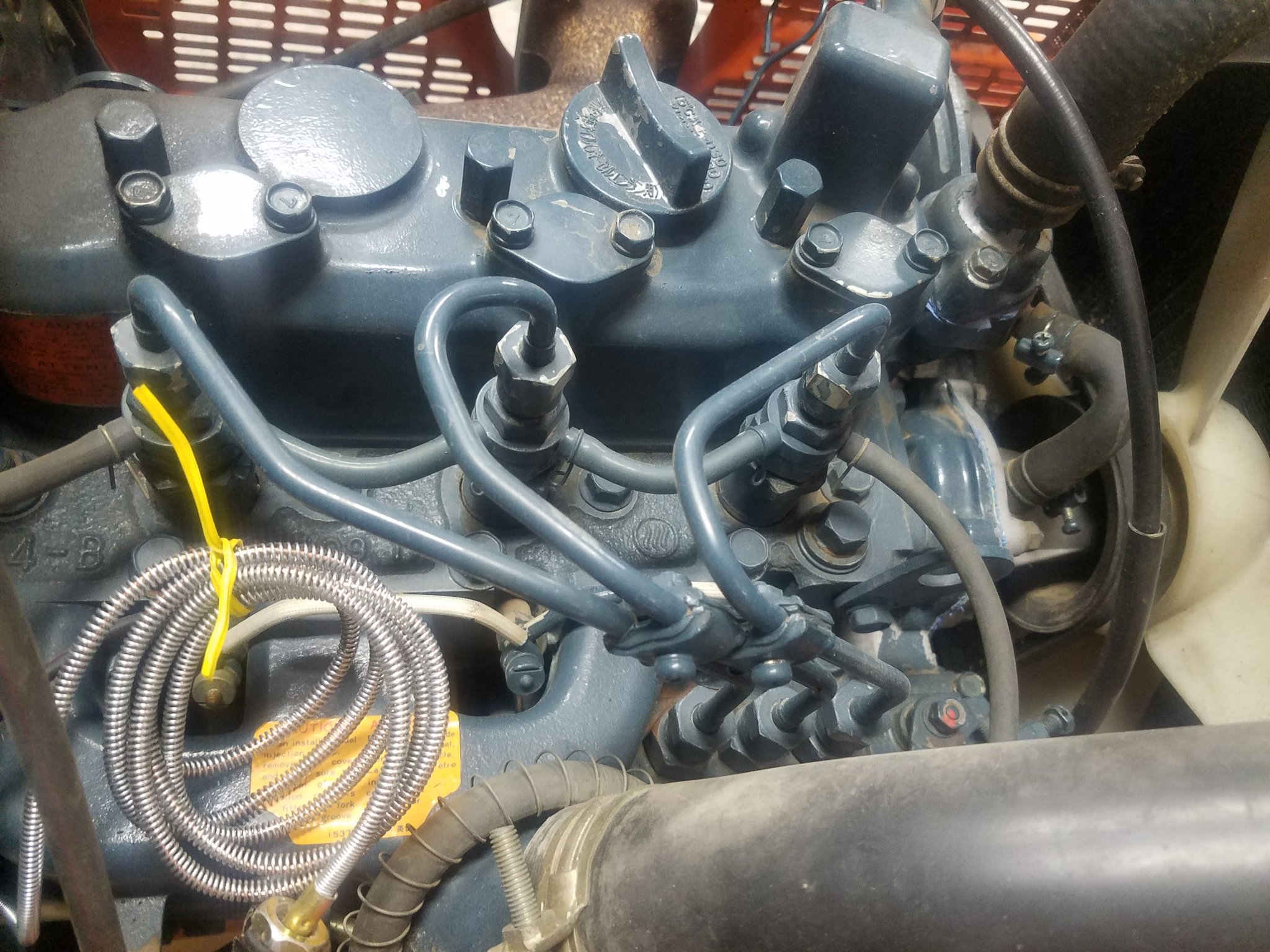

You must of added a different alternator. Here is a picture of my engine with the bolt or plug that I think you are talking about. I couldn't figure out how to put a arrow on the picture like you did. it is just to the right of the front injector, between the two head bolts. Is it pipe threads? Did yours come out hard? I don't want to mess up the head. Thanks

Bob, Yes I did convert from a dynamo to alternator. Just so there is no confusion, I put an arrow at the bolt. Mine came out just fine. I found my old one. It's a M16X1.5. What I had to do was get an M16X1.5 to 1/8NPT sensor adapter fitting since my autometer gauge used a 1/8npt sensor. The setup works great and hasn't leaked at all.

Thanks a lot for your help. I've been eyeing that plug as a possible location. I pulled it this morning. Came out pretty easy. It is different threads. Where did you come up with that M16X1.5 to 1/8NPT adapter? They are great tractors. I build a 4' land plane out of 12" H bean that is just about to much for the poor thing. These hot days using that land plane has me worry at times about the temp of radiator. I have a 60" woods finish mower I used all the time to mow my yard and two other neighbors yards. Both of them have some steep slopes to them that I have to go straight up and down and without 4wd I wouldn't be able to do it. Thanks alot for your help.
