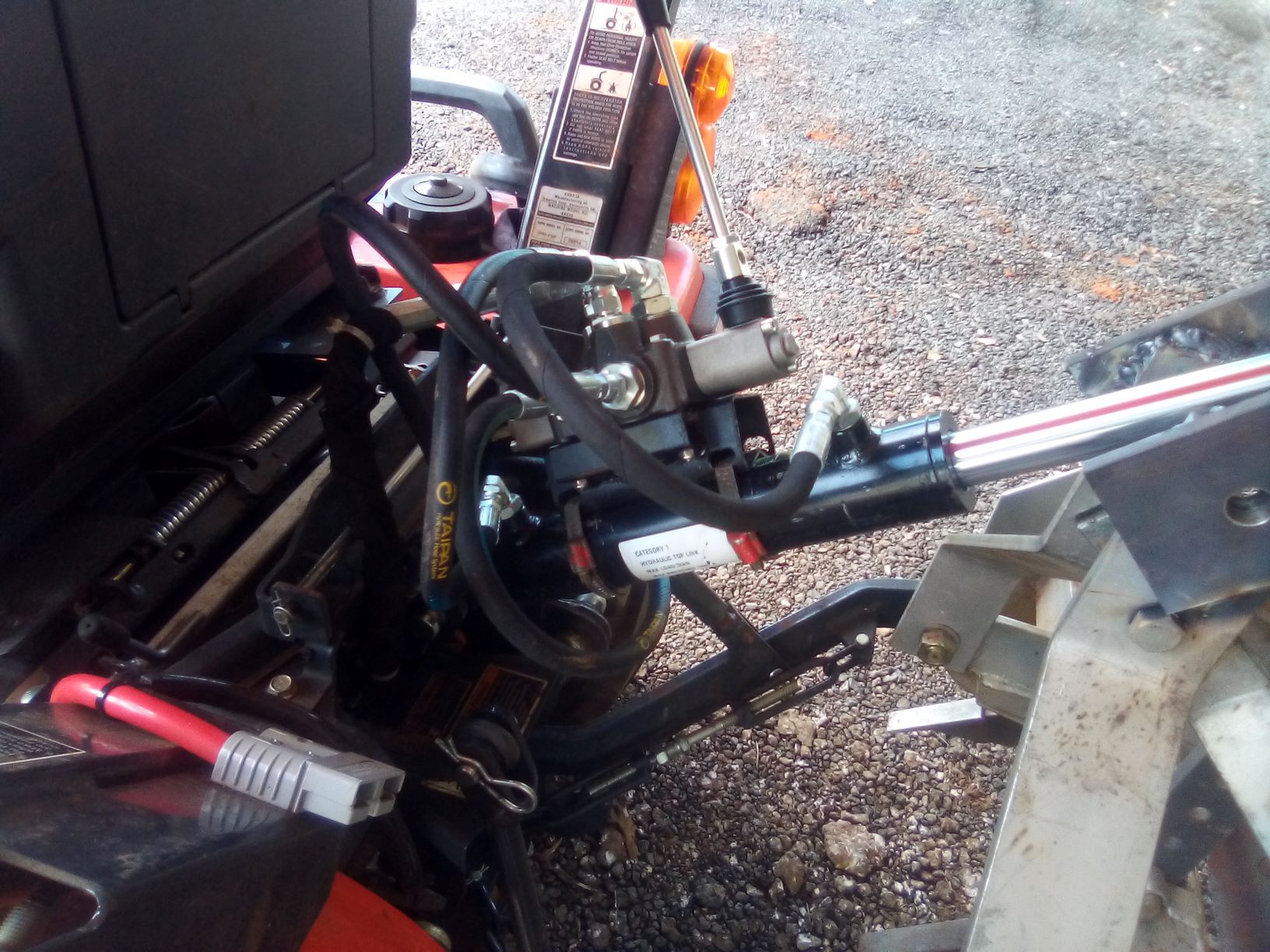

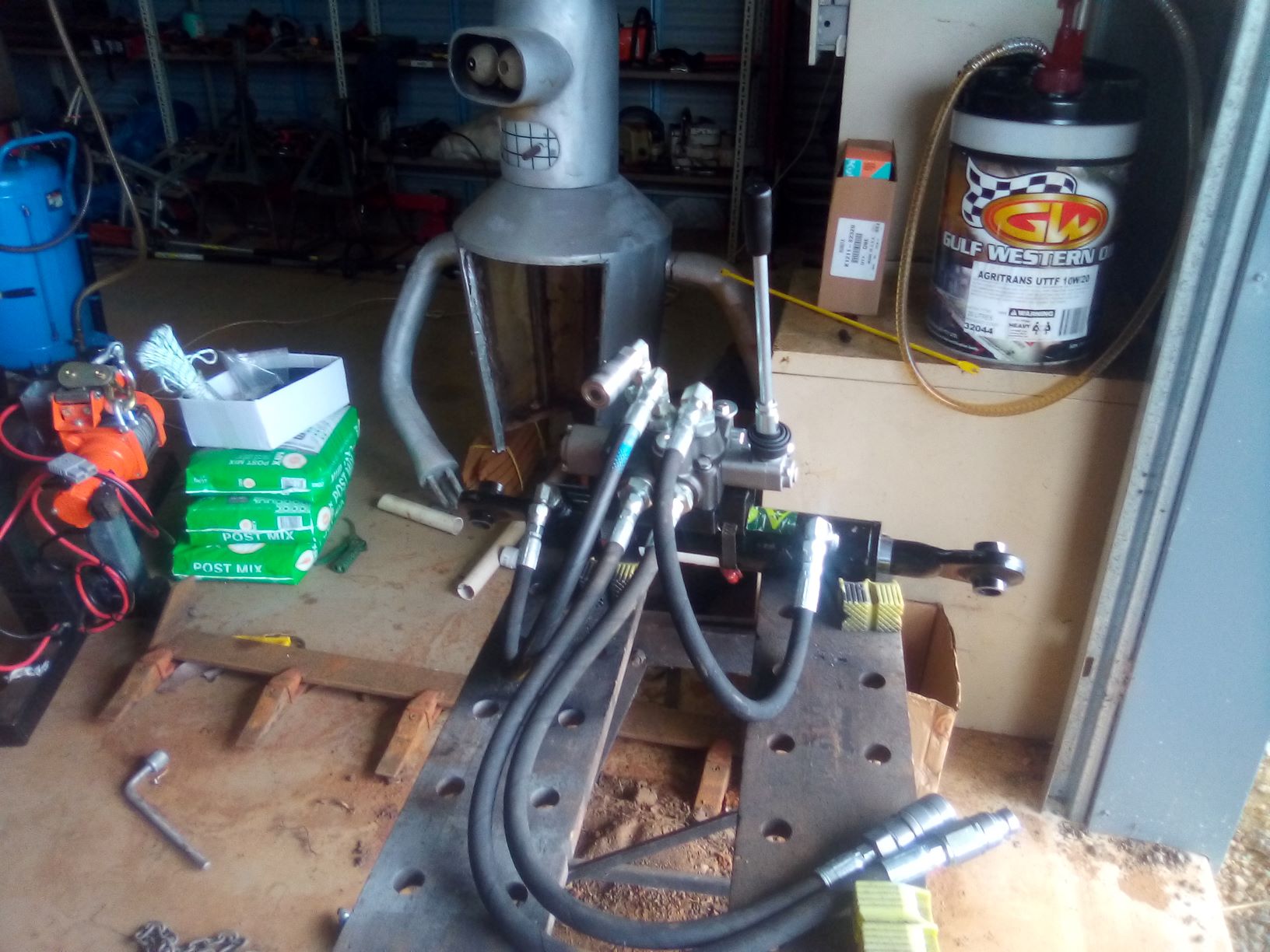

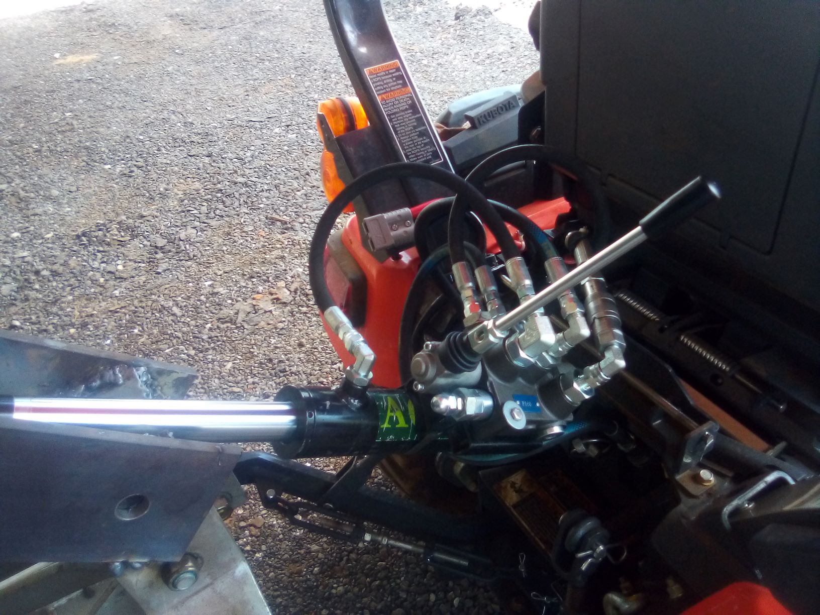

For MY BX23S-au I decided the kit was to expensive for what it was. Also had to make new coupler mounts and and hoses to fit it.
As I dont need the tilt, just the top link, I mounted the valve on the top link and just plugged into the 3 outlets for the backhoe.

Here in OZ the kit for the BX2380 was $1800aud.
I only use the top link when I have the box blade on which is not that often. I find it too much hassle to fit the box blade. Mainly in the time needed to install the 3PL kit after removing the the BH. Added to that I only need the box blade for the rippers as the 4in1 bucket does everything else the box blade can do.
That being said $300usd ($420Aud) for a valve and hose, overpriced in my opinion. I paid $130Aud ($96Usd) for the valve lines and fittings, for me a much better option.
You are right about modifying the kit but it is not the backhoe frame that is the issue for fitting the BX2380 kit on the BX23s. The issue is the ROPS mount and Couplers interfere with swivelling the seat.
You can reverse the mount to put it on the outside of the ROPS but the hard lines need to me remade as they are no longer long enough. The easier option is to have some flexible lines made to suit.
I'm not sure about the US version of the BX23s as we get the BX23S-AU but the backhoe frame support is no issue for us. As I understand it the only real difference in the 2 models is we get the Kubota (not land pride) 4in1 bucket standard
View attachment 49356 View attachment 49357 View attachment 49358
Hello 34by151, do you have details on exactly which valve you bought and how they are hooked up to the hoses for the backhoe? I would like to do the same thing as you have done here. Thanks!
