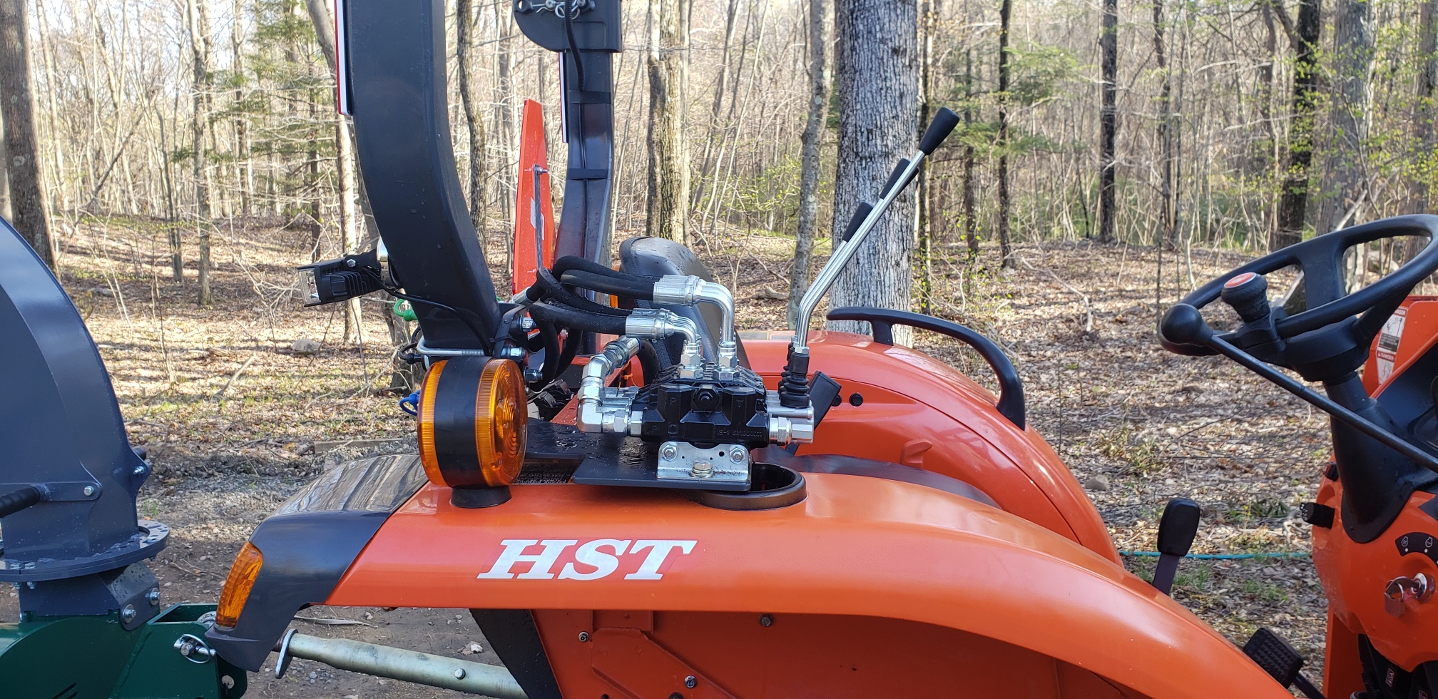

The OEM controls are tucked in tight between the seat and fender.
I'm not sure that down and back or even down is ergonomic for me. But ergonomics varies from person to person.
The control levers in the picture can be as pictured (obviously) or forward. Either way, the operator is not reaching backwards to be able to control the valves.

That's a decent looking setup but I'd have to try it to see if it's ergonomic.

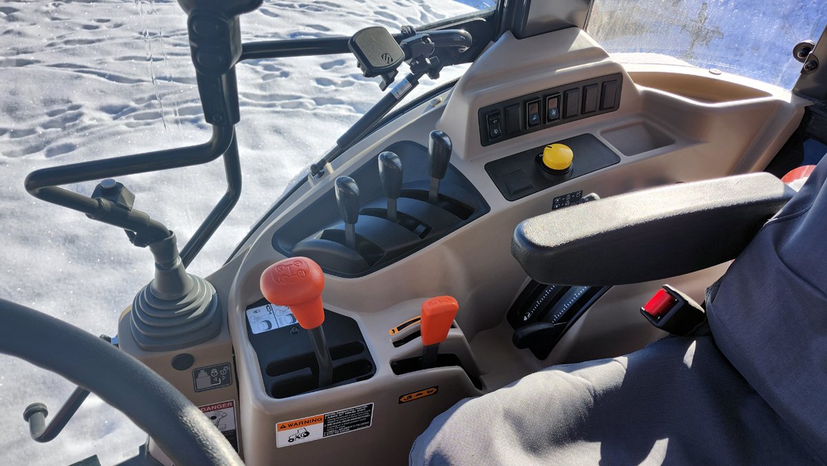

It's only through comparison that we figure out what works best. We can get used to just about anything, but it's only when we try something better that we appreciate the difference. For example, the controls in the M6060 are way, way, way better than than the controls in the MX. I am acutely aware of the difference when I go back and forth between the two tractors.
If the MX controls were like the L60 controls I think that MX would be a near perfect tractor. It's not a deal breaker, and we learn to live with what we have, but if there was a kit available to move the rear remote controls to a location similar to the M6060 I'd be all over that. I really don't care about any of the other features in the L60 tractors and have no need of them, but I do prefer the controls and how they're arranged.

I haven't spent much time in the larger M tractors, but yes, the layout in the M6060 is about as good as it gets for old school type tractors. I really like the location of the rear remote levers and everything works in a smooth and repeatable manner.
Nice setup pictured.
You build it or is that a kit?
I like that location as normally when operating rear remotes you're side seated looking back.
Any issue resting your arm on the hot hydraulic lines?
