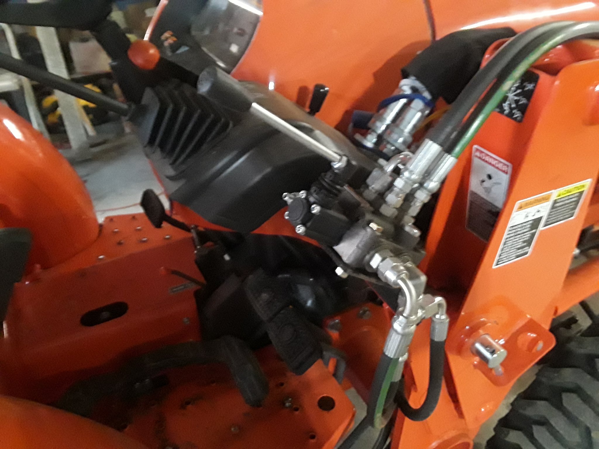

I have a 2011 L3200 HST. Already added a third function kit for front. Question is is there an all-inclusive kit to add hydraulics to the rear?
I’m in the same boat as you. I added a Summit Hydraulics 3rd Function valve myself after a couple years and now want to add remotes. I had to deviate from the original instructions that came with the Summit kit in order to account for my BH77 backhoe, but everything is working great with that configuration.

Its also possible to add your own valve for less than the price of the Tractor Innovations kit and get the same functionality as the Kubota valves. Here is a single spool valve I put on my loader - probably less than $400 for everything needed.

I really like this installation. It's exactly what i want to do for my 3rd function. I'm new here, so excuse me if i'm beating a dead horse. a couple questions; Is that valve a regular closed center valve, or is it plumbed into power beyond? Do you happen to have the part #?
10,811
5,923
The tractor is open center so everything on it is open center. The valve is simply daisy chained off the loader valve. Adding a single spool with 3rd function outlets is less than $300.
TheMighty1
MX5800
Oct 25, 2024
Arkansas
