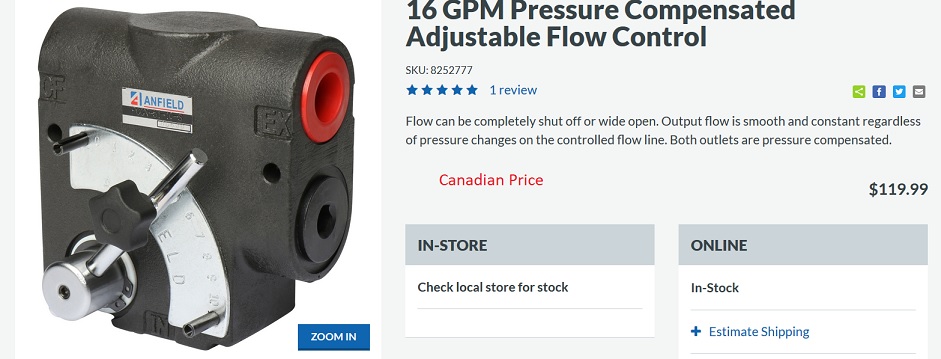

The easier route is to install a pressure compensated flow control as the lane cutter is likely getting too much flow and tripping the detent.
I use one for my Samurai Sickle mower which attaches to my FEL bucket.
When you get the flow under control, then the valve will stay in its detent.
The control installs in the supply to the cutter motor and the exhaust just Tee's into the return from the cutter.
Dave
