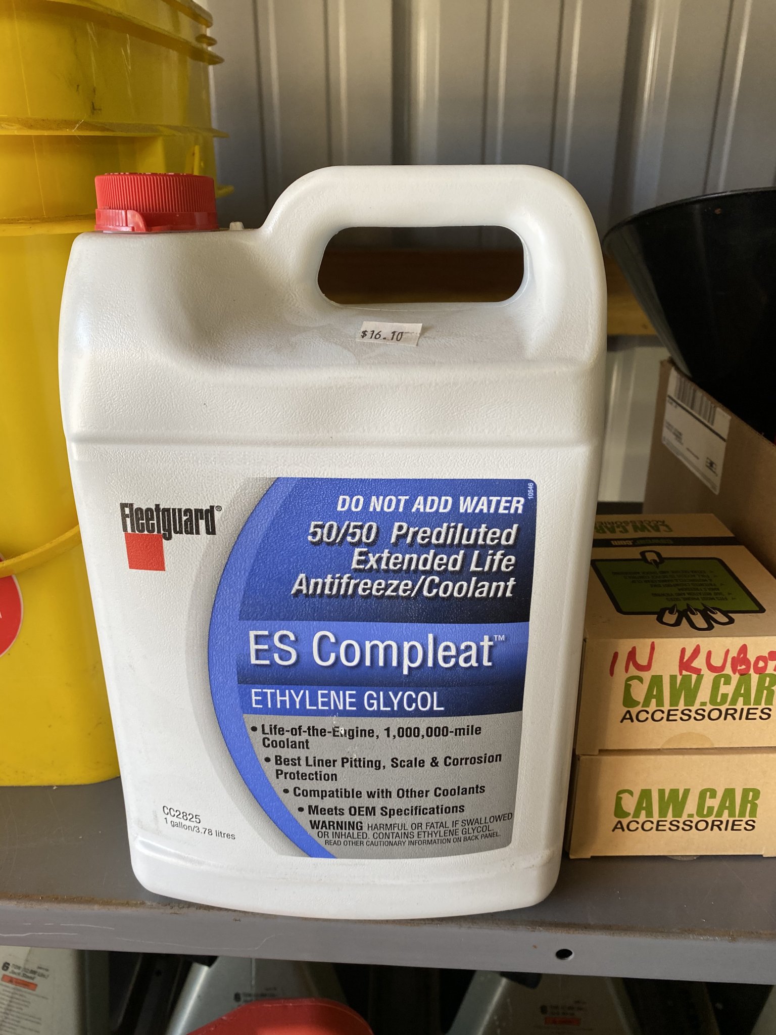

Premix coolant from dealer. I can take a pic if you want.

This is what my local dealer carries.
